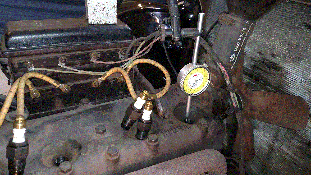

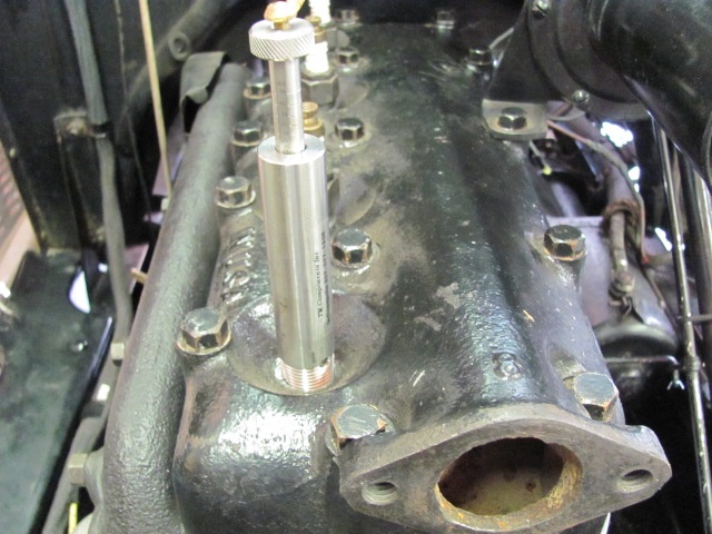

Re: Timing degrees after top dead center ??

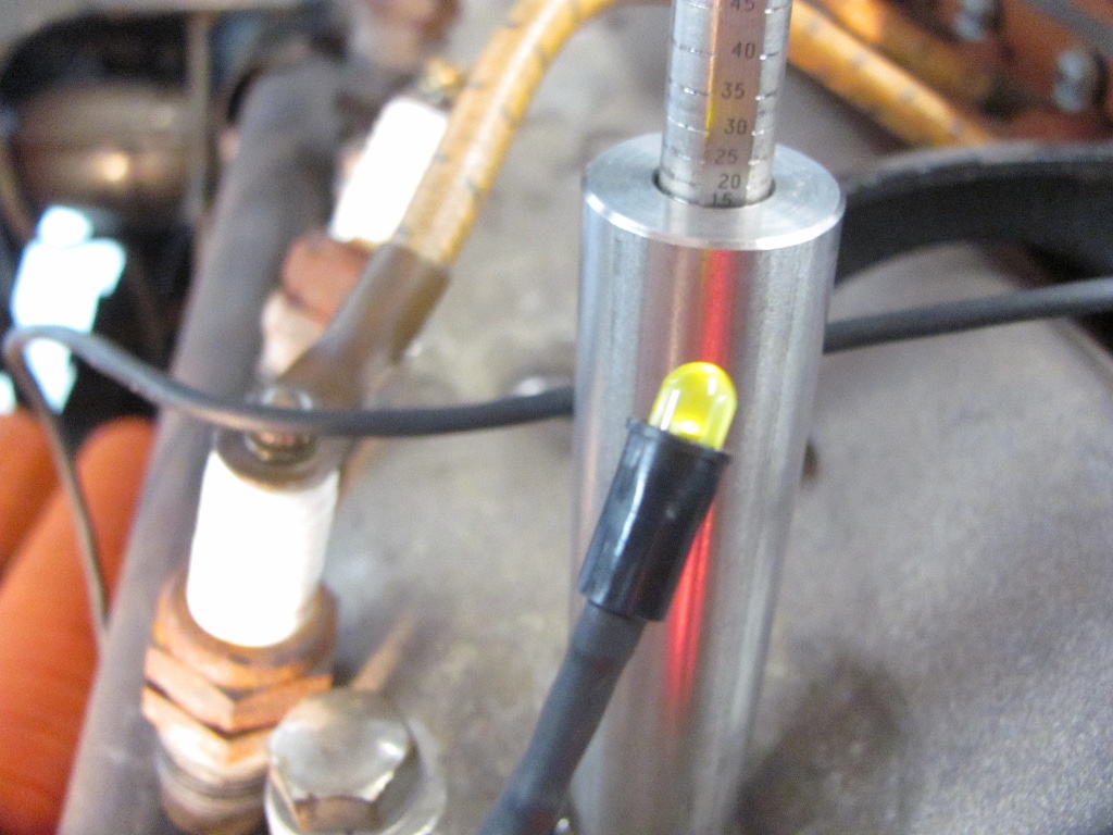

Yep, 15 degrees ATDC on the compression stroke of cylinder.
I like to use the handy tool for measuring, it has a hole at the base so you can hear air hissing out on that stoke on # 1. So you know you are on the right stroke. Then crank over a bit more to get 15 degrees ATDC.

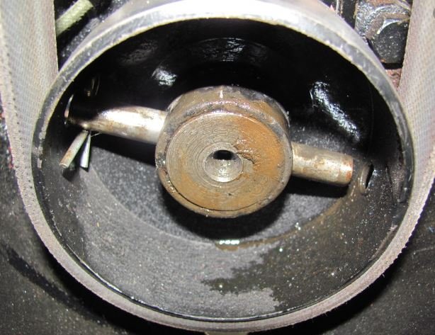

As for the crank pin hole, all T cranks are the same. If that pin hole is horizontal, two of the pistons are at TDC. But you set timing on the compression stroke.
Here is pic from forum a while ago, the next to the last crank on the right is a EE, the far right is the diamond throw crank, note the pin holes are identical .

1. Turn crank shaft around until crank pin is horizontal

Dan, Question- What is, looks like brass, on top off the knurled piece?

- Posts: 4107
John
That's the round head brass screw top of the screw used to move the marker sleeve up and down. The end of that screw is right angled to rest on the piston, the wing end tells you that it is in position, since you have to screw the tool into plug hole, so the piston drives the marker up and down as you hand crank over the engine.
TW Timer Tool

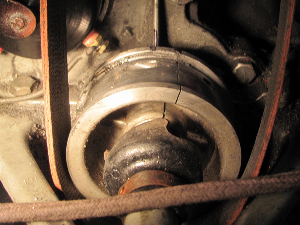

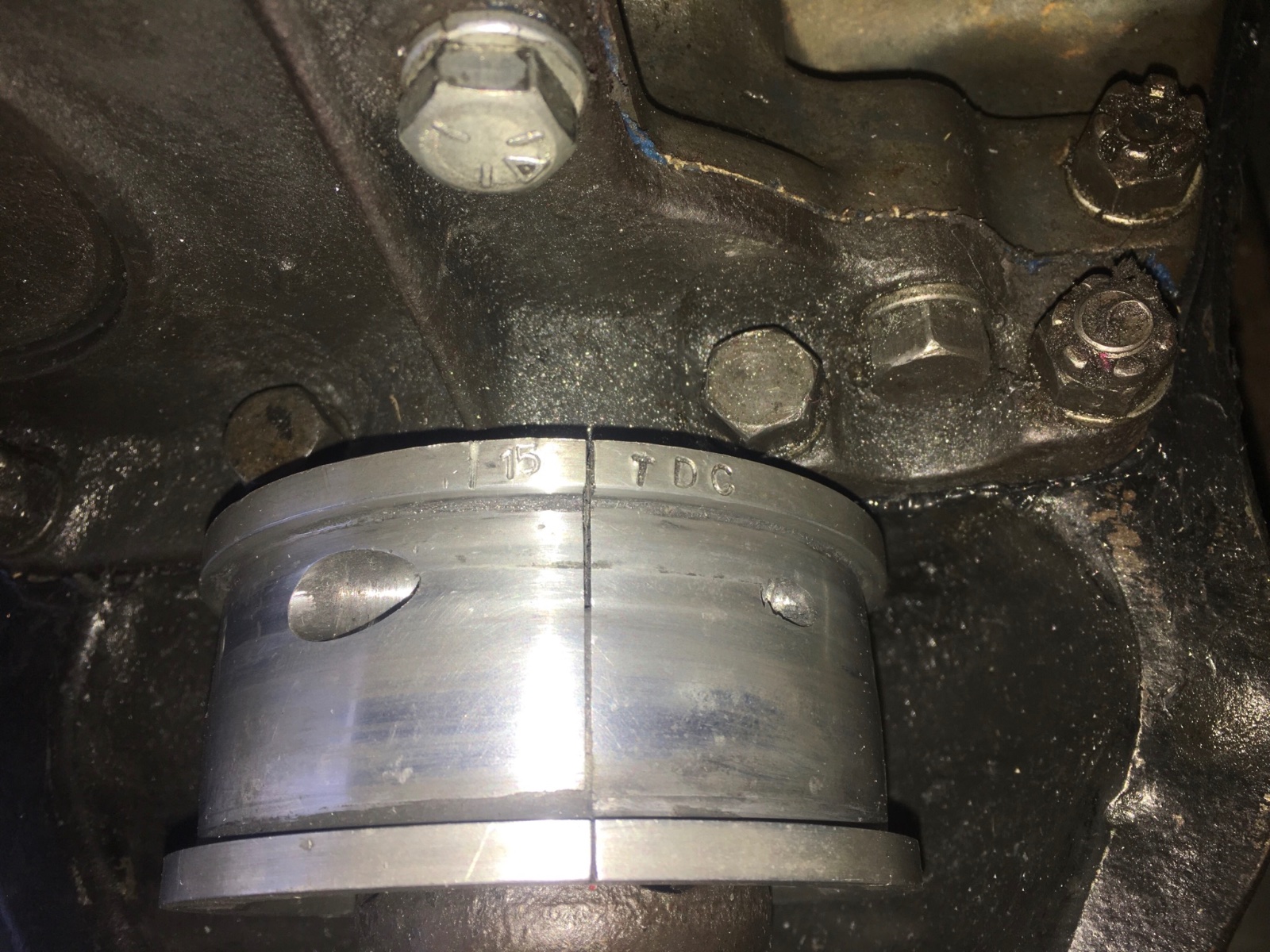

And use it with indicator lamp wired to # 1 coil post, (not the plug wire post!) and that lamp lites just as you reach the timing mark 15 degrees, since the rotor in the timer is just contacting # 1 timer terminal. Helps you really dial in the ATDC spot by using piston travel.
For showing too that the clock face look of your crank pulley pin works, you can see it rests at the proper spot.
Hint: If you use Dan M.'s alum flanged split pulley, the slit is right dead center of the horizontal crank pulley pin.
You may see my black ink marker spot on the slit and the timing cover parting line, I marked black ink on that too. When they were lined up, the timing tool showed exactly TDC! So you can see where another ink mark on the pulley is made at the correct 15 degrees ATDC.
Have always checked my timer and timer rod setting (bends) with timing tool indicator and lamp, confirming too the useful 9:15am and 3:15pm clock face method.

If the piston has been correctly set at 15.5 degrees ATDC it will have traveled .093 thousandths down into the cylinder on the Power stroke.
Ron Patterson

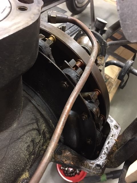

Quickm007
- Posts: 1202
- First Name: Mario
- Last Name: Brossard
Hi Ron,

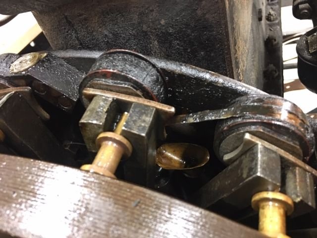

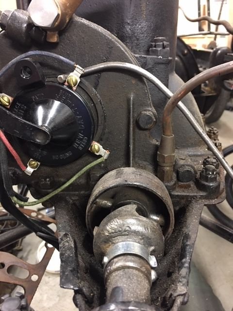

I did the 15.5 degrees ATDC. I opened up the engine top and here bellow pictures showing at 15.5 degrees ATDC at valves and the first piston. Please let me know if that make sense or I'm the left field? I want to learn .

- Posts: 2550
- Last Name: Strange
- Location: Hillsboro, MO
- Board Member Since: 2013
Look right to me, well done!
Now make sure that the timing lever on the steering column is fully up, and adjust the timing rod length (by bending as required) so that the end slips into the timer arm without disturbing its position.
Then, have a helper move the timing lever through its full range and verify that the timing rod doesn't touch and short out any of the timer terminals.
Also make sure that the timer terminals don't brush up and short out against the two nearest front oil pan bolts. Most folks install those front pan bolts opposite from the rest so that the nuts face down towards the ground and the heads point up. This gives a little more clearance for the timer terminals to pass by without hitting those bolts.
Once you have things set the way you want them, install your fan and belt and make sure that the belt doesn't rub on the timer. If it does, it will eventually wear a groove in the timer. To fix it, try different length belts until everything clears.

Technically, the .093 varies with connecting rod clearances but not much. The .093 dimension is for a stock 4" stroke and 7" connecting rod length. Changing either of those will change the amount of piston travel ATDC. When a crank is rotated 15.5 degrees ATDC the rod journal travels down .0727". That pulls the rod big end down by that amount and also rotates the rod 4.38 degrees from vertical. The piston can only move down and rod rotation adds .0204" to total piston travel. Add those to get .093".
I made an offset tip for a dial indicator that looks like the tool in Dan's post. I used that to find 15.5 degrees.
Last time I had my engine out I marked TDC, 15 degrees after TDC, BDC and 15 degrees after BDC on the aluminum pulley (TTP after market I think). So to find 15 ATDC I just turn the engine until the 15 mark lines up with the cast boss I use as a degree wheel pointer.
Note in Steve's photo how his front pan bolts are installed upside down from the rest to provide more clearance for the timer terminals.
