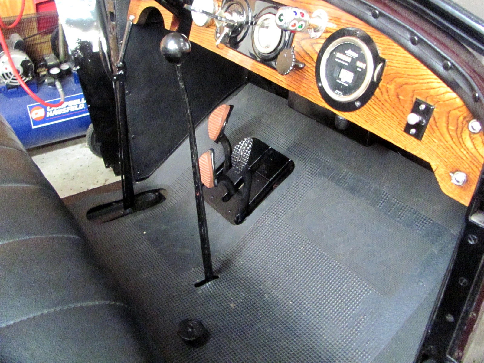

I am using a rubber touring floor mat in the front of my 27 Tudor. It only required a small amount of trimming on the outer edges and around the seat legs. Much more practical than carpet for a car that I drive a lot.

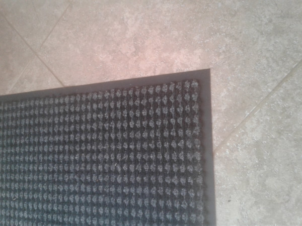

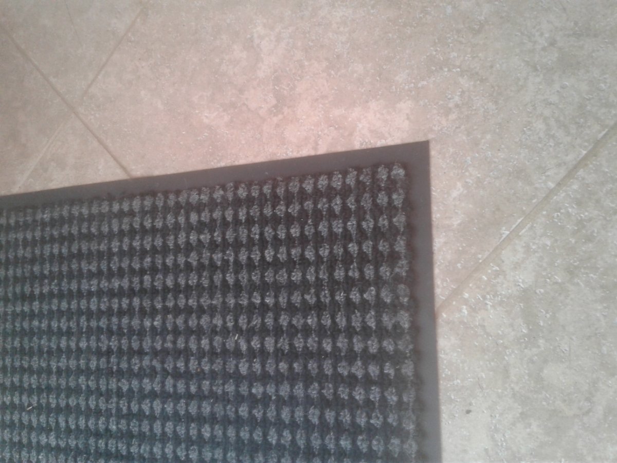

Home Depot type stores have "walk off" mats, the type you would put inside your back door, so your wet shoes don't track up your house. This one is a low nap carpet on a thick rubber backing:
They are cheap, can be cut to fit front or back, and can be removed and hosed off to clean. Your store may have something similar in solid rubber or vinyl.
