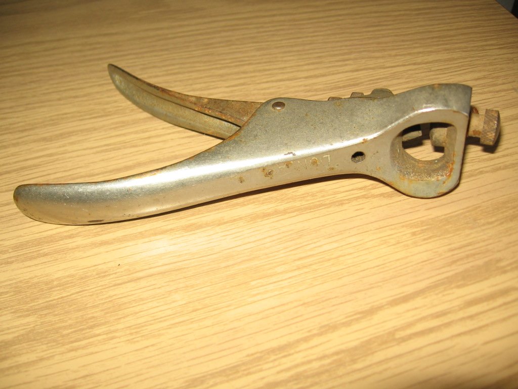

I picked up a bucket of old tools cheap at a garage sale, and this tool was in the bucket, does anybody know what it is?
Originally, I thought it was some kind of nut splitter, but the end of the plunger has a triangular cross section, not a wedge like a nut splitter would have.
Thanks! :)

Snap installer ??

Its a saw set tool. Bends the teeth after sharpening.

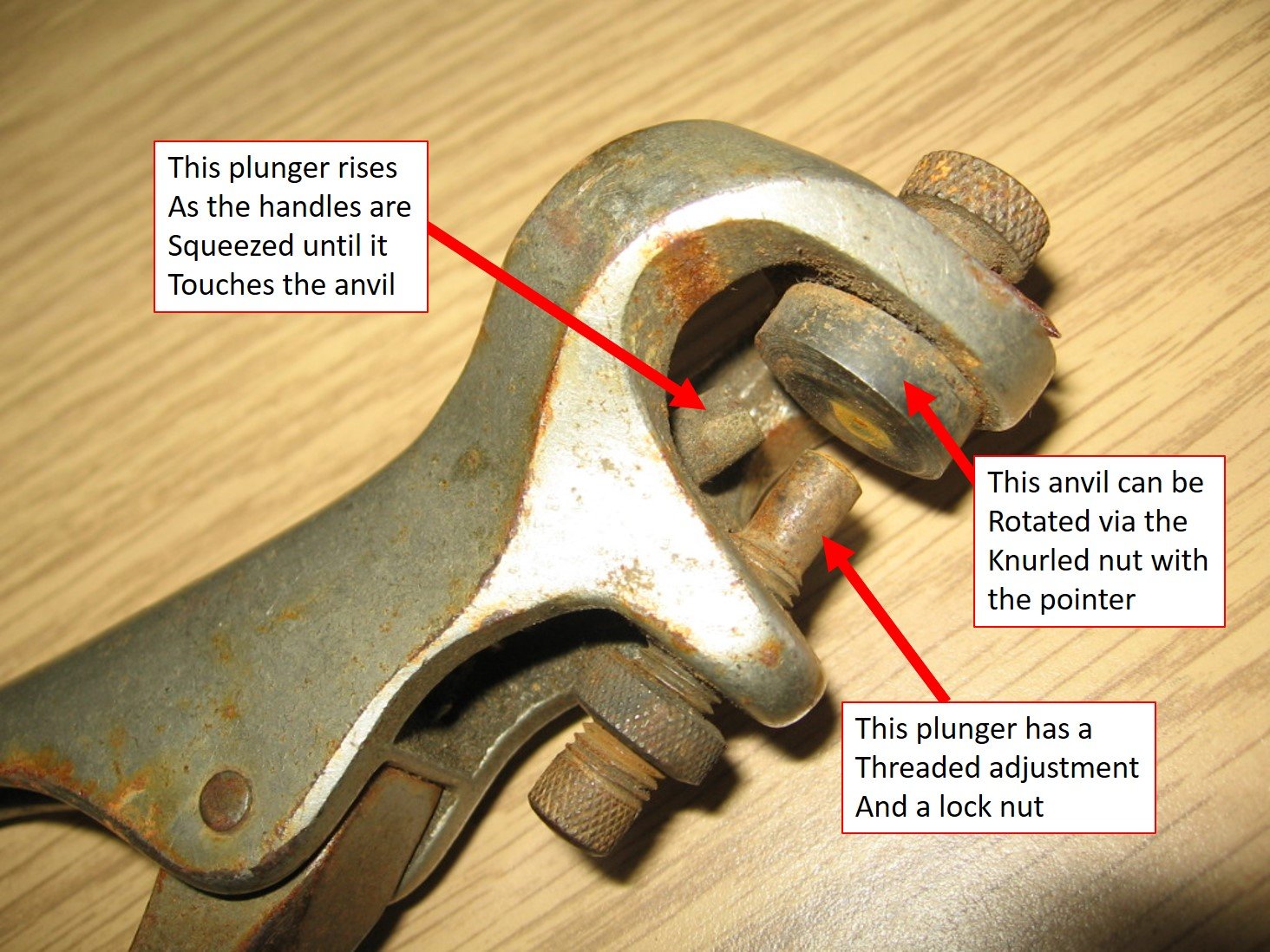

Thank you Jim, that makes perfect sense! The base of the anvil is cut at an angle that can be adjusted by turning the dial. The thread adjustable plunger allows the tool to be clamped on the saw blade, then you squeeze the handle to bend each tooth to the angle set by the anvil.
Very tedious but effective! Looks like it's a keeper. :)

If that is a saw set, it must be for a saw with mighty big teeth. Otherwise adjacent teeth to the one being set will also be bent due to the width of the anvil. I'm more inclined to go withDave's 'snap installer'.
Most saw sets have a stationary anvil against which the tooth is bent. The anvil is set to limit the bend and angle the tooth. This tool does not.

Saw setter, the amount of 'set' is adjusted by dialing in the distance of the blade relative to the setter by moving the anvil closer or farther away from the setter and adjusting the other dial to the thickness of the blade. This is one for heavy sawblades as in a sawmill.

Allan, on closer inspection, the angle on the 'anvil' is not concentric, so turning it give you different angles. problem solved !
