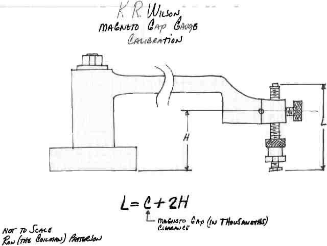

So in Ron’s drawing below, C= some value between .025-.040? Just pick one?
Posts: 7411
Re: Quick info check
Post by Steve Jelf » Tue Apr 21, 2020 8:45 am
I would go with .025". You want to make that the gap of the highest keepers, then add shims to bring the lower ones up to within .002" or .003" of that. Actually I think the effect of a variation in keeper height of up to .005" would be negligible.
