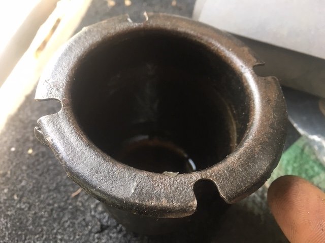

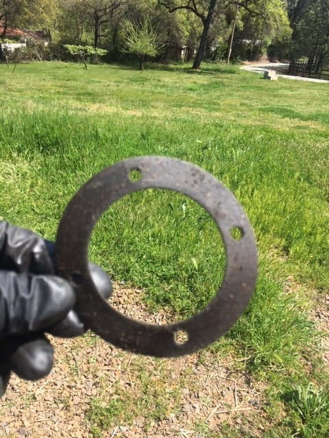

After installing my engine with repairs completed I discovered a good size oil leak from the area of the Bendix cover. I looked around and found the old gasket in my discard pile... I couldn't have installed the cover without a gasket, could I? with a quick glance I could confirm that I used a new gasket from my gasket set purchase.
Bendix cover gasket
Bendix cover gasket
Hmm, what is going on? I removed the cover and gasket and measured. New gasket is .013" thick. Old gasket is .037" thick. The old gasket is twice as thick as the new one!
Bendix cover
Bendix cover
I placed the cover itself on a flat plane (sort of... my vice anvil and then the garage floor, I didn't want to get grease on my table saw table) and found that the cover wasn't completely flat. There were some tiny bends in it. So using a flat ended punch. ball peen hammer and vice anvil I worked the flange much flatter.
The next step was to clean the mating surfaces and gaskets with acetone and take the new and old gaskets and past them together with RTV sealant. More RTV on the cover and hogshead and re-install. I won't be starting it up for a while, but it never leaked before the gasket swap so I don't expect it to leak now.
I thought a heads up about the new gaskets might be in order. I suspect I could have gotten away with flattening the cover and using the new gasket without sealant... but I am a sort of belt and suspenders type of guy!

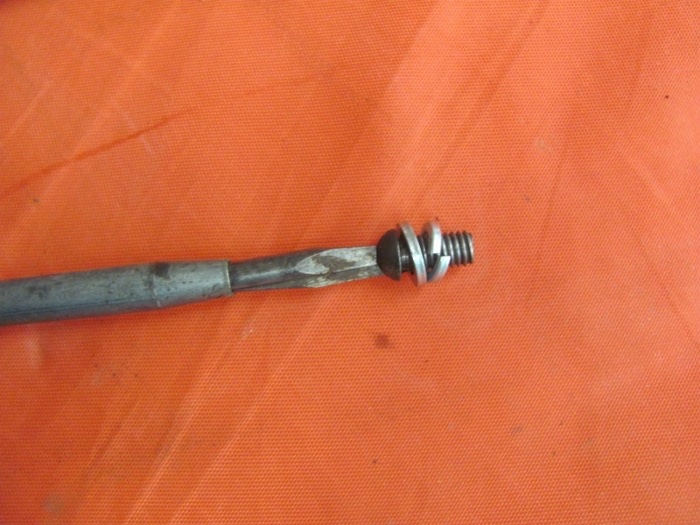

That should work, new gasket with a decent gasket cement.
Do place the lock washers on those little machine screws too, you don't want a screw to back out and start the seeps all over again!
Like to add a small metric plain washer to the stack, to seal the gap of the lock washer , and the plain washer fits snug in the flange of the later Bendix covers with the rolled up edge.

Yikes, I haven't used lock washers on these in.... well ever! I wish I had seen this a few hours ago, I would have put lockers in there, a plain good idea. Access to the Bendix \screws is a bit difficult with the pedals, linkage, Horlick design slider Rocky Mountain interface connection, and brake light switch all vying for precious space there.
I have a set of for Phillips head metric screws I have used on my Bendix cover for many years. They are tight enough that they have never backed off and do require more force in driving than you usually expect from a correct screw.
Dan, it looks to me like you have the order of the washer and lock washer reversed from what would be normal. Lock washer in contact with the screw head to keep it from backing out.

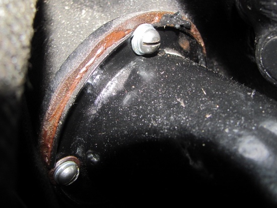

The only reason to add a rolled edge is to strengthen the flange so it does not bend as easily. This suggests strongly that if the first ones had a flat flange and that there was probably a large number of them developing leaks over time. One would expect the design change to make it harder for a cover to distort and leak.
Also you mention that the washer fits up snug in the rolled up flange area. If you are worried about oil leaking out through the lock washer split what do you think of the edge of the Bendix flange which has all 4 screw holes slotted out through the rolled edge? In fact each screw hole has 180 degrees of the hole blown out, no washer or lock washer will ever seal that... if oil gets past the threads!

Posts: 5599
Re: Bendix cover oil leak
Post by RajoRacer » Sun Apr 19, 2020 6:17 pm
I prefer the earlier flat edge Bendix covers as the metal is considerably thicker thus preventing the issue you found with yours.
Posts: 4090
Post by DanTreace » Sun Apr 19, 2020 6:19 pm
Terry
Yes, that is the change from the flat surface Bendix covers, the rolled edge is strong and better to use.
Lock washers are original equipment! Ford specified.
And yes, my photo is wrong, the lockwasher rides on the Bendix cover screw. Would suspect your metic screw is a compromise that could back off, original type ASME #14 thread screw there is needed IMO.

Post by Mark Gregush » Sun Apr 19, 2020 8:08 pm
Lock washers should not have washers under them. The lock washer needs to grab both the bolt and part that it screws into. With the washer in place, would not keep it from turning out.
Posts: 4090
Post by DanTreace » Sun Apr 19, 2020 8:20 pm
Mark
Ordinarily that is correct, in this specific application the plain flat washer provides a totally flat surface.
When those small lock washers are twisted by the screw into the Bendix cover slot, that slot is larger than the screw shaft, and have found lock washer to become canted. That makes one side of the lock washer off set in the slot, and won't let the screw seat flush for me.
Anyway, that's my method, no leaks, others may find different solution :D .
