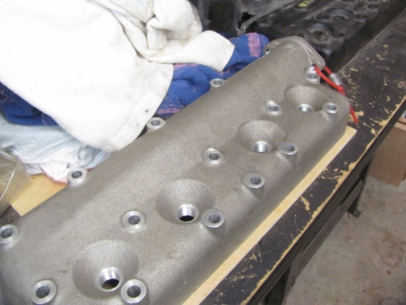

I have a cylinder head I removed from a '23 engine a while back - don't have the car anymore, so don't have the serial #. Wondering who, when, why was it cast without the beloved Ford script on top? Love that big "Ford" script bling looking at you when you open the hood! Any ideas??

Other records indicate that in August 1926 the " Made in USA" and "Ford" were being eliminated from the head castings.

Well. have owned a couple of '26-'27s, and found out the later motors came with the 'bare' cylinder head!
And if you are placing a new high compression head, like the good Prus head, on a late '26, those are un-marked to keep cost down by no trademark selling price percentage fee to FOMOCO. So looks class judging authentic, but with more zoom

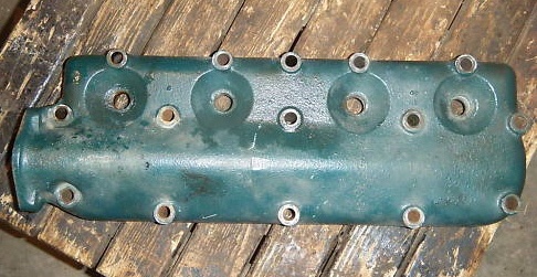

I have a low head with no FORD or made in USA, was told it was early Canadian? Might be interested in finding it a new home.

Steel or aluminium, Joe ???

Re: Cylinder head with no Ford script
Cast iron.
