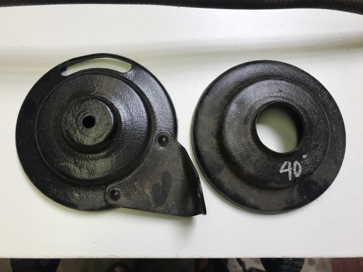

Don't know about the pipes but the rear end (outlet) piece would be the same as repos made today and original used from the time the pressed steel ends started.

I have a set of muffler shells that are in very nice used condition $40. If that will help you out.

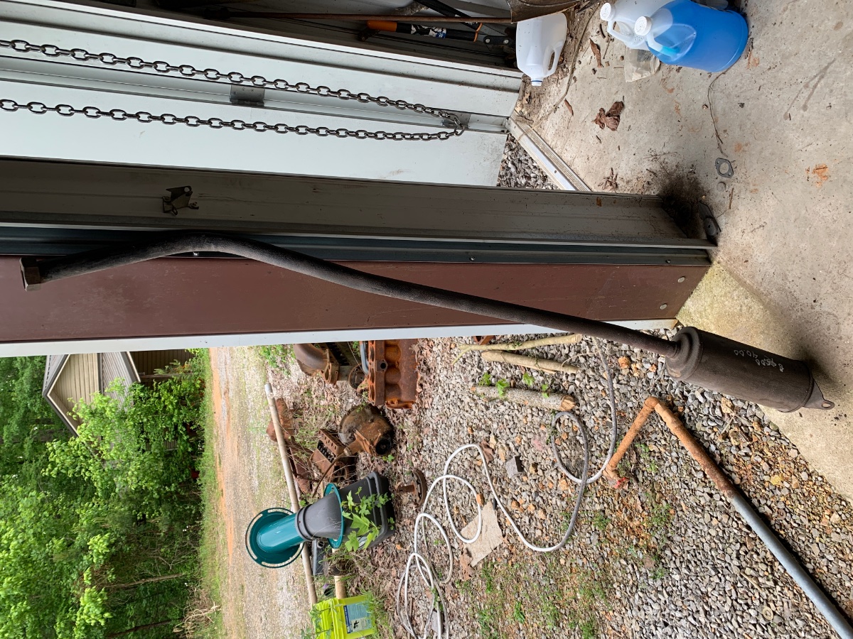

How about a complete original one? Muffler and all, Shipping may be a bit high, but I got one I would sell. Dan

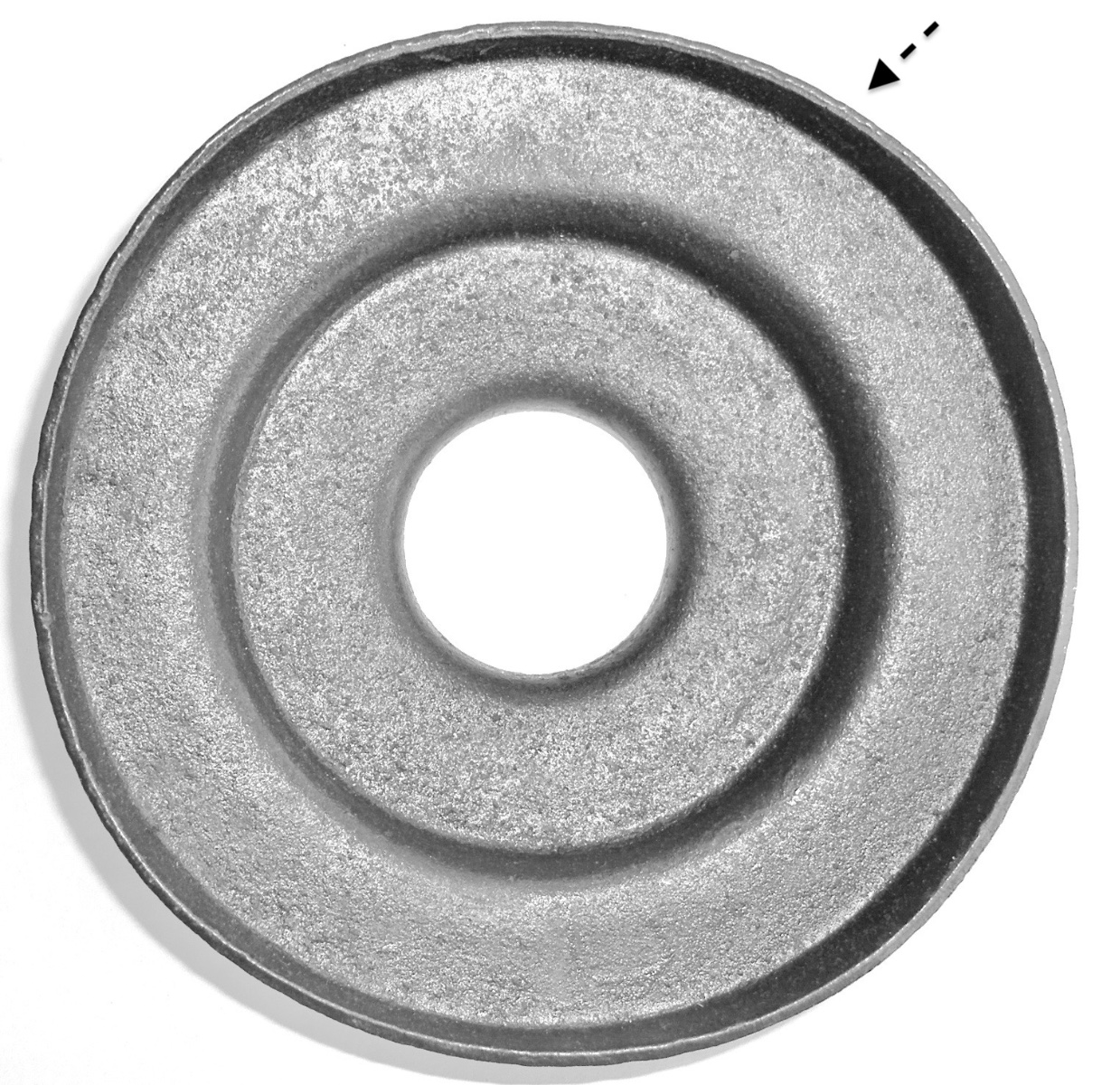

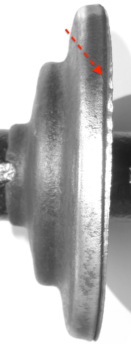

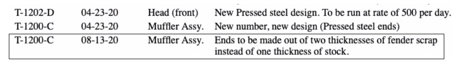

I am not sure wether the present day reproduction muffler ends are the same size as what Ford made in the day.
The original ends were a lot thicker due to the fact that Ford used up scrap fender offcuts etc. and they were a double thickness of that material.

True on the thickness of stock used, but the outer diameter of the outer and middle tubes (shells) remained the same. The inner tube on the replacement style may be a little bigger, would have to do more checking on that tube.

Fascinating. We've all heard all these stories about nothing going to waste. I had no idea they used scrap fender metal.

Here is the original I was talking about. Dan

I think someone should get that pipe from Dan. That is what I have on my 1925. I'll not be making any more of those pipes. It was a lot or work, and the shipping was a pain in the ass. I used a NOS Ford script original for the pattern.
