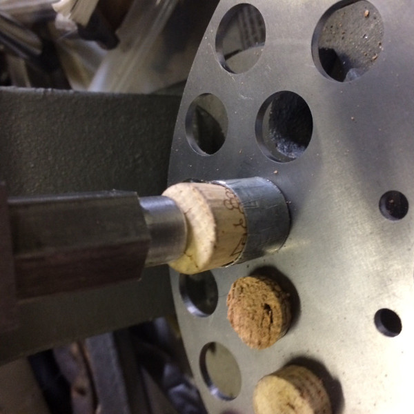

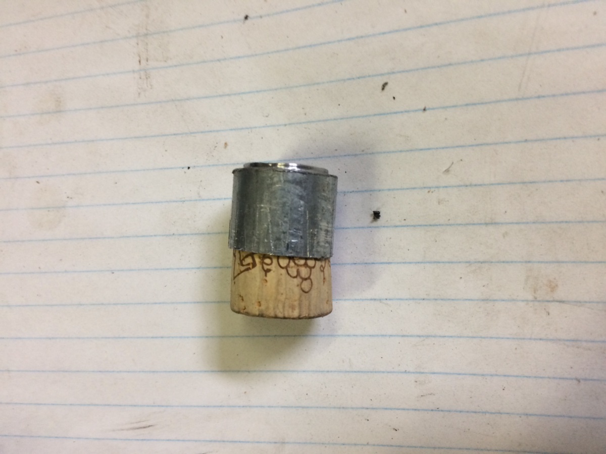

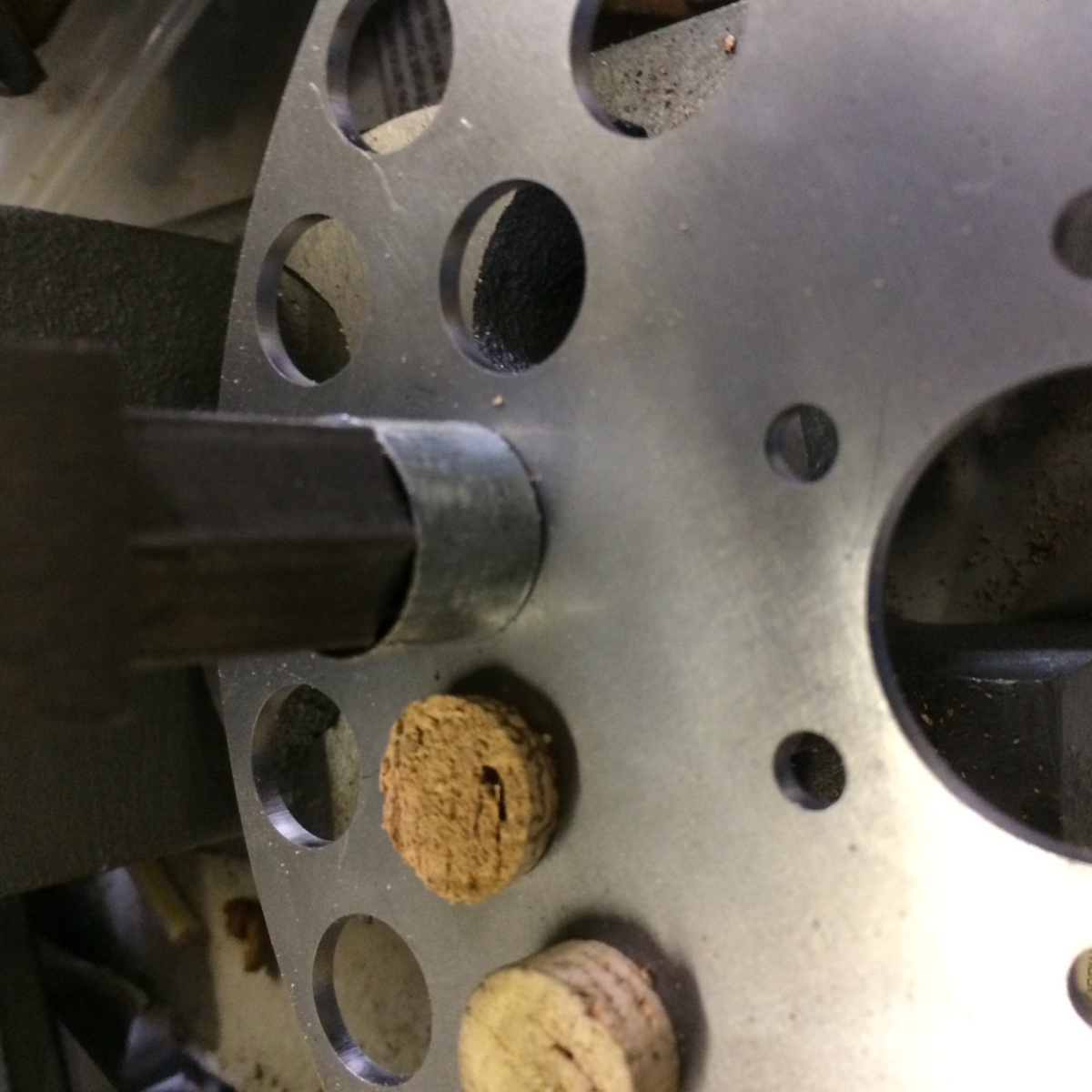

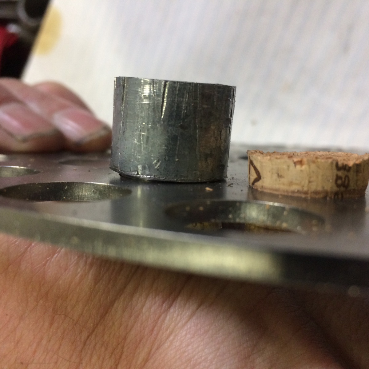

I’ve been working on rebuilding a couple of clutches for a era accessory 3 speed sliding gear transmission for the model T.
In the last couple of days I finished rebuilding the cork inserted clutch discs The corks installed the cork pressing “funnel”
attachment=2]FE7E0600-1857-43A4-85A7-BCC6C0BB8014.jpeg[/attachment]

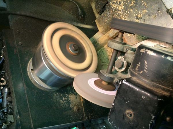

Finishing the corks using a tool post grinder

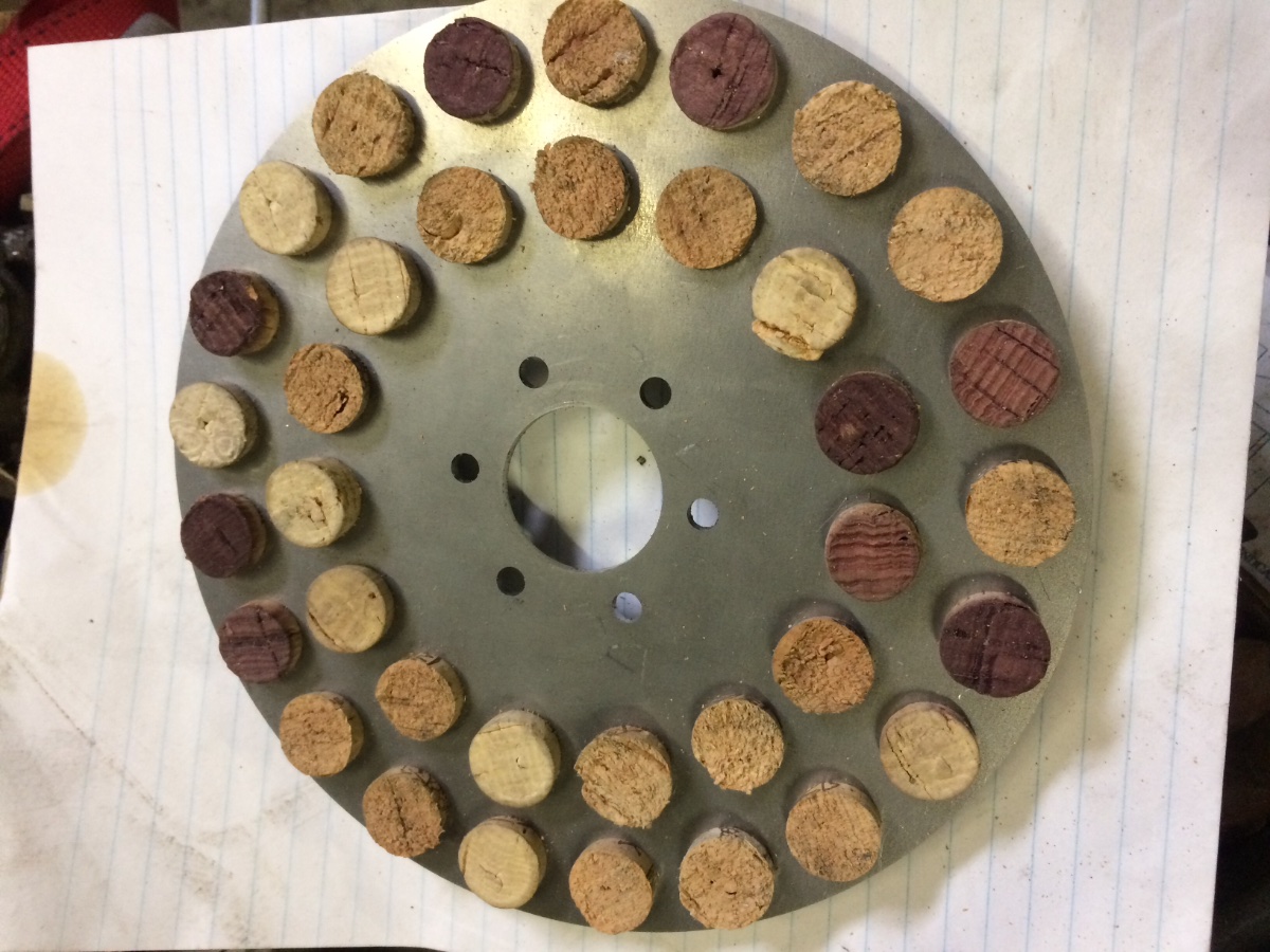

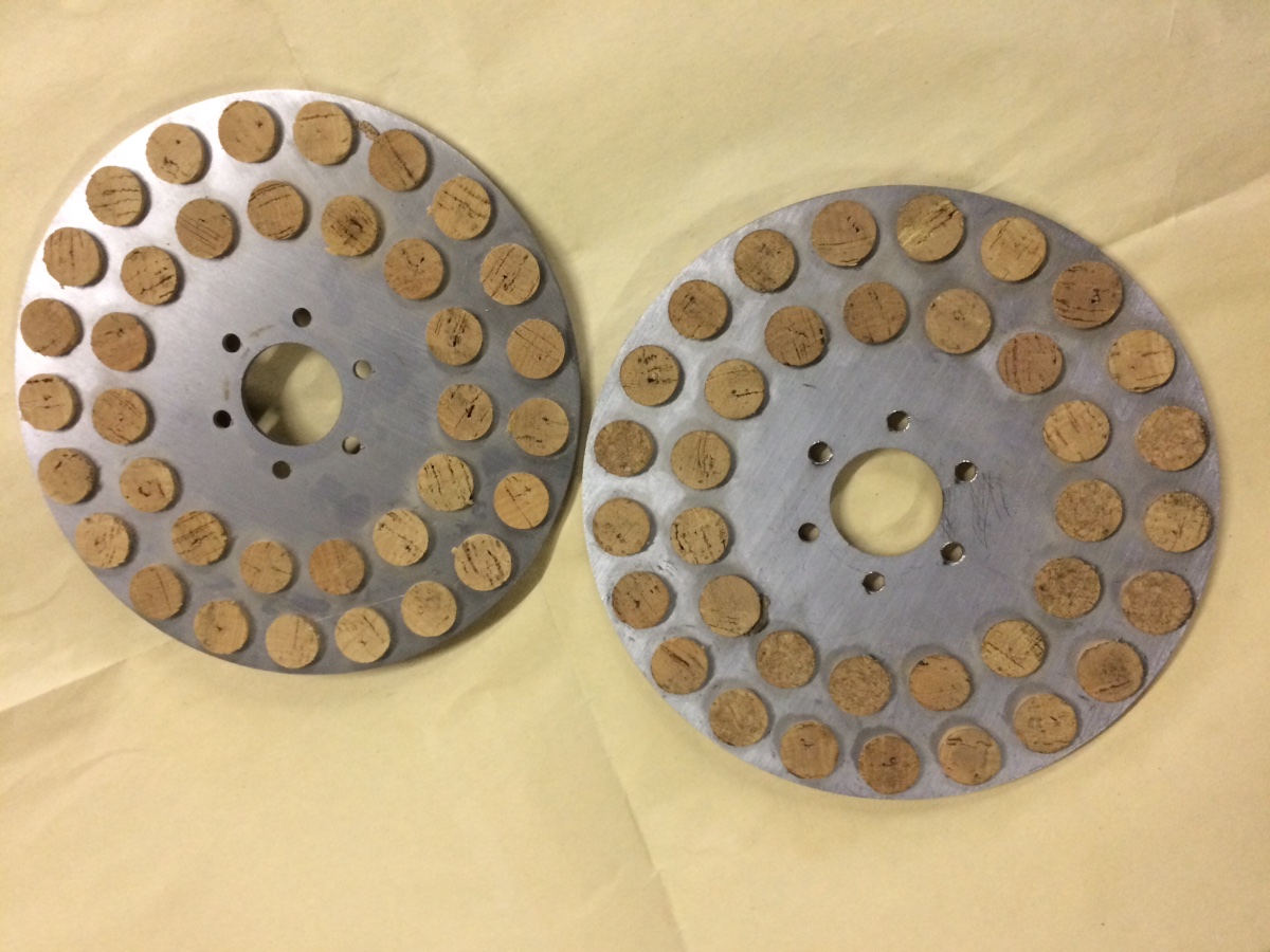

There are 36 inserts per disc and I got 3 from each wine bottle cork and did 2 discs, so 24 bottles of wine NEEDED to be consumed!!

Actually ALL the corks are from the same brand of wine which is our favorite source for red wine. “Fairview Estates” in British Columbia Canada. So no problem on the quality side. We have been buying a couple of cases of this wine every year for probably close to 20 years
