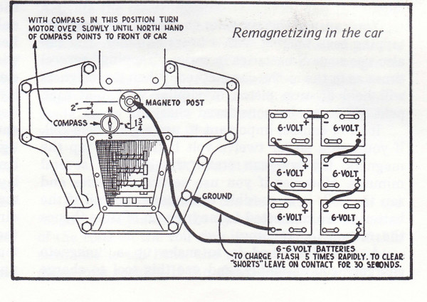

Re: New coil ring polarity question
Post by Norman Kling » Wed Apr 22, 2020 9:21 pm
Someone has posted how to recharge the magneto in the car. It tells where the compass should point in relation to the transmission cover. If you find that same location on the magneto coil ring which would be to the left of the button when the flywheel is in the right position. I can understand this in my mind but might not be able to express it in writing so that you would understand. The north pole on the magnet should be opposite the pole on the ring which is at the left of the button. In that position your zap should work.
