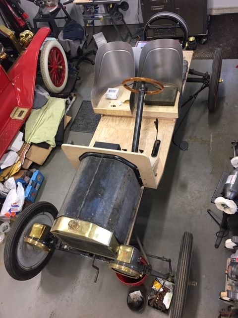

Hello,

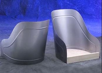

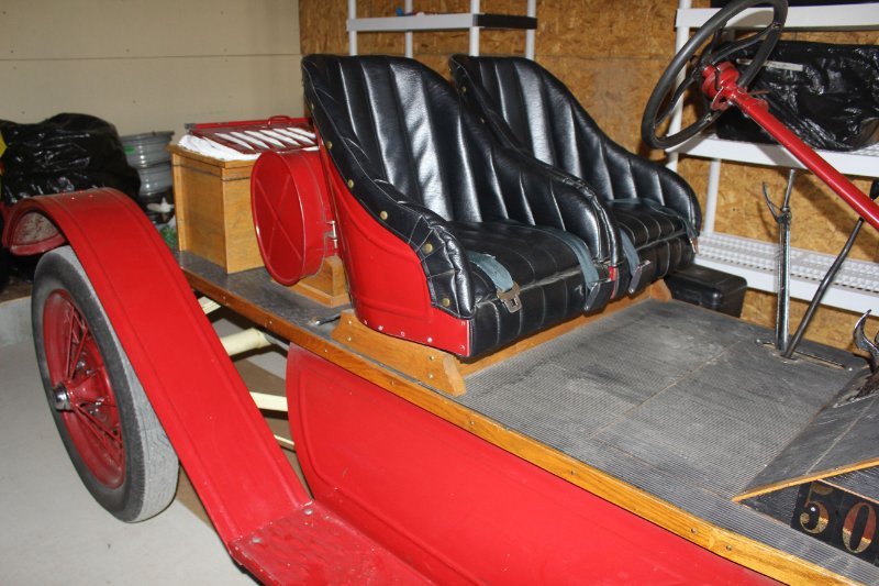

My speedster project is progressing well, I'm now ready to fix my benches. I would like to know how you proceed. How far from the fire wall you have installed the benches. I would like to know how to secure the benches on the car floor. If you can send me photos and explanations on this publication or by email it will be greatly appreciated.
Some photos of my project and also photos of other benches and another conventional speedster.
Thank you in advance.
The Benchs I bought at Lang's
Another speedster I saw

The nice thing about biulding a speedster is you have a lot of freedom where & how things go together, as far as placement put them where they are comfortable. My next speedster will have the seats staggered so we are not sholder to sholder( move the navigators seat back ) Also make sure the seats are the right size. Smaller is easy add more padding, larger is not so easy. A 70 mile stretch in the wrong seat takes some of the fun out of the event. Also consider a foot rest & hand hold for your navigator, just something I have heard the right side of mine. Looks like a nice speedster your working on, have fun. Craig.

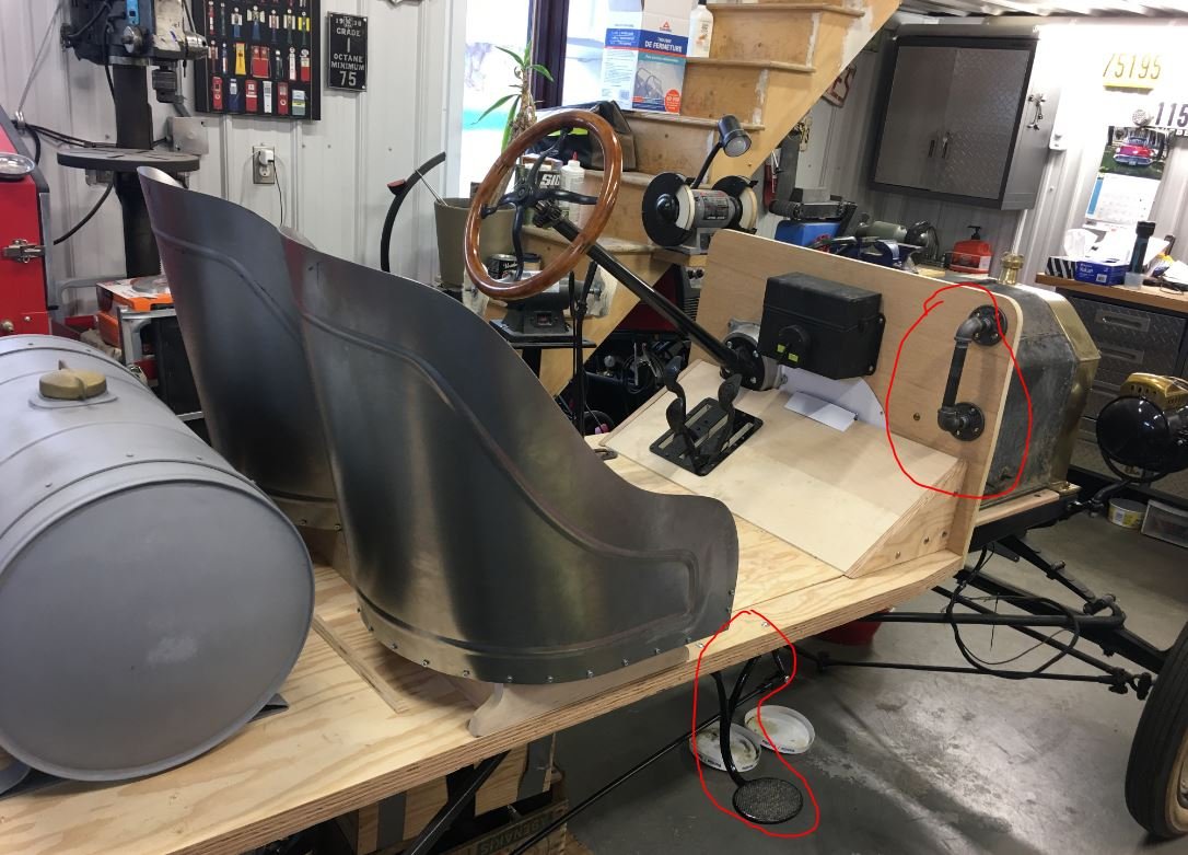

Re: Need Help for installing Benchs on a Speedster

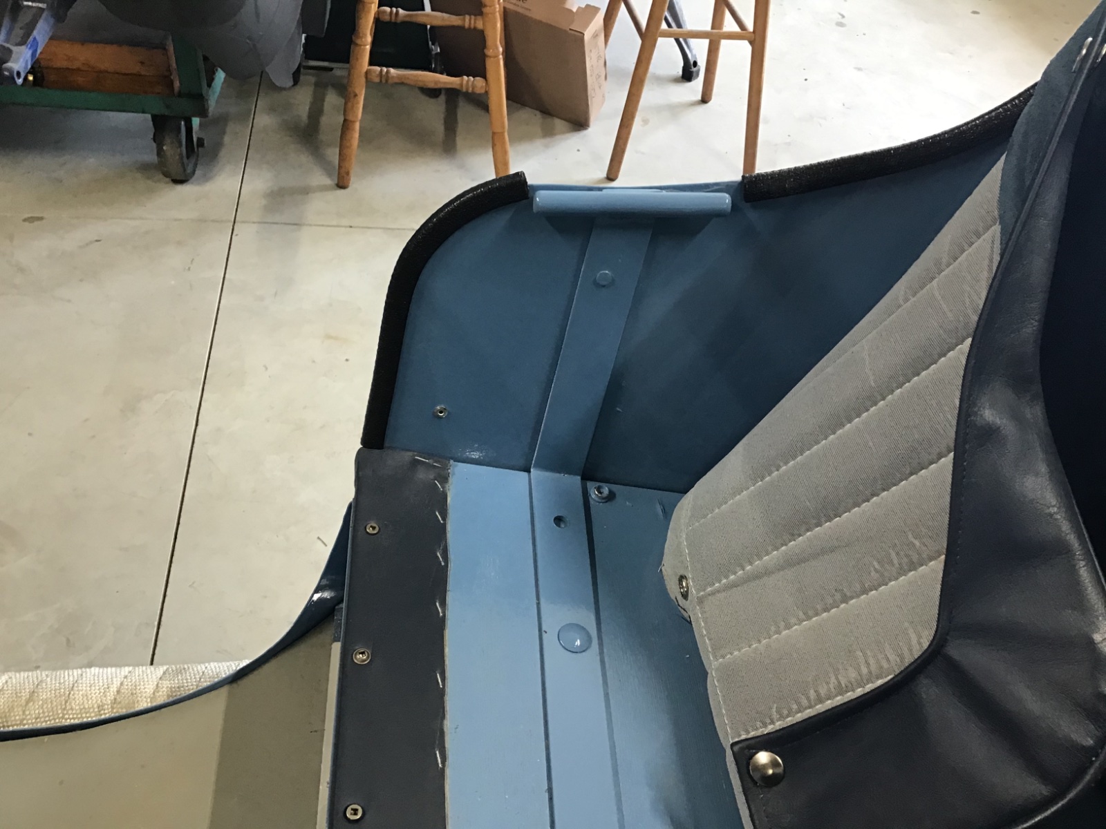

Thank you Craig for your comments. I added an original handle on the passenger side. Look the photo bellow.
You can also see the step in comes from a carriage...

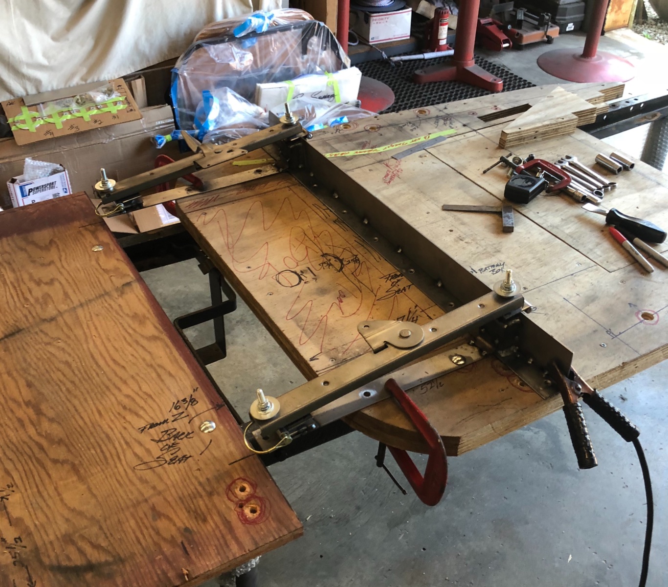

Mario,
A secondary note on seats is setting them at a leaning rearward angle. The ergonomics of the human body are paramount or driving fatigue kicks your butt. I also install a low profile adjustable seat track, everyone is comfortable! Just trying to help.
The black line shows where a brass knob is for the adjustable seat track. Bottom picture.
Hank
Hank
Thank you Hank. Perhaps did you have a picture below the car to see how it is fixed for the benchs?
I would attach the seats with 4 carriage bolts per seat, going through the seat bases, the supports beneath the seats, and the body decking. I would also seriously suggest adding brackets, braces, etc., to more securely attach the sheet metal to the seat bases. Can you imagine how easy it would be for the sheet metal seat backs to separate from their bases if you were ever rear ended?

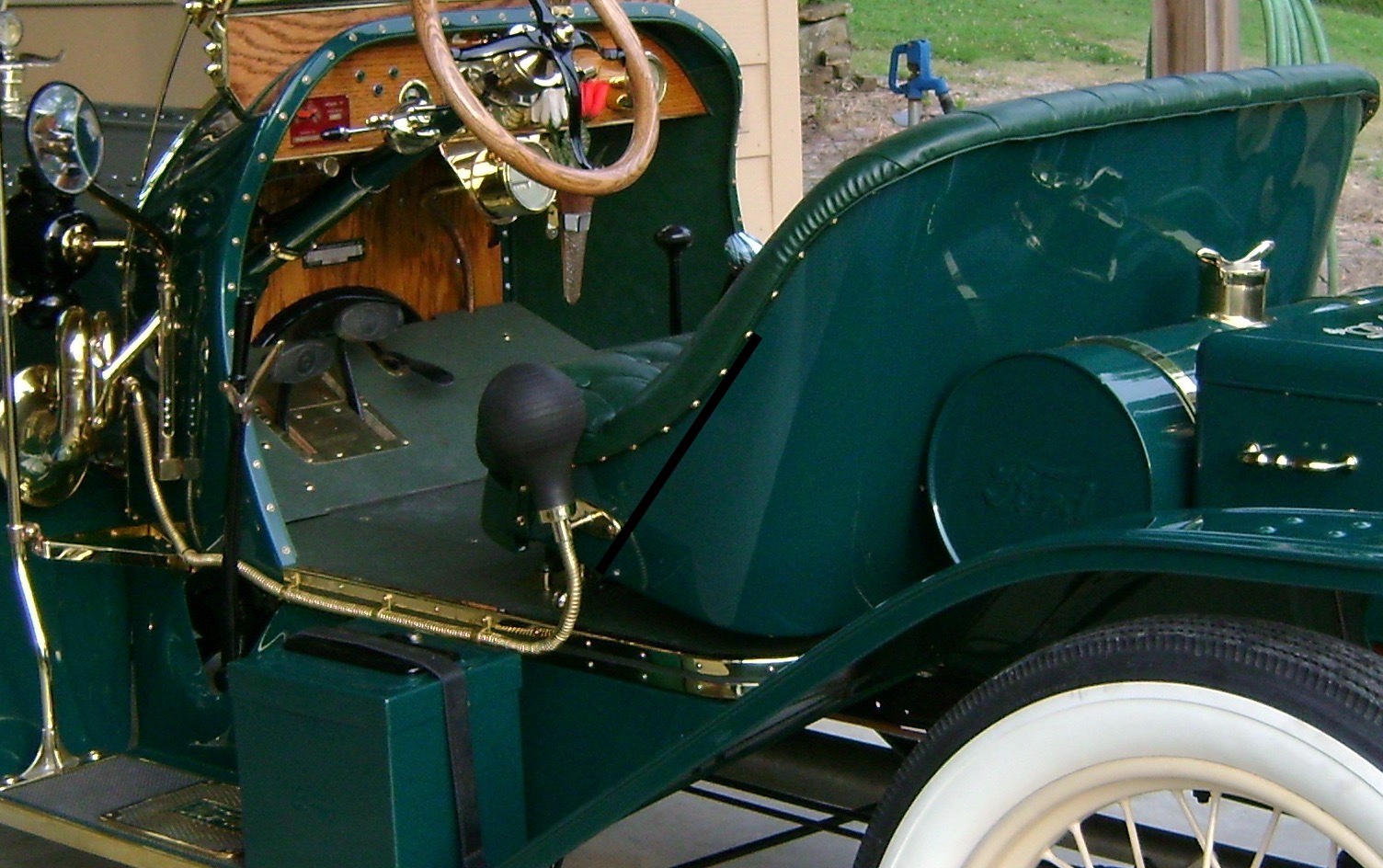

- Posts: 2969
- Last Name: Hjortnaes
- Location: Men Falls, WI

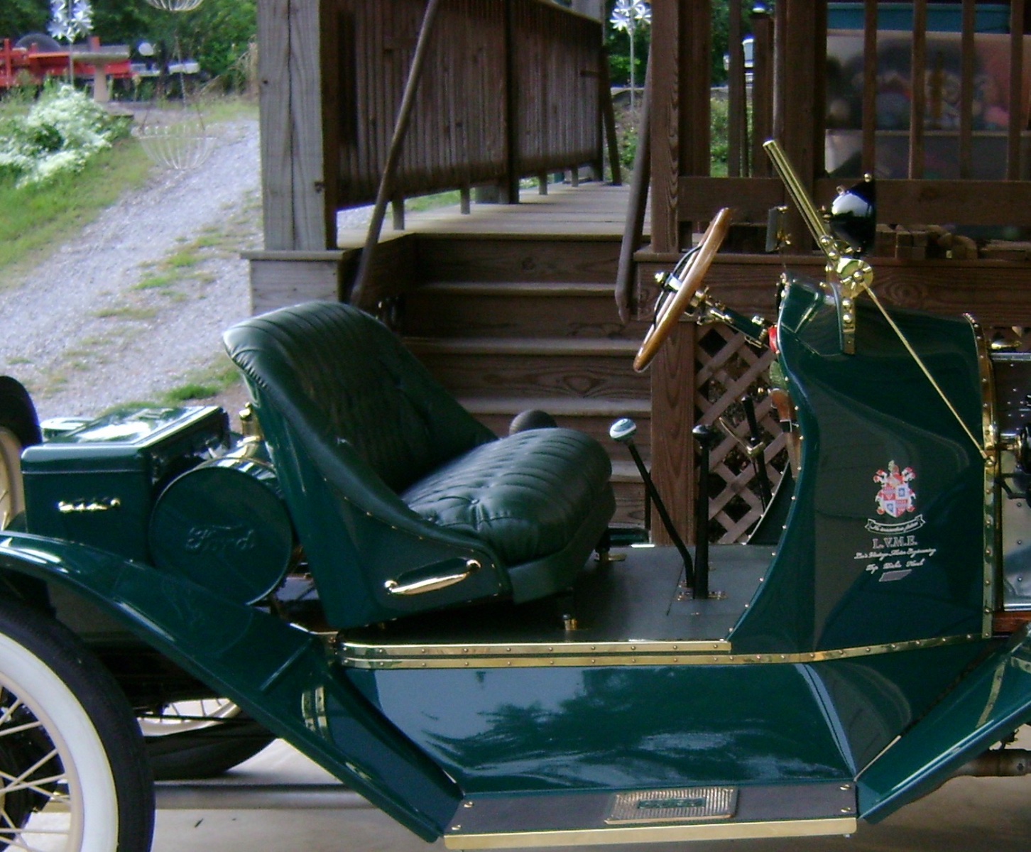

Mario
I did not build this car, but I did modify the seating. I wish there was a way for me to angle the seats. It does get very tiring on long journeys over 50 miles. The front of the seat base to the rear pedal is 25 1/2 inches. 24 1/2 inches might be better, but it gives me a little more foot room. When you are cruising you do not touch the pedals anyway. I have a 32 inch inseam. I attached my seats to a solid oak board with 4 bolts. Then I put a hinge all the way across the front of the seats so I could lift up the seats and now I have storage underneath them. The hinge is solid brass, not plated brass, so it will not rust.

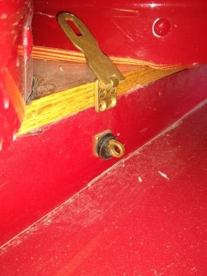

In this second picture you can see how I attached a clasp that will hold the seat down in the event of a front end collision.There are a couple of neoprene gaskets to keep it tight and cover up the rattle. Just a mild safety feature. I know it will not hold if I crash, but it is better than nothing.

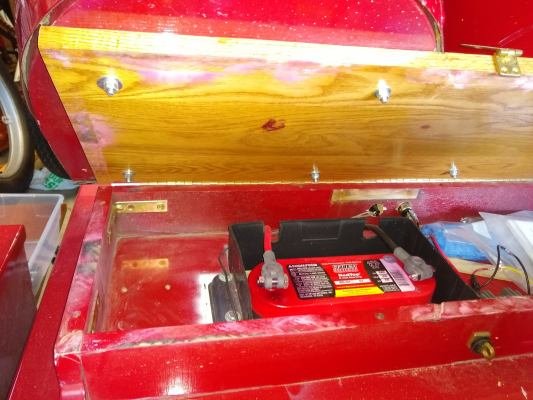

In this photo you can see how the seats are bolted to the oak board. The board is sealed with urethane. I also placed a battery holder, the kind you use in a boat, to hold my optima battery. This really works well and you can also see how much storage I have for parts and all the legal paperwork. Extra key, goggles, etc. go under here.
These are the same seats you have. From the photos, it looks like my seat risers are attached with bolts from underneath. Carriage bolts?
More Ideas with a flip up system and adjustable tracks (1970-1987 Ford F-100- F-350 bench seat tracks) using a tool tray under the seat.
Hope this Helps,
Hank

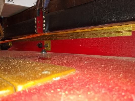

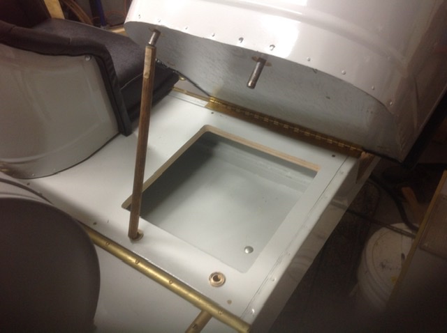

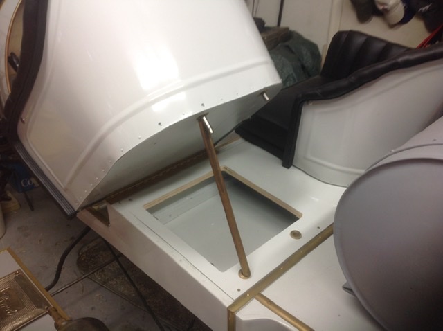

I wanted storage under the seats so I used a piano hinge in front and repurposed some old spindle bushings and tappets to guide and stabilizes the seats when they are down. Worked out great.
