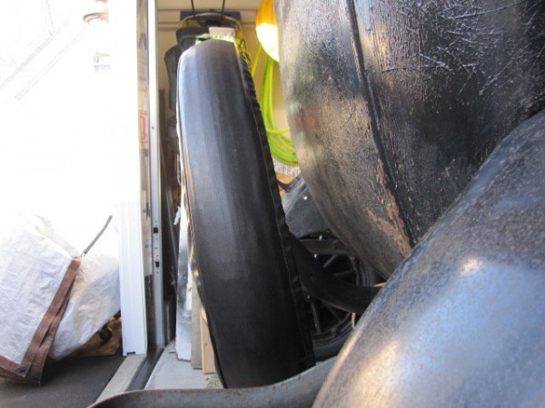

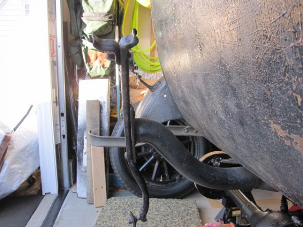

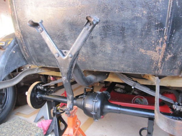

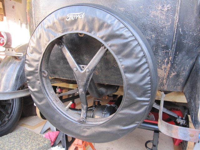

Steven here are some pictures of my 26 fordor rear carrier with and with out the spare, hope it helps. If you need any more pictures I can post them for you.

Thank you both i should have mentioned it is a wire wheel spare tire carrier, and that answers my question.
