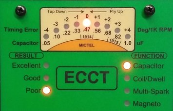

For Example: Here is the Capacitor Test results for a coil with Brand New Capacitor.
ECCT Capacitor Result with Leakage.jpg (45.01 KiB) Viewed 2529 times
The Capacitor Value of 0.47uF BUT the test Result is displayed as "Poor" because my fingers were touching both point elements.

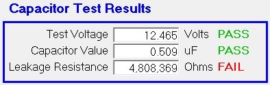

The numeric values of the test parameters provide a better clarity:
Capacitor Leakage Test Failure.jpg (16.65 KiB) Viewed 2529 times
Note that the capacitor Value is only 8.2% high (PASS), the leakage resistance value (4.8 Meg Ohms) is lower than typical (>50 Meg Ohms) so it is flagged as excessive leakage. BUT this is still a tiny amount of leakage that will NOT adversely effect coil performance. In hindsight, the capacitor leakage test threshold should have been set much much lower (1000's of Ohms) to where it may begin to effect coil performance. There are notes in the manual on the capacitor test results but may not be clear. Apologies for the confusion.
