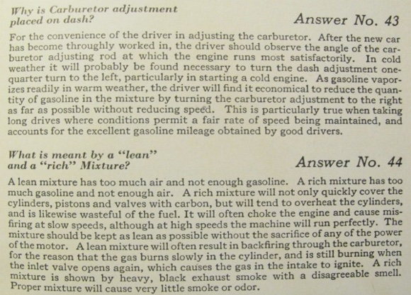

A section of a book I’m reading discusses how to adjust the fuel mixture of the carb with the knob which comes though the firewall. It says, “A rich mixture is indicated by a heavy black exhaust smoke having a disagreeable smell. When this condition is manifested the needle valve regulator on the dash should be screwed down or to the right until the engine begins to misfire, then the gasoline feed is gradually increased by opening the needle valve in the other direction slowly to the point where the motor runs steadily and at a high rate of speed with a full throttle opening, at the same time, there being no evidence of smoke in the exhaust.”
Does that sound good to y’all? Or does anyone have some different guidance?

Sounds good to me. That’s how it’s done.

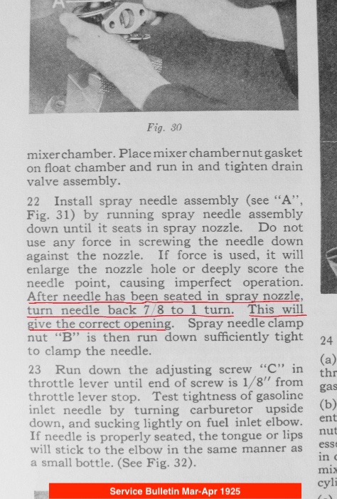

A good starting point is to gently screw the adjustment down until it seats, and then open it 1 1/2 turns.

The Ford Owner's Manual is a useful resource too. Vendors supply reprint of these.
And setting for initial starting of a fresh rebuild of the popular Holley NH, where the needle valve is new and new seat, these positions have worked the best IMO.
