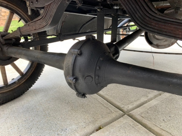

Gentlemen,
I’ve read several of the previous forum threads on changing out the differential oil. This 13T hasn’t been driven in over 10 years which means what hasn’t leaked out has been sitting for a long time. I’d believe the advice would be to change the oil and not add to it but looking for suggestions from the brain trust.
Whether I tap an 1/8” hole and put in a new plug, or use a suction device, any guidance on the best way to prepare for the change since it won’t be driving? Heat gun, nothing just go get it, etc?
Saw some discussion on using 140w oil as a replacement. Any new comments on that front?
Thank you for your time,
Darin

While I might suggest adding a drain on the 1916 up rear ends, I would be hesitant to do so on an early one. My suggestion would be suck as much out as you can, then fill with diesel, mineral spirits or kerosene, with the wheels off the ground run the car (don't forget to chock the front wheels). Let it soak then run again. Drain then repeat. Let sit over night so it has time to drain down and then remove all that you can. Fill with your choice of lubes to about 1" below the filler hole while still on the jacks run to circulate the lube. Take the car off the jacks, let the lube settle then check to adjust to proper level up or down.

Hmmm... If you're not going to drive it does that mean it does not run or you do not plan to start it? If so, some of Mark's advice (which is good) won't apply.
If you don't plan to drive it I don't know if it is absolutely necessary to remove the old oil at this time. You can dip something in the filler hole and get an idea what shape it's in. Regardless, I think it would be wise to try to spin the gears and such in the differential to coat them with oil. Same is true of the engine. Maybe jack the rear end up, take out the spark plugs and crank it for awhile. Hopefully someone who has been in your situation will chime in with advice.

Depending on the mileage since the lube was last changed, it wouldn't bother me if it sat for ten years and just needs to be topped off. If you know what viscosity is currently in the rear-end, just add more until the level is 1.5 inches below the bottom of the fill plug.
The above is just my opinion so take it with a grain of salt.

To clarify, it hasn’t run in over ten years but I’m working my way to getting it back to drivable. Doesn’t crank either due to a variety of projects which are almost complete. So, the advice which necessitates driving won’t work for me at this point... hopefully, by the summer I’ll be there.

Then if it were me I would be getting it running first then worry about the rear end. With unknown lube in the rear end, I would still do a flush and refill at a later date. Also, when you check the lube be watching for silver color, which could indicate the thrust washers are babbitt/white metal and are coming apart, unless you know it has bronze ones installed.

Do you know any history about the rear end? Ever been rebuilt or? As far as changing the oil in it do as Mark G says and thin it down with diesel a couple of times or more and drain and redrain.
Then jack up the rear of the car and put the car in neutral. Then turn the rear end by hand and listen for any noise or clicking. Don’t know if you want to do this but that will give you an idea if something isn’t right.
If OK then fill with differential oil and you should be OK. Also check out the old thinner oil by straining it with fine screen wire or coarse cloth to see if you find any metal slivers and etc.
Hope this helps.
Hope this helps.

If your goal is to get it running, my suggestion would be to pull the rear end and go thru it carefully. Babbitt thrust washers should be replaced with bronze and the condition of the axles, driveshaft, gears, Hyatt bearings, bushings, universal and such should be be determined. I would also suggest installing a Fun Products Modern Pinion Bearing in place of the original Hyatt. Floating safety hubs are an excellent way to relieve much of the strain on your axles and insure that if one does break, the wheel will stay on the car...
A friend of mine with a 1919 was recently towing his car in an attempt to start it. When he engaged the clutch a rear axle broke and the wheel fell off. Further examination showed that the axle must have had a crack for a long time that finally failed when extra force was applied. Opening the differential to replace the axle (he replaced both because the other showed scoring) he found babbitt thrust washers-another accident waiting to happen. He is now rebuilding it with new axles, floating safety hubs, etc., etc. If you plan to drive the car frequently then it's good to know the condition of the moving parts. My car had sat for at least 30 years when I got it. I went thru everything that moves on the car and now have a Model T that I trust explicitly. I'm not guessing about it's condition....I know! Just my two cents.

If it's possibly (and quite probably) still got the original "tar like goop" in it as I've encountered in a couple of '12s and a '20, frankly no amount of diesel fuel and draining will clear it out adequately. This crap is almost like tar. IF that's what it's got in it, and you should be able
to tell with a good inspection thru the hole, and today there is all sorts of neat little optical devices you can attach to your smartphone to look at it, then really a "tear down" would be the best thing. Then you can inspect everything for wear anyway, and refill it with the so-called 600 oil you can get from Snyders or Langs. Just my two cents!!

You could always put a light bulb under it for a while and then turn the rear wheels a bit to move it around. Then stick your finger in to see what is in there. Your best bet is to probably tear it apart anyway.

Stick a wire or a pipe cleaner through the filler plug to see what's in there. What ever you do, don't overfill it.

I would agree with Oldav8tor. You need to go through the rear end before you take it on the road. So until you have the rest of the car ready to go, just leave the rear end as is. Then before you take it out for a ride, disassemble using the booklet "Rear Axle" published by the club which is a very good step by step guide for the amature mechanic. You really don't need any special tools except for pullers to get off the wheels and the pinion gear and bearing if necessary. Those thrust washers are very important because if they crumble, you will lose the gearing and brakes.

I agree with earlier threads suggesting you pull the rear end, turn it on its’ side to empty out the 600wt oil, open it up dismantle it, clean it, inspect each part and replace old worn out seals, bearings and parts with new modern replacements and reassemble. I bought the 600wt. Differential oil used in mine from Snyder’s Antique Auto Parts. By rebuilding the differential, you know it will be safe. I would never drill a hole in an original ‘13 T pumpkin. If you plan on doing this again, invest in a suction pump. I invested in one on 1990 and only used it once. Have fun and stay safe. Jim Patrick

Don't drill it!!! A suction pump and a long enough hose will clear whats in the differential enough to change the oil out. The only other way to "Really" drain the oil out is to (a) dismount the differential from the car and drain what you can out of the fill hole, and if that's not enough, (b) split the pumpkin. It's not that hard, but it's time consuming.
As to viscosity? I remember reading somewhere that 600W is actually at 275 on the viscosity scale. The biggie with 600W (other than it's thickness) is that (being a steam service oil - really!) it does not attack brass or bronze, which is huge. It also has the thickness to cushion the gearing AND the "gooeyness" to travel to and adhere to your rear axle bearings. It also won't seep out of your rear wheel seals as readily as thinner oils will.
I also would not put a "thinner" or K1 in the diff without deciding to pull the axle and making sure all of that light petroleum is out of there... it doesn't take a lot of K1 to thin out heavy oils...

Susanne made a great point. The most important reason for having such a thick oil as the 600wt, is so that it will stay in the pumpkin and not seep past the seals on each side of the gearbox, into the shaft housings on each side of the pumpkin, for if the oil seeps out of the pumpkin over time, your differential will not be long for this world. It seems like you don’t know if the rear end has ever been rebuilt. That is all the more reason for you to do the rebuild so that you can be sure that it has new shaft seals on each side of the gearbox to keep the oil in the pumpkin. Jim Patrick

Having known him very well I suggest you definitely remove the differential and completely overhaul it. It has been restored for many years, not sure exactly how long but probably as far back as the 1960's. Many members will recall that your grandparents were injured when the steering wheel and gear casing broke away from the column on one tour and it rolled over.
After all these years any old restoration should be thoroughly checked out to determine exactly what its condition internally it is in. I find it strange that some people in the past 10/20 years are extremely reluctant to do any major investigation into the condition of a Model T Ford they have that was previously owned by someone else. I could quote lots of cases ( and I"m sure others could also) where cars driven by new owners suffered major breakdowns due to the failure of the new owner taking the time to do a thorough check on the mechanics. Model T's are a simple piece of equipment experienced owners would not hesitate to disassemble at any time even on the road. If you wish to use a vehicle it has to be in good safe condition.

Thank you for the suggestions and I’m all on board for keeping safety as the priority. I remember the stories of that rollover accident well and would not care to repeat.

After some suggestions here, I’ll follow a short and long term solution. Short term, I bought a grease/oil suction tool and removed the old diff oil. Am putting new diff oil into it. Would this Lucas 85W-140 work or is there something I’m unaware of which would be mean disaster if I use this product? I bought this prior to seeing Lang’s 600w oil product. It wouldn’t be a big deal not to use it; however, if it’s just as good as anything else...
Long term, this winter, I would like to take the rear axle off, check the gearing, and make a more informed decision after an inspection. Will also need a new gasket because the diff has a decent leak.

Now I have gotten into "heated discussions" with others here on the board regarding Ruckstell axles... some say you need a light gear oil, not 600W... but both those cars had Ruckstells that were hard shifting, sticking, rough sounding rear ends... when I swapped them to the juice Ford said, they became easy shifting, smooth operating, quieter gearsets. Add to that - 600W (which is a steam oil designation, BTW) is about 275W in the current viscosity scale of oils... It is safe on yellow and white metals used in the rear ends... and is much thicker and "gooey-ier" than either of the common "gear oils" by a large margin.
I don't want to rehash this, as some people are pretty adamant over their rear end lube choices, just like motor oils, but it works for me (and worked for my dad), and has for some 35 years. I've yet to blow out a Rickstell or have a rear end failure running it. And some of my miles have been "ride hard and put away wet" daily driver miles.
RustyFords
- Posts: 1559
- First Name: Don
- Last Name: Allen
- Location: Houston, TX
Re: 13T - Rear Differential Oil
When I read other's questions, I tend to ask myself, "What would I do if this were mine?"
In this case, if the condition of the rear end was unknown and I planned on driving it, it would get torn down to check the bearnings and thrust washers. With this approach, the condition of the current lubricant becomes moot.
