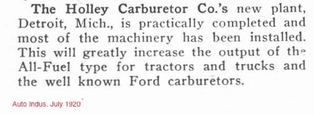

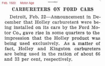

Post by DanTreace » Sun Apr 26, 2020 2:53 pm
James
Yes to that, Ford needed lots of carburetors, to keep production during the hot times of the mid-twenties. When Holley made the NH model, it was much better than the former design.
So to keep up demand, Ford acquired rights to mfg.
Ford was using both Kingston and Holley at the time, and couldn't keep up with production even with two types of carbs! :o
Finally, looks like Holly Co. got underway with a new factory nearby, likely that let Ford off the hook for mfg. the Ford tag versions. Plus later that new Holley factory made the Vaporizor carb for the rest of 1926 to the end in 1927.

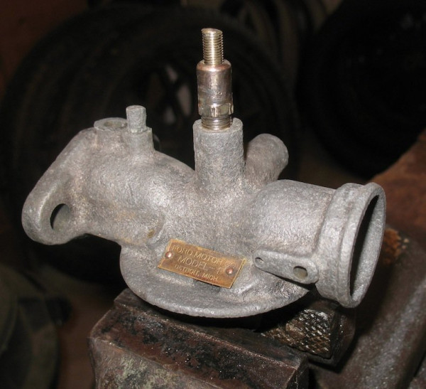

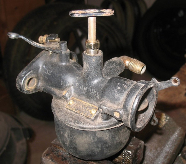

Post by Steve Jelf » Mon Apr 27, 2020 11:06 am
OK How about the Ford F carburetor?
That's the name used on Ford's version of the NH.
Other than the tag, the only difference I noticed is 32 and MADE IN USA on the Holley version.
Steve, the brass tag on my carburetor says Ford NH.

Post by Steve Jelf » Mon Apr 27, 2020 3:55 pm
...the brass tag on my carburetor says Ford NH.
So apparently Ford used both names, NH and F.

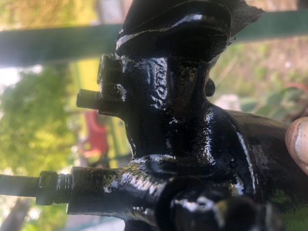

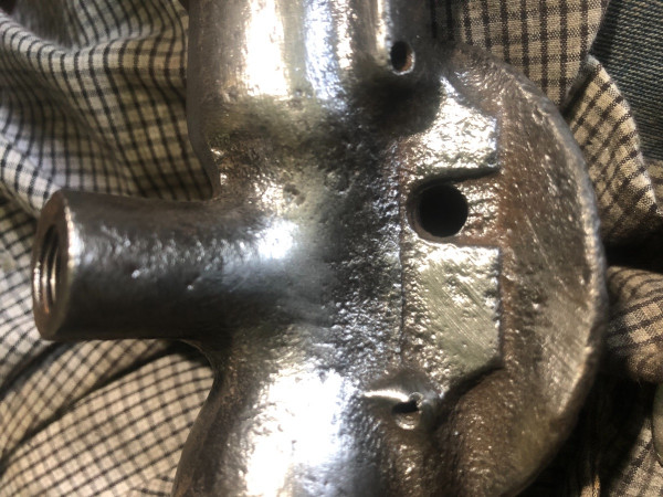

Post by Corey Walker » Mon Apr 27, 2020 7:26 pm
I was working on this one today. It has the screw in vent like the early straight through NH’s and no data plate. It has Ford cast into the body, but is a swayback with the offset drain and long throttle and choke arms. Maybe it’s a transitional model.
