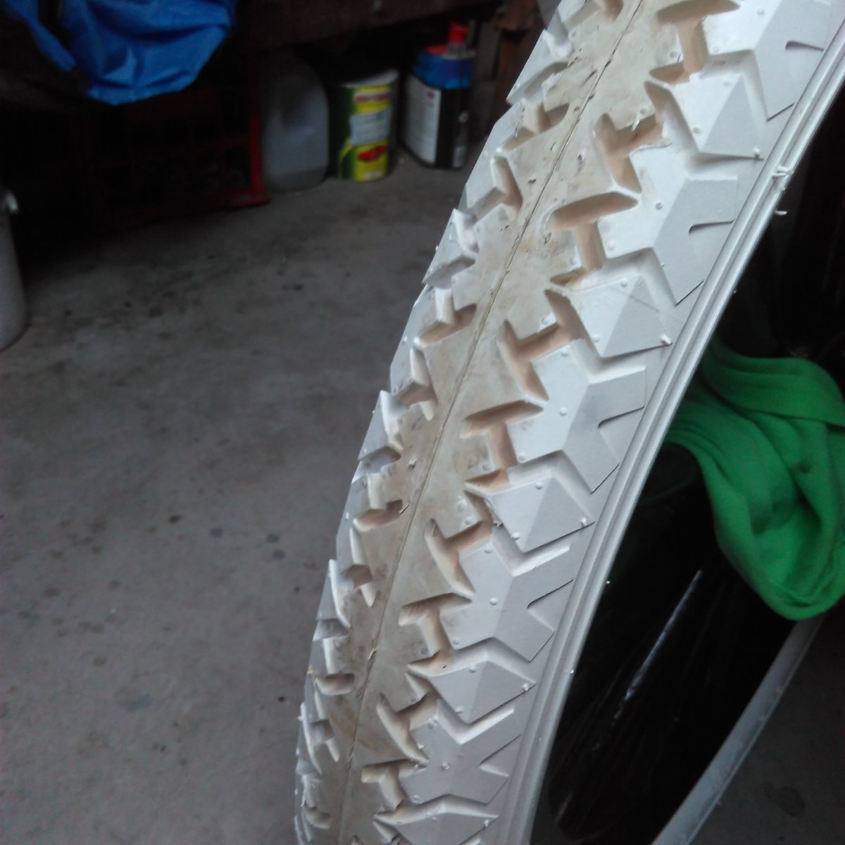

Johnny: Interesting about your experiment of painting your yellowing tires. Cause attached I have a pic of my second set of white tires that were "warranty replacements" for the first set that went brown within a month. This tire posted here sure looks to me like just maybe the mfg. has tried the same thing? No one has been able to validate my idea here though. But look at the edge of the "white" and it even looks like "surface millage" to me. These tires kept their white for the most part, but in the second year started to show slight yellowing, but did clean up fairly well. I no longer have the car, so can't attest to how they are now. Tell me what you think!

Is that white paint dense enough to be used on BLACK tires? If it is, we could save a lot of money. Buy the cheaper black tires to begin with, get the long tread life of black tires, and get the period look of white tires that stay white.

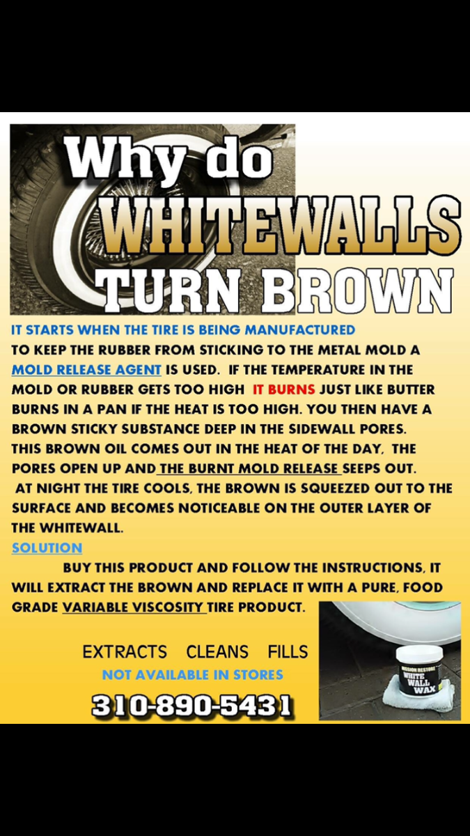

I don’t have, nor have I ever had, white tires but I saw this and took a screenshot. It was on a Facebook antique car site. I can’t remember the comments about it now but it was brought up in a discussion about white tires, not just whitewalls since most people are unaware that tires used to be white.

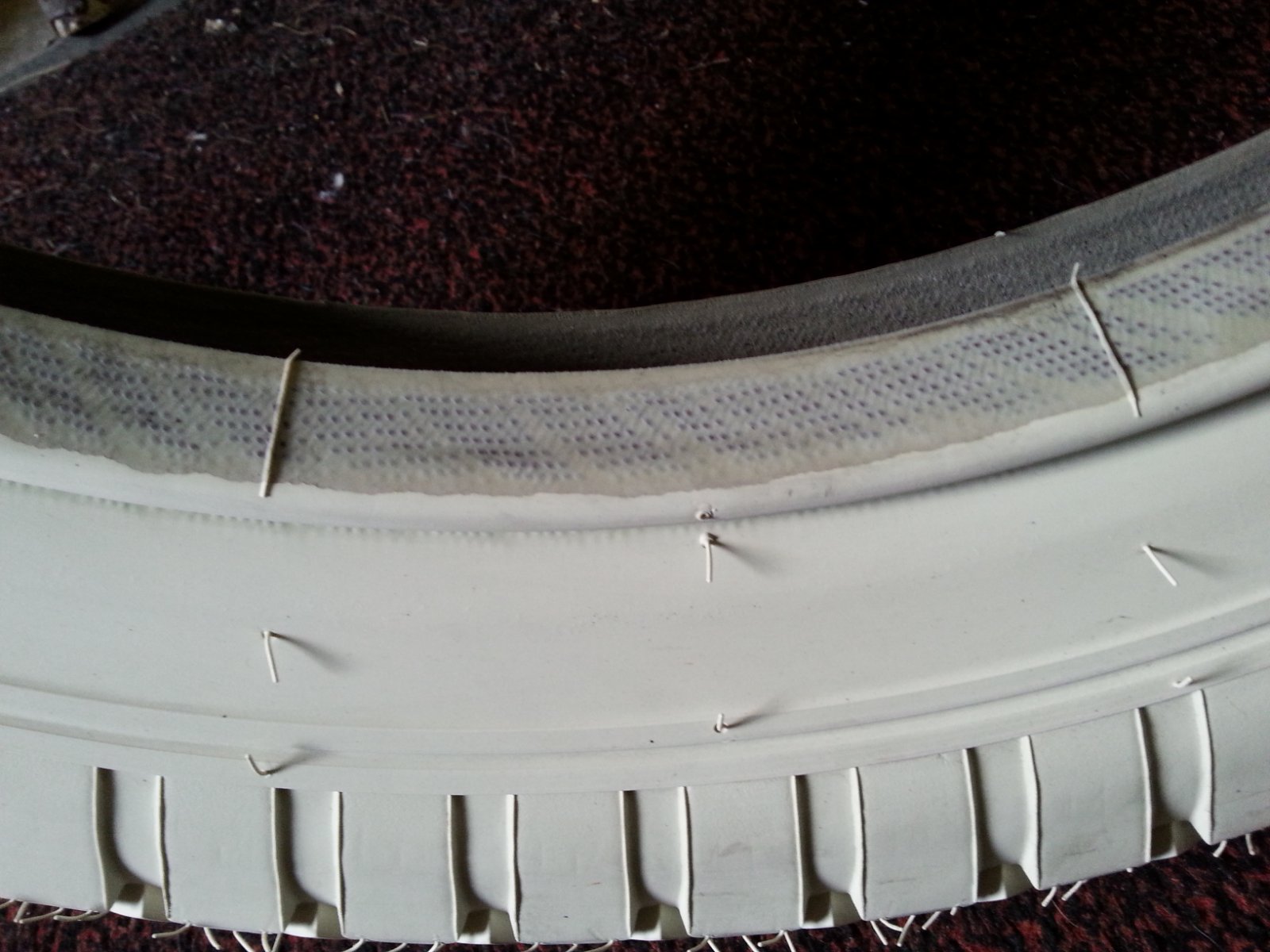

I noticed that pic of your white tire where the woven bead is discoloured from the rest of the outer smoother surface of your tire..i believe this is quite normal being that it is the tires woven inner base with its rough texture..& it looks like further applications of white rubber were laid over this base in the manufacturing..
I also like the theory regarding side whitewalls turn discolored ..that wax stuff might be allright if it rejuvinates & softens the tire to be subtle again..& the white tautflex paint i used is dense enough to paint a whitewall on black tires.. my white tires were not just turning brown but large patches of purple were showing and cracking..and this tautflex paint filled the cracks up..in areas where deep cracks were..i applied and scraped in that orange high temp silicone gasket goo before applying any white paint

In the post (2 above) a member posted a screen shot of a product that whitens whitewalls (so of course it would whiten tires). The wording on the screen shot was somewhat vague, without the product, the company, the address, the price, or anything relevant being mentioned. I Googled the phone number and followed a series of circuitous, somewhat wackadoodle posts. Has anyone used this product? Is it just snake oil?

The company of the above mention product is: Mission Restore. Amazon sell it and reviews are not that great. You can fine there line of products by entering the following on Google. "lasteffortgarage.com/cleaning-products.html" Interesting line of products.
