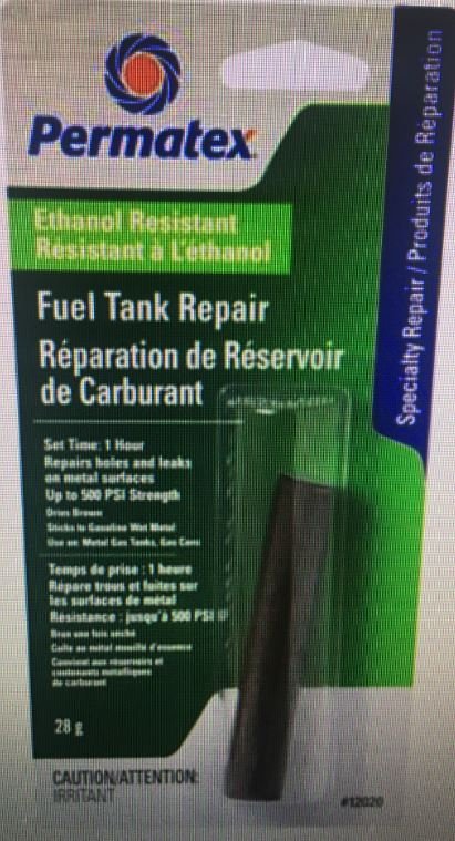

So I decided to use a cheap paste named Permatex fuel Tank repair at $9.99 only.  You cut the paste and you mix the epoxy stick to a uniform color. If mixing is difficult you warm the epoxy to room temperature.  Personnally I used 10 secondes microwave.  You apply the paste to the repair surface with 30 minutes forcing into crack or holes to fill out. You could apply without removing the gas if you want and it is what I did. Just need to apply pressure until adhesion begins to take effect arround 2 minutes.  It was set in 1 hour.  I waited 24h00 and bring back the gas tank  in to the car.  I made a little tour of 30 minutes with my wife and no more leaks.
Happy to keep the original tank.
