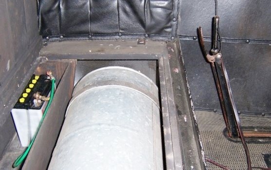

Here's a photo of one's add to non-starter T of a small 12v DC motorcycle style battery under the front seat. Should last a long time prior to trickle charge just using it for start ignition on your '13. Have fun with your new T!
