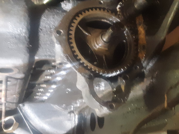

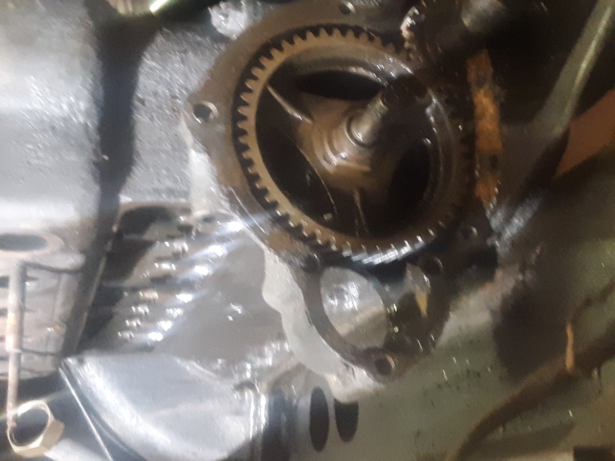

Alright I'm back at it...so my valve clearances were bad, really bad, 6 of the 8 were around .004.. so the question is ...is it possible to pull the cam replace the lifters in the car ? Or do I need to remove the pan and flip the motor upside down to install adjustable lifters ?
- Posts: 5575
Re: Lack of power questions
In any case you are first going to have to pull the valves/springs, keepers, generator, generator mounting side cover along with inspection plate and timing gear cover . The original lifters had a small hole in the side that a pin can be suck in to hold them up. You can lift them up and install a pin. If they don't have the hole in the side, see suggestions below for installing. After all are lifted remove the two bolts holding in the camshaft bearings and pull the camshaft out. To reinstall the lifters two easy ways, use o-rings to hold them up or as I did on the last one, really heavy sticky grease seem to work just fine. (Good strong cloths pins can work too for removing or installing)
One bit to add, the adjustable lifters are taller so the stems will need to be shortened some.

How hard should I need to pull on the cam ?? Little bit of end play but I didn't really move it yet...

Oh.. I found another bolt...

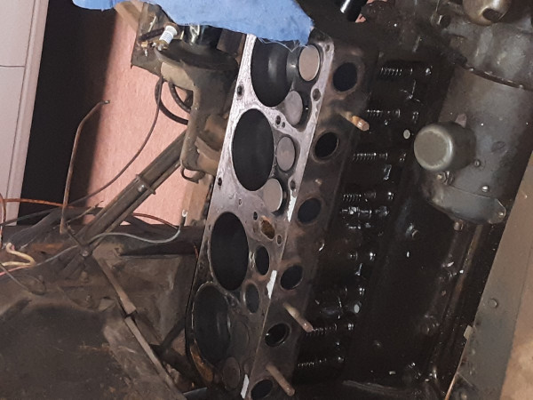

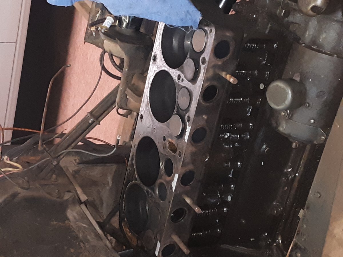

I’m unsure about why the valves are out of cylinder #3....the one cylinder that was firing.
And from the picture, the seats could use some attention.

I just had the same thing laped valves new exhaust manifold and aluminum intake new carburetor all new exhaust rewired NOS timer new plug wire to rewire the car and no power I found a intake leak was leak on the front port my friends said you have a valve sticking well no all have 45 pound of compression I replaced the intake with the stock one haven't had time to take it out yet but I think it's better
