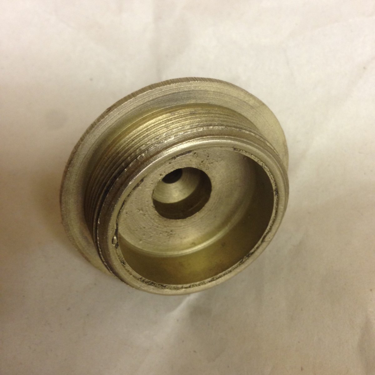

I need advice / tips / tricks for soldering the screen on the sediment bulb outlet.
cap is bead blasted and the edge is filed clean and shiny, but I can't get the solder to flow.
what solder are you guys using ? flux ?
what heating tool are you using ?

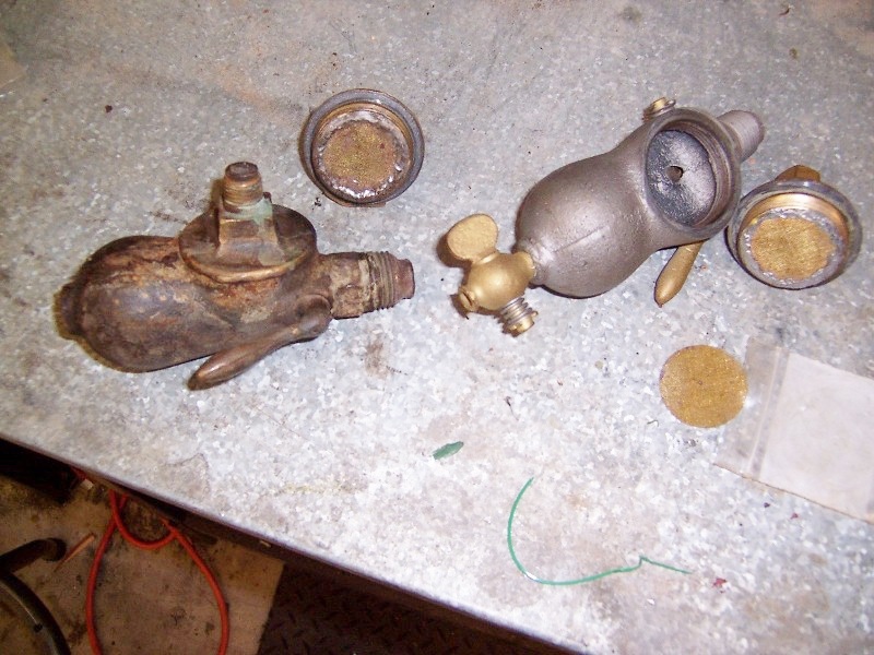

This is another one of those ‘how did Ford do it’. I’ve did it but it wasn’t a smooth as the original. Seems like I used solder that was used in Refrigeration work that had a good content of silver.

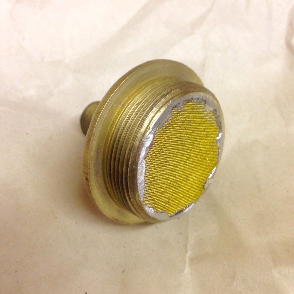

got it !
definitely not my best work.
I ended up preheating with my butane soldering torch, then paste flux, then wide soldering tip, sort of "puttied" a solder ring on the cap.
laid screen on, then put the wide soldering tip down on top of the screen, and kind of "puttied" all the way around, only had to add a little solder in a couple spots.
should've taken a picture, I got too excited and already put it back on the sediment bulb

my cap is iron, not brass
I used a propane torch at first, and then switched to my butane torch, and then to my butane torch with wide flat soldering tip. so...preheat, then preheat, then localized heat
getting the solder to melt wasn't my problem. getting it to stick was my problem. possibly a flux issue ? I tried two different fluxes, the second one worked...begrudgingly
I started with a bead blasted cap, then filed it, then sandpapered it

Looks pretty good. I’m thinking that when these were put together at Ford the guys doing the soldering had a certain method and some type of jig set up to solder the screen in. However they did it they got pretty good at it. Practice makes perfect and they certainly got a lot of practice doing it in mass production!

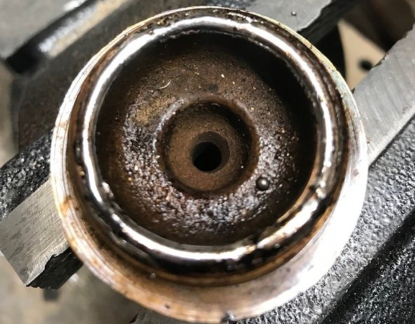

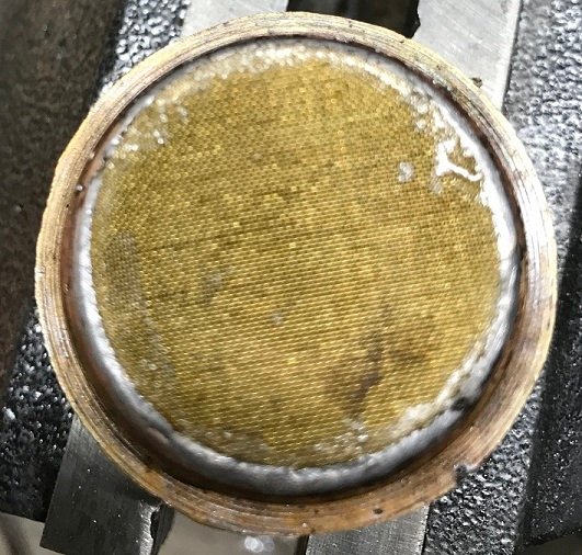

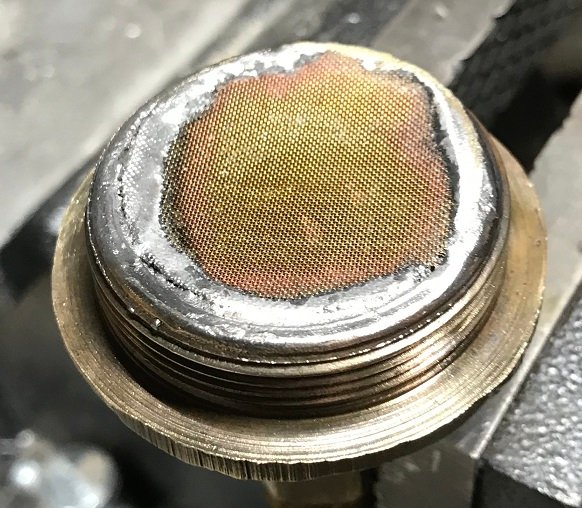

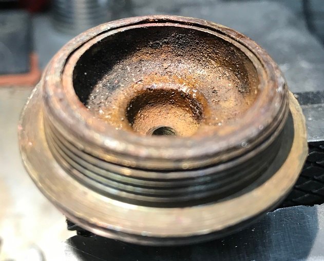

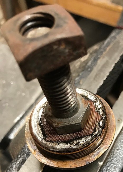

After reading this discussion I thought I'd take a shot a replacing the screen in a bulb I have. As I was pulling the old screen out I was surprised to see that it was held in place by a collar of brass folded over it. Maybe after cutting the threads the left a thin collar while machining out the inner surface to it could be folded over the mash. I put a fitting on the end of the screen cover so it would sit up from the vise jaws. I pried the collar up a bit with a utility knife blade by tapping it gently all the way around. When it appeared to move no more I quit.
Next wire brushed the entire surface.
A touch of flux I had laying around from the 1980's. Heated the cover from the bottom (Jerry's stove idea) with a propane source and when hot melted a bead of 50/50 solder around the edge.

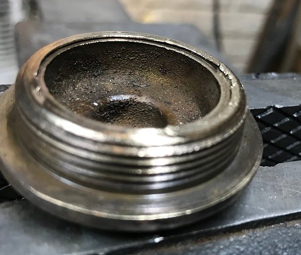

The mesh was slightly waffled like a spring washer (hindsight says I should have domed it). Rolled the edge of the mesh through a bit of flux and placed on top of the solder
To keep the mesh in place and to prevent it from melting I put a bolt on top of it. Re-flowed and let the mesh settle into the solder
- Posts: 6599
Re: sediment bulb screen - what's the trick ?
Done - still learning
