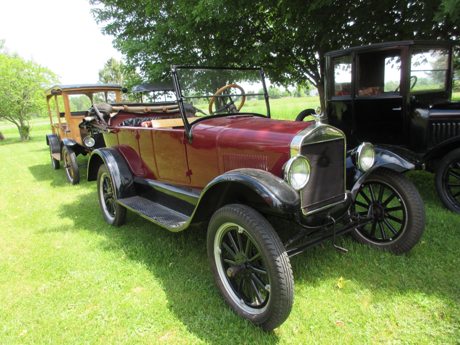

Should all of the electric horns sound the same, even the 1926/27. My 23 has a very distinctive sound ( kind of a BERRZZZE) as many of the Model T's I have herd over the years. I wonder if the 26 should have the same sound. I just got a 26 touring and the horn BEEPS. Will need to look for a new horn or it ok? Thanks in advance., John
