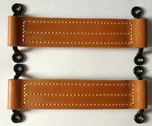

Yes a 17 would have check straps with the footman loops as shown. Material as I recall would be from leftover upholstery scraps.

My original 17 does not have footman loops. It has a very thick fabric strap. This is tacked behind the door cardboard and on the body it is fastened with 2 oval head screws thru a trim washer.

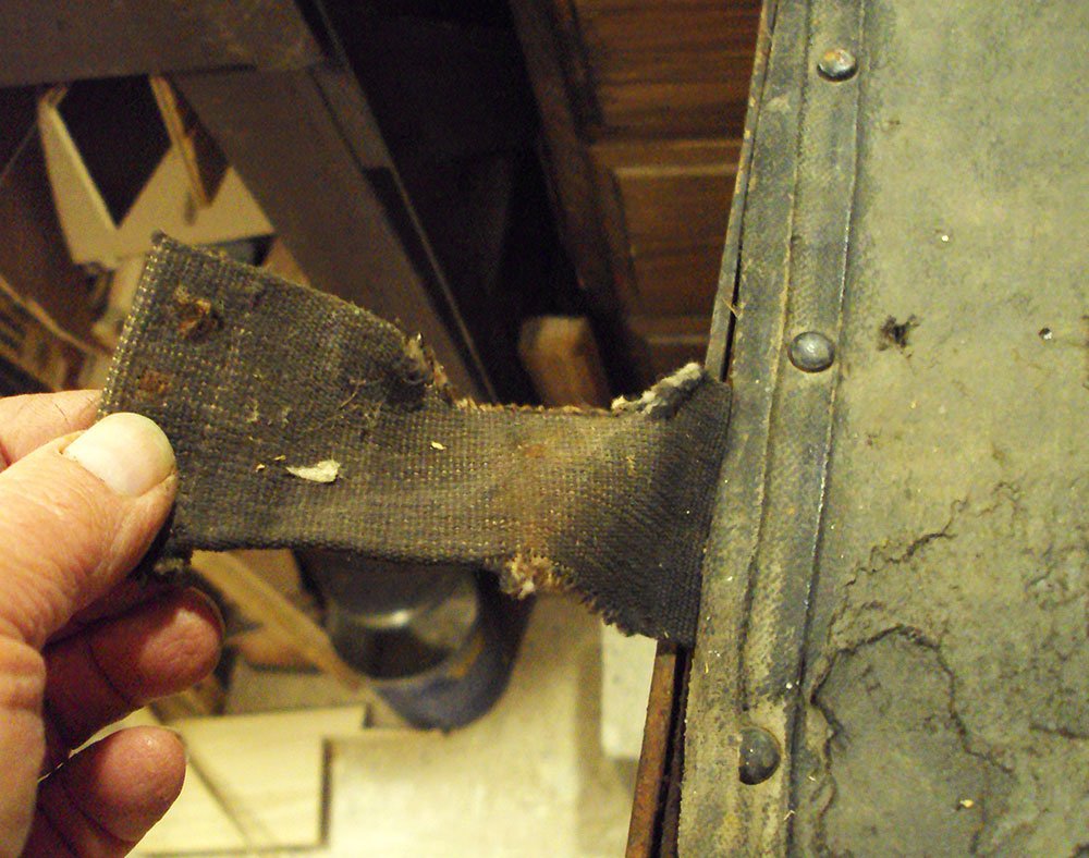

This was the webbing on a rear door. I thought it might be about 1924 but don't know for sure. It was tacked and about that long.
