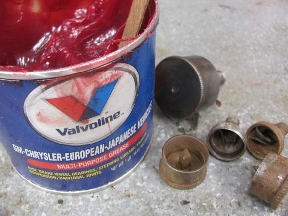

My friend and I were working on our Ts yesterday and while he was lubing the large grease cup on the U-joint he noticed the large prong? in the center of the cap and wondered what it was for. I removed the top of my cup and it also had one. We can not figure what its for. HELP! Thanks, bobt
