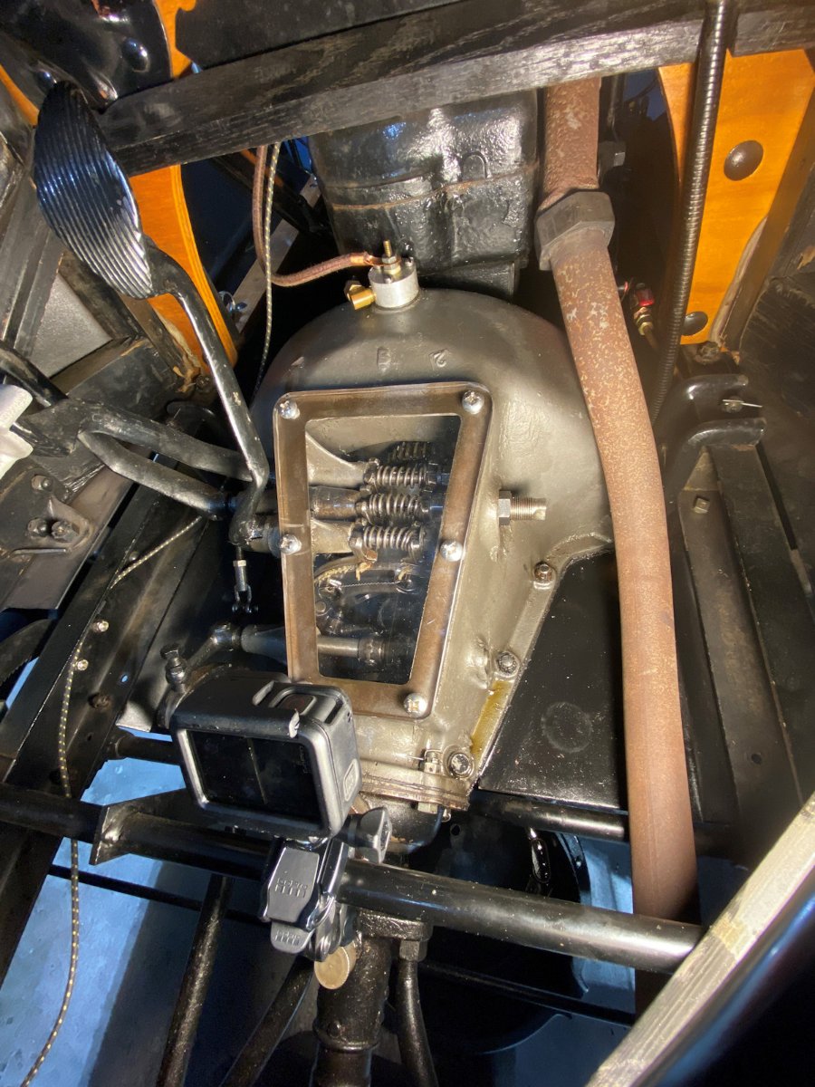

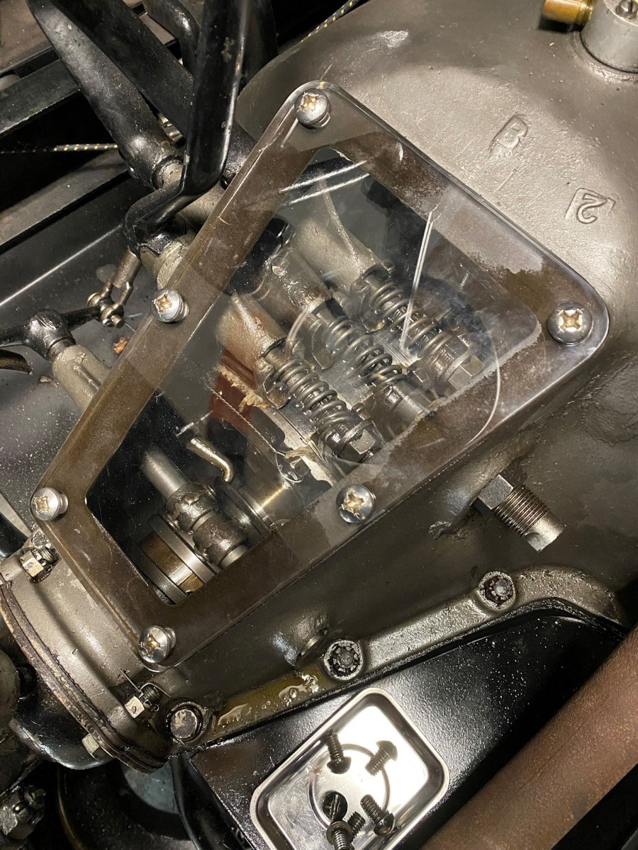

I'm only about 3 years into the Model T ownership world so i'm still a bit of a newbie. While doing events, folks ask about how the transmission/brakes work (as you are all well familiar with both the questions and the answers). I was thinking that it would be a cool idea to make a temporary Plexiglass replacement for the transmission cover. As the saying goes, a picture is worth a thousand words and seeing it yourself is even better than a picture. So I made one.

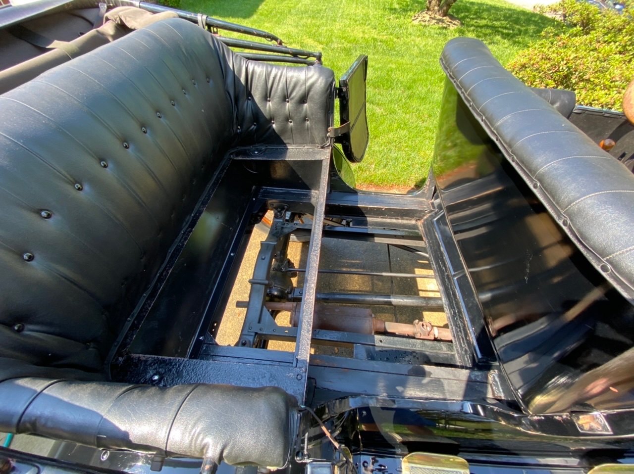

Then I started thinking, "What would happen if I started the engine??" A good buddy in our Model T club (Jay from Williamsburg) started egging me on do to it, so I did. I took video without the screen in and with the screen in.
After showing him the results, he noted that he had modified his screen and was wondering if it was any better. I took the drive up and we did the same video with his car. Last but not least, I decided to use my crappy video editing software and lousy skills to put them side by side in a video.
With that, here are the videos for your information, interest, boredom…whatever… 😉
This is my car without the screen:
https://youtu.be/2m-za3o-lWo
This is my car with the screen:
https://youtu.be/I1w2vFTRUvQ
This is Jay’s with the screen:
https://youtu.be/HnCsQO4Lj58
This is the side-by-side I just made of Jay’s and mine (there is no audio... note about the lousy skills... ha ha ha:
https://youtu.be/dXimnKoDPSI
There has been a lot of back and forth about this in my group already as well as on Facebook. Please play nice when commenting. :)

THANK YOU MAX, THAT IS VERY INTERESTING INDEED, INTERESTED TO KNOW WAS THE OIL UP TO OPERATING TEMPITURE ? would the hot oil pass thru the screen faster, yes i think the larger hole would allow smaller particals to pass through, even so, that screen is capituring a great amount of floaters that otherwise would have freedom to circulate, i like that idea with the magnet , makes one think can there be two magnets be stood on edge giving a larger surface to collect floaters, with that clear cover you could see if this would be possable, thank you both very much, great food for thought.
JohnM
Posts: 752
Last Name: Michaelree
Location: st louis
Board Member Since: 2010
Re: Transmission Oil Video
Post by JohnM » Thu Apr 30, 2020 11:20 am
:idea: Very cool! A picture IS worth a thousand words. Next would be to drive it and show the transmission in action. Reverse, low, and high. :idea:

Very well done experiment, indeed ! It seems that when those accessory oil screens first appeared on the market, the screen holes were quite larger than what's currently made and I believe the small screen holes result in holding more oil which is quite apparent in your video and possibly could be the culprit in oil leaks at the ball cap area due to the large reservoir of oil holding back there ? I have a few "era" screens that are 1/2 the length with larger holes which drop oil onto the bands directly.

Without the screen, it appears that the drums are getting a continuous flush of oil, possibly keeping them relatively cooler. If I were to modify the screen at all, I would put more or larger holes on the upper part, and let the lower screen catch debris. What say you? :?:

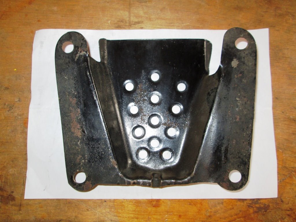

Post by RajoRacer » Thu Apr 30, 2020 2:41 pm

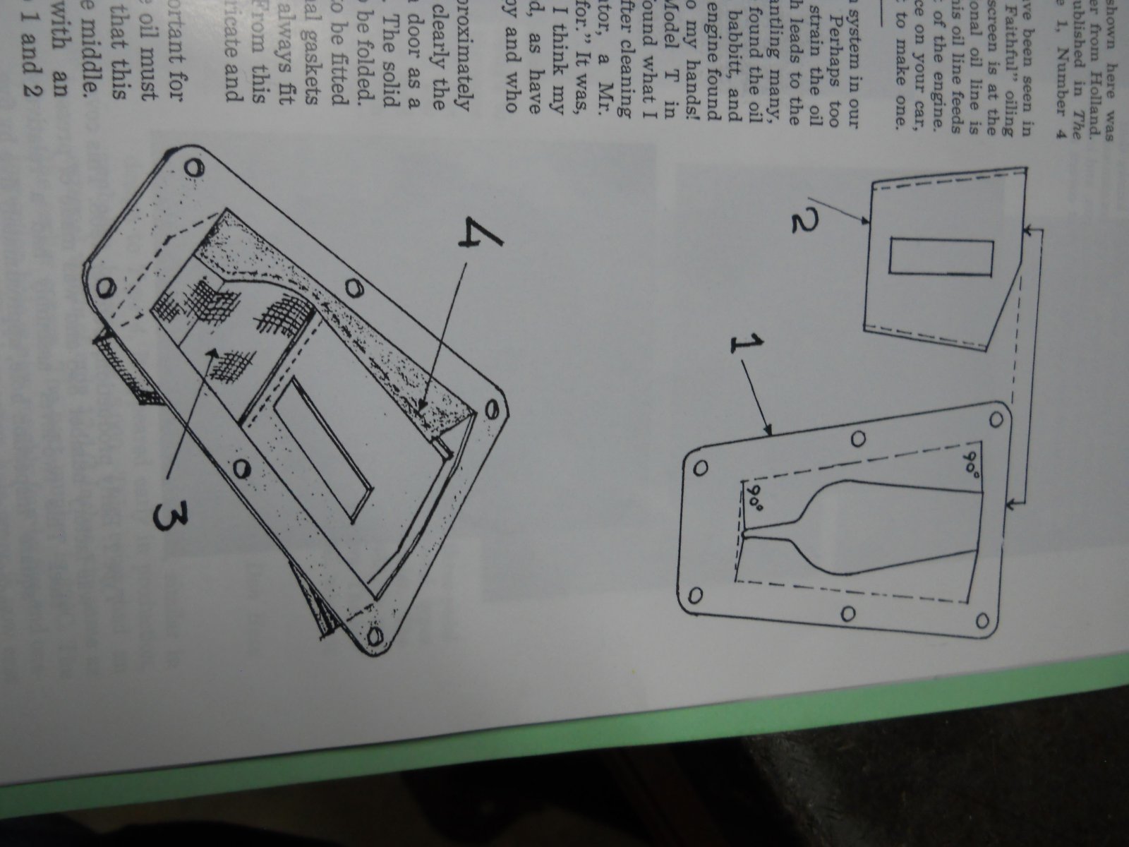

Here's an "era" accessory screen - note the small funnel at the rear end to let the oil not build up which considering the size of the holes, I can't see it being too helpful unless your oil was as thick as molasses !

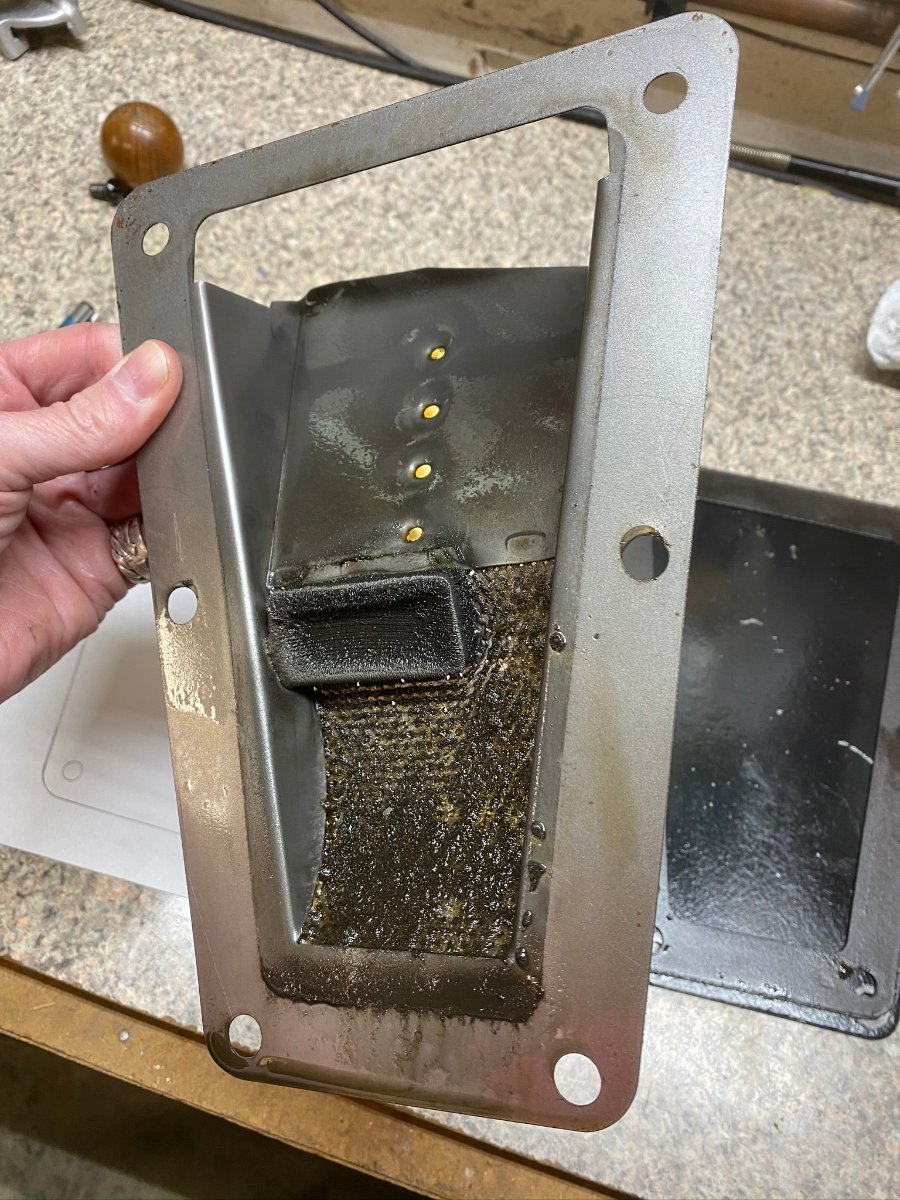

Next thought - on this same video, you’ll notice that my brake band is looking ragged. A guy from Lang's suggested that since the car sat for a while without being run, the bands may have dry rotted? This brings us to the conversation about the screen clogging. My big regret from this was that I cleaned the screen when I first pulled it out. I wish I had before and after videos with the dirty screen. I did manage to get a few photos of it beforehand and here’s what it looked like. You can see how caked it was.
As someone noted, the screen has a purpose, but if you don’t clean it, it may not be doing much. I agree that having a couple holes in the bottom section could be a good idea as long as most of the flow doesn’t go through them. Jay’s may be a bit too much flow through them. I think the enlarged holes at the top is a good idea.

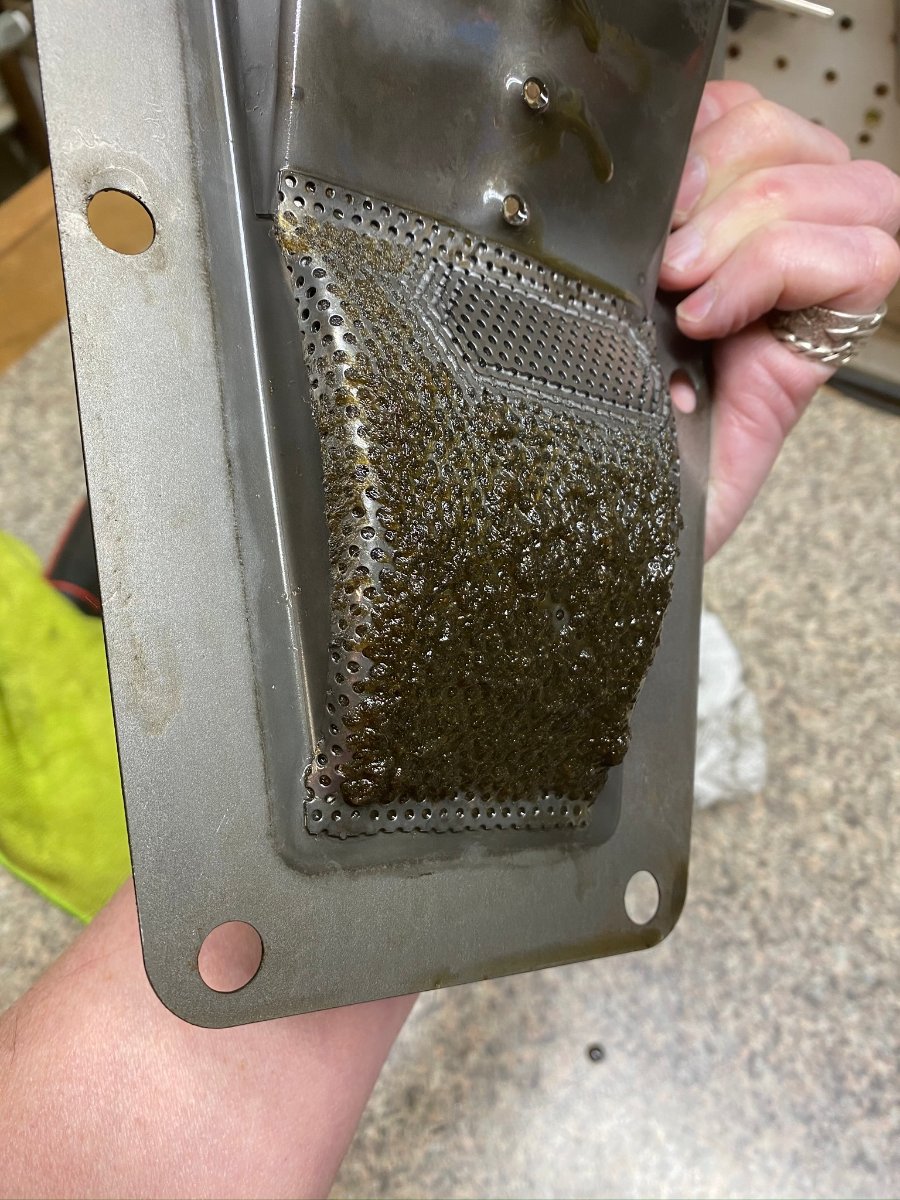

There are two lessons I learned from this that I think are important for everyone to understand:
1 - the screens do their job!... but!
2 - make sure to open the cover and clean them
Seeing the sludge in mine, I imagine there was a lack of oil going through the holes. As Mark from Virginia Beach said though, remember that the oil is also being slung around at the aft end of the transmission by the clutch knuckles....

I’m with you Jerry. I’m debating on whether to a a single larger hole as far aft as possible. That would only be able to handle so much oil and the screen would still be getting a lot of business.
I think this is more than speculation, but I’m thinking that rotating the magnet so that it is parallel to the car is better than perpendicular. If you look at that first picture (showing the underside of the screen), it is clear that the holes under it are blocked off by the magnet. By rotating it, the magnet would leave more room between itself and the dip allowing the oils to get under. Someone mentioned this above: roll it 90 degrees in addition to rotating it would open more holes. I’d think another positive would be that more magnet surface are would be exposed. The negative would be that the obstruction forces the oil to flow around it and increasing chances of picking up junk in the oil. No sure if there would be enough room between the magnet and the plate either.
I wish I had a picture the first time I pulled the cover after adding the screen and magnet. I’m thinking with great lighting and a really good lens, a picture could have really show the alignment of the iron dust/filings that collected on it. It was a rounded square of slime and that slime was the iron impregnated in the oil (better said, the oil stick embedded in and around the filings. A guy across the street is a great photographer. I may mention it to him to try to get his interest. I’d bet you could get a good picture showing the dust aligning with the magnet.

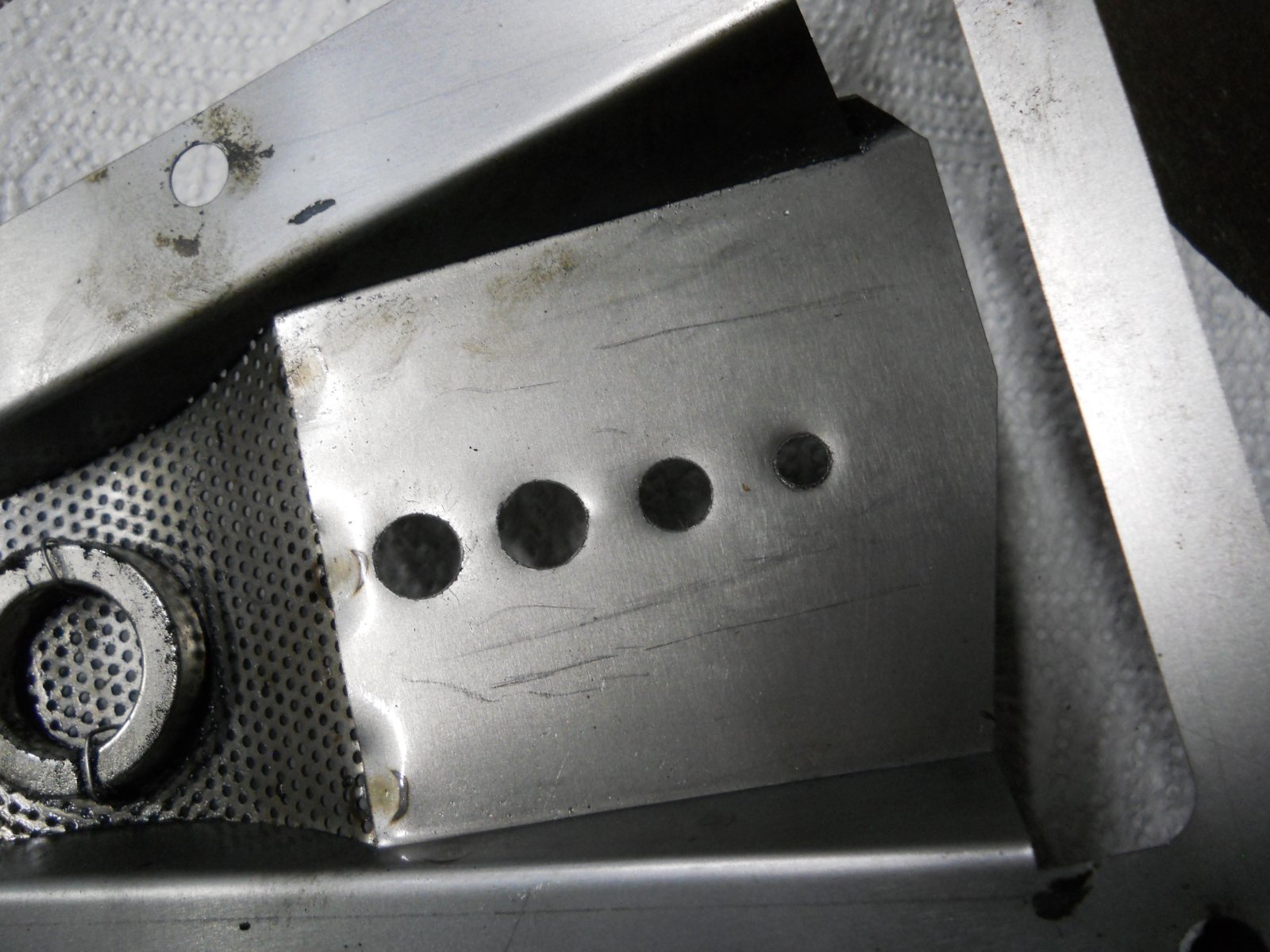

Update for my post ...I drilled two of 4 holes in front to 5/16 and 3/8, the 3/8 hole is directly over the brake band....I drove the car warmed the oil came back to shop removed the cover as fast as I could (under a minute) and used my laser temp meter and temp was 154 on brake drum the other 2 drums were 142....also replaced magnet with one of those high strength ones safety wired in place...rl

Post by MadMax » Sat May 02, 2020 6:14 pm
Great that you got out there and did that! When you changed magnets, did you us one of those 'rare earth' ones that could hold a sherman tank to a steel beam? :lol: I'm curious to see what it will catch.
I'm liking the idea of the and additional hole or two in the far aft corner/edge of the screen. LIke someone said, the screen will still get business, but oil will get out in higher volume.
Did you take temp readings before the holes were made? I would have forgotten (just like I should have done the video before I cleaned my screen!).
Anyways... here are two more videos to check out except this time the CAR WAS MOVING. :D They are hard to really see too much, but you can see the clutch start rotating. The lighting is a pain and I need to try it again with the top up to stop the glare/reflection... then I could likey get a handheld light to get the right lighting. Of course, this is all while trying to drive the car by myself. Ha ha ha
https://youtu.be/wBXTSqmdYL8
https://youtu.be/3G5SxOqBKZw
I was really expecting the clutch to throw a lot of oil around, but hardly any did and the oil that did likely was oil that dripped from the clear cover plate.

yes, I did use a neodymium magnet...I was thinking about switching the magnet about 10 days ago and in searching the forums found hank lee's post about the death of his magnet and damage it caused....that is when I ordered the HyPo new magnet and as luck would have it a few days later I read your post on your screen....that made me think why not make the brake band hole larger....Great idea and it made my brake drum run cooler....Ok, you won't believe this but what started all this for me was I needed to adjust my brake band ...I drove my car down a long hill and had a lot of brake fade so I pull it in the shop and took temp of brake drum...over 380 and reverse and low were around 100 cooler so I think your holes were the answer...temps taken with a cheap Harbor Freight laser gauge...I kind of told the story backwards but you get the idea.. :lol: rl

Today, I pulled the cover off my roadster to adjust the brake band. There was some crud on the magnet and on the screen, but nothing major at all. I enlarged the 4 holes to 1/4, 5/16, 3/8 and 3/8. Then I enlarged 3 rows of the small holes, in the deepest section, out to 5/64. I am still concerned that the screen is acting as a shield and redirecting oil away from the drums.

Scott, im to old to get under my dash, or i would see if there is a posability of some sort of deflecter that might catch oil tossed by the flywheel, perhaps under the screen, that would direct more oil at the bands, i woudn't think it would need to be very big,one, a slot that would run cross ways just over the bands with a bit of a dam to slow the flow somewhat, just thinkin,

I’ll see about running with the screen in. Today was a cleaning day!

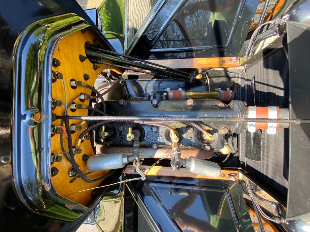

Just to stray a bit that is an interesting set up with the explosion whistles is this for a louder sound or do you get an offset or two tone explosion,just curious Cheers Colin

I am going to drill 2 more holes out to 3/8 and might decide to bring one even up to 1/2....and a note if you look close at the video you will see the screen area dumps into the rear of the transmission mostly on the clutch spring area and not on the bands that is why I did not enlarge any holes in the screen area and will keep it for a filter... The holes to enlarge are the ones in the front they drop oil on the bands...another note in the transmission book put out by the MTFC is a drawing of a screen with no holes up front but a rather wide slot.....rl

richard, all I can tell you is my rear brake drum was hot and I had brake fade....I drilled holes bigger and installed a magnet with a hole in it was able to get more oil to the rear drum and Now I have better brakes ( not as good as my F150 but better) rl

My screen has the slot as in Randy "s picture

I installed the screens this winter when I rebuilt the rear axles. The roadster has not been driven very much. The coupe has seen some miles doing my "social distancing" videos. I need to pull the cover on it and adjust the brake band a little bit. When I had the cover off of the roadster, I contemplated putting the magnet on the bottom side of the cover. But, wondered if it would be very effective there?

I pulled my screen out and made final modifications drill out all holes to larger size and cleaned my hy-po magnet....
Posts: 6801
Post by Scott_Conger » Tue May 05, 2020 4:46 pm
Scott
I you'd lose surface area of the magnet. Make darn certain that it is located such that it is captured by the screen restriction and cannot in any way migrate into the engine. Myself, I'd leave it sitting on the mesh. You retain surface area and due to line contact to the curved surface, I think you lose very little filtering area.
Halftrack
I think that's a sensible mod.

The magnet is one of the super strong ones and is 3/8 thick so it can't get out of screen ... it is so strong I have to pry the top cover off...it may be too strong ...but did you notice I have it wired in place....If I decide I don't like the screen like this my next step is to cut a slot like the mtfc tranny book picture..
