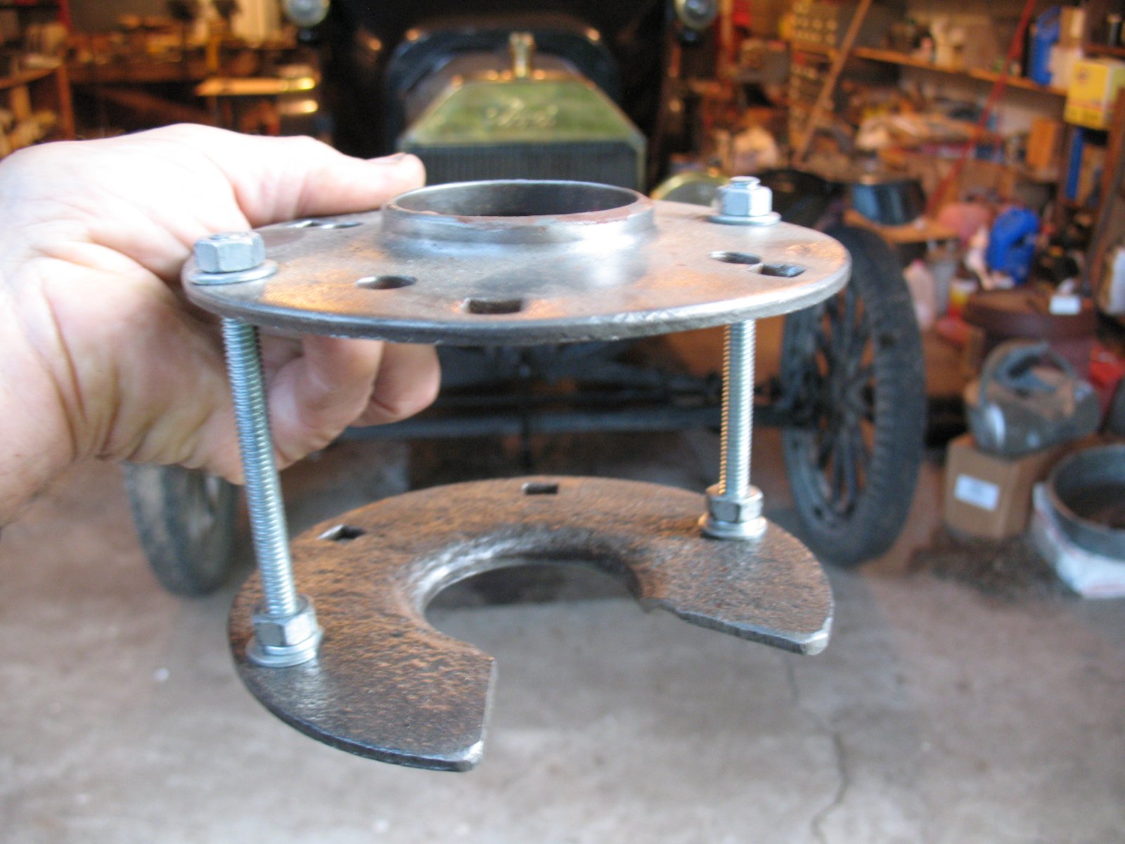

Springs on the bands, or clutch spring? If it's the clutch spring, this works.
Made from a pair of junk hub plates.

The clutch spring compressor that Steve posted works pretty good. I also made one like it a few years ago. Seems like it came from one of the tinkering tips ideas. Much easier for me than compressing it by hand which I use to do. Good use of extra T parts too!

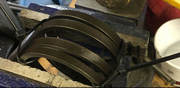

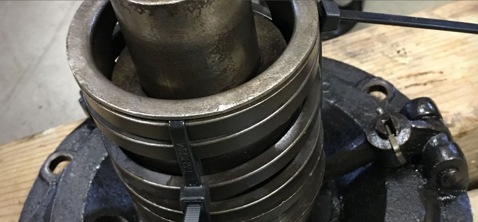

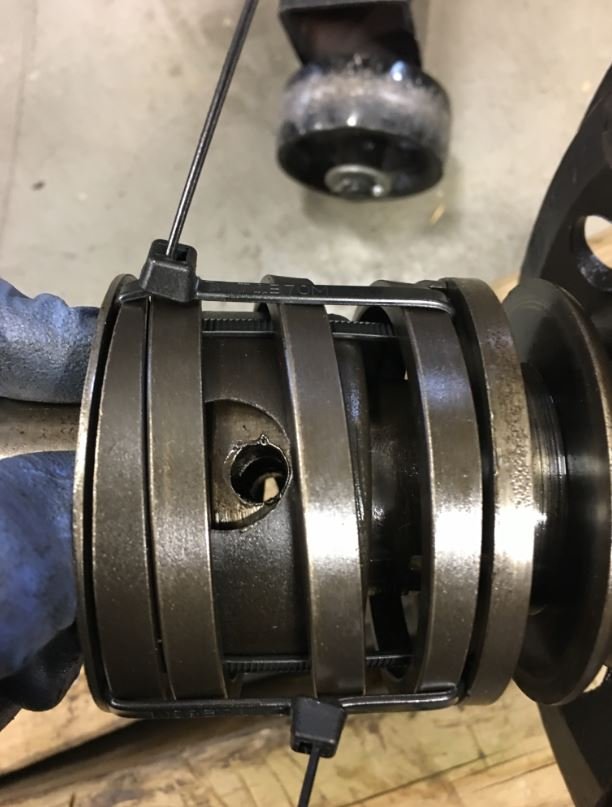

Finally I found another way to install the transmission spring, similar than Norman idea...
See bellow with pictures, Took less than 2 minutes ...

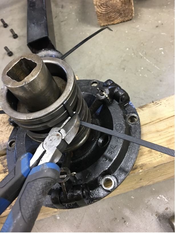

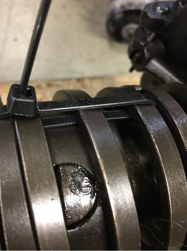

Topic author - Posts: 1202
- First Name: Mario
- Last Name: Brossard
Re: how to install/remove a transmission spring
Cut and ready

The zip tie application is a great idea! Thanks for posting that, jb

And is cheap... for time and money
