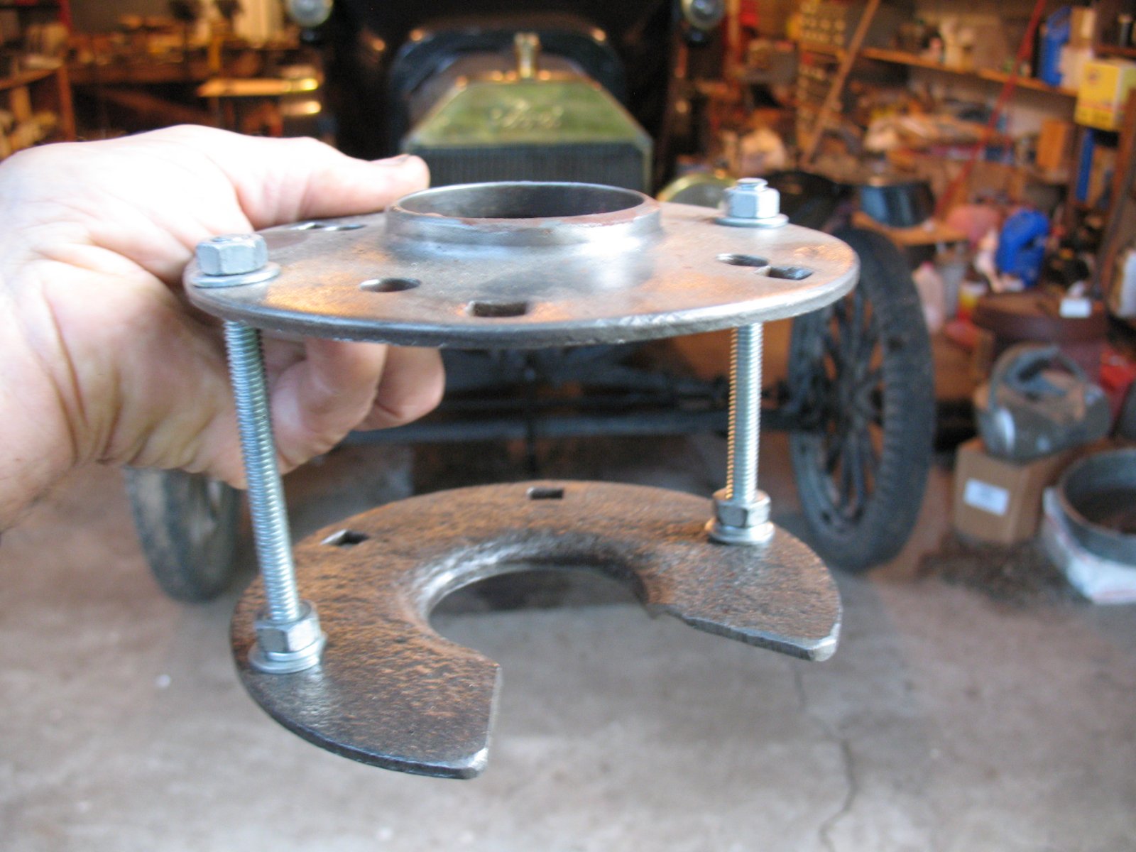

Springs on the bands, or clutch spring? If it's the clutch spring, this works.
Made from a pair of junk hub plates.

Thank you Steve,
Exactly what I'm looking for!

The clutch spring compressor that Steve posted works pretty good. I also made one like it a few years ago. Seems like it came from one of the tinkering tips ideas. Much easier for me than compressing it by hand which I use to do. Good use of extra T parts too!

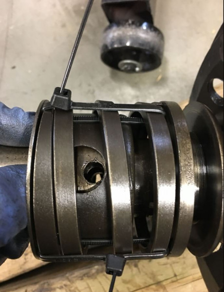

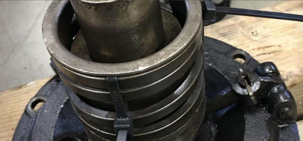

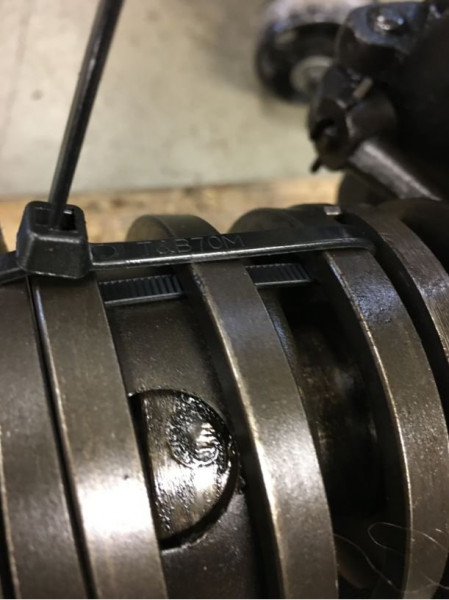

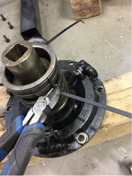

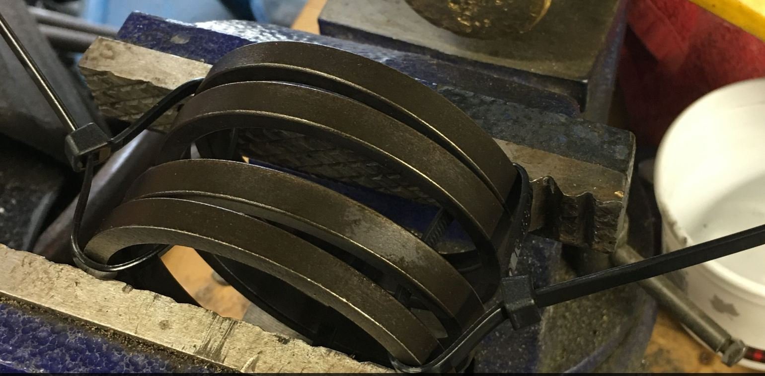

Finally I found another way to install the transmission spring, similar than Norman idea...
See bellow with pictures, Took less than 2 minutes ...

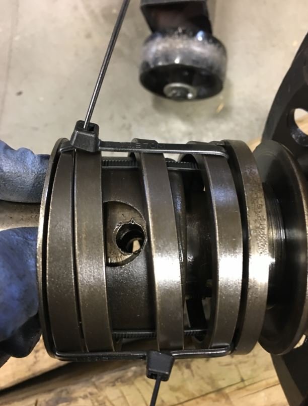

Post by Quickm007 » Mon May 04, 2020 4:16 pm
Cut and ready

The zip tie application is a great idea! Thanks for posting that, jb
