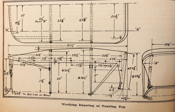

This sketch is from Feb. 1922 Ford Owner Dealer, so likely a sketch of the touring tops of 1920-1922 so it should be helpful. Dimensions from center lines.
click to enlarge
click to enlarge

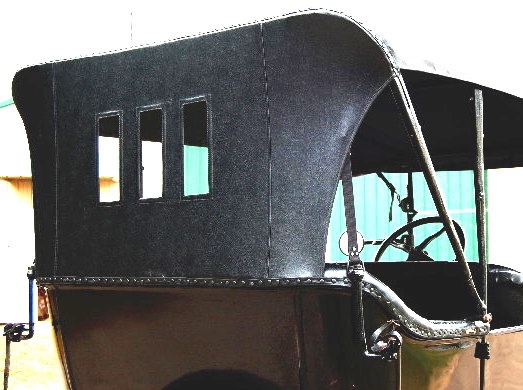

This install, by a previous forum post, shows that D-ring on the rear top L prop rod, anchoring the end of the strap, the other end is looped thru that footman loop on the wood bow.

Thanks for all the help. when I attach to the bow do the footman loops go on the lower end and
I couldn't tell from the diagram (probably me) but about how far from the curve or the center do you attach the footman loops?

The drawing that Dan posted shows 20-1/2" from the centerline of the top to the center of the footman loop. That is confirmed by the factory drawing of the top.
No exact measurement is given, but the factory drawing clearly shows the loop approximately centered top to bottom on the inside surface of the rear bow.
