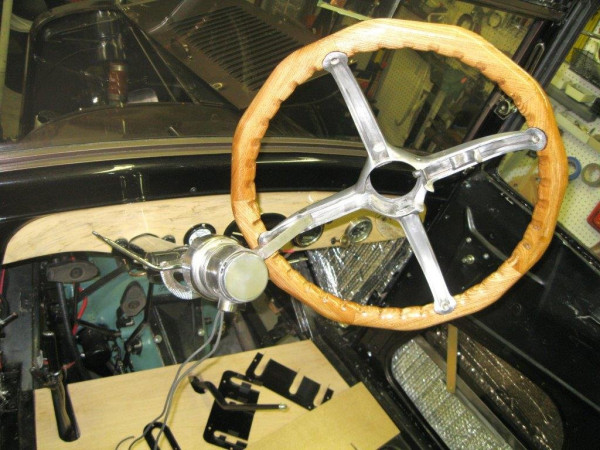

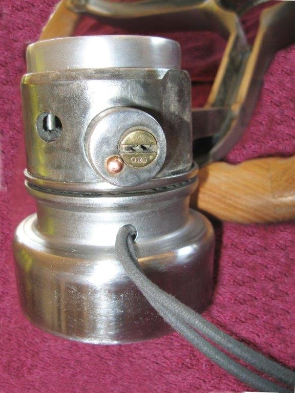

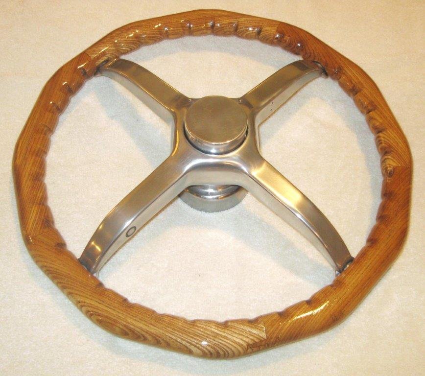

I have a Guardian Fatman steering wheel, locking, and horn. The horn works.
The attachment Guardian Wheel Sales 1 1920 Ford Model T Guardian Tilt & Non-Tilt Steering Wheel Brochure 407x494.jpg is no longer available
If you want more information let me know.
Art Taylor (sportbingo)

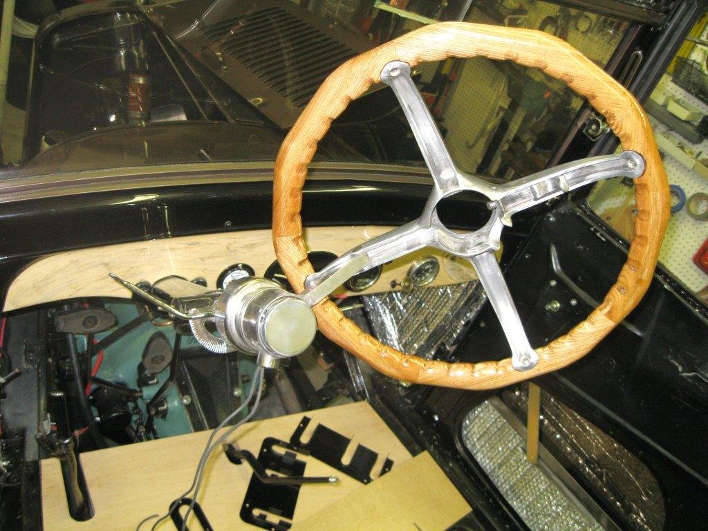

Another picture of the Guardian.
Guardian Wheel Sales 1 1920 Ford Model T Guardian Tilt & Non-Tilt Steering Wheel Brochure 407x494.jpg (34.53 KiB) Viewed 2503 times
