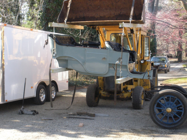

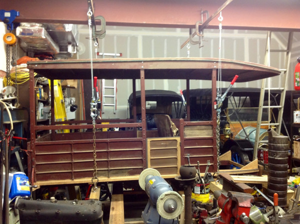

Here's one way
- Posts: 466
- First Name: Val
- Last Name: Soupios
- Location: Jupiter Florida
Re: Good Idea's Needed!
Here's another

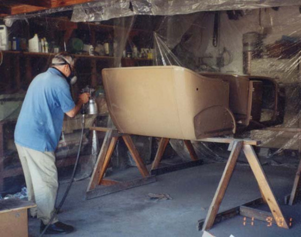

This is what I did with a 26 touring. I think it would also work with your earlier body. I made two horses out of 2x4's just high enough to be able to roll the chassis underneath without hitting the horses. The only picture I have is shown of me painting the body but to put the body on the chassis, I would turn it 180 degrees from that picture and roll the chassis under, rear axle first. Two men can lift the body up and set it on the horses.
- Posts: 4658
Another thing I should explain. The top horizontal 2x4 is set into a notch but not nailed down, so after the body is above the chassis, that end of the body is lifted up by 2 men and the 2x4 removed and the body set back down on the chassis. It only has to be lifted a few inches and lowered an inch or two to accomplish. This setup also allowed me to get under the body to paint the underside as well.

Norman, I think that is a brilliant idea! I think I'll be building a pair of specialty horses soon.

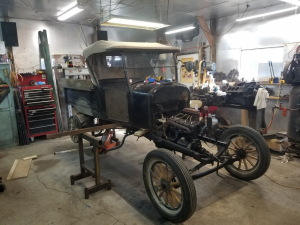

I removed my runabout body by myself. 3 steel stands and a jack. I raised the rear and put a stand under the bed. Then I started blocking the cab until I could get the bar on the steel stands along side. I let the jack down in the rear and rolled the chassis out.

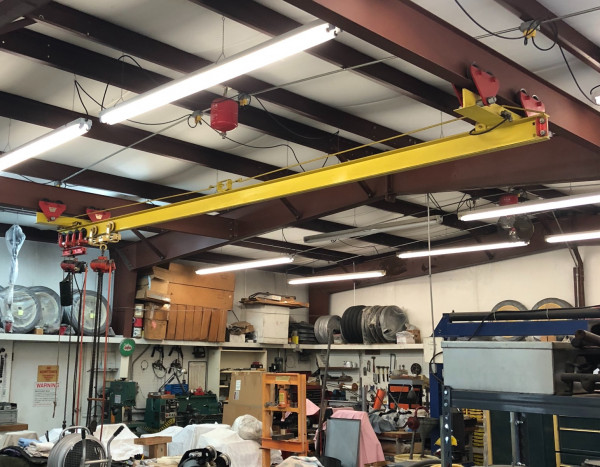

Years of seeing and doing without, I had ideas for my dream shop to include an overhead system to assist me. Since I am by myself about 95% of the time, it sure does do the job. Will lift a ton easily.
