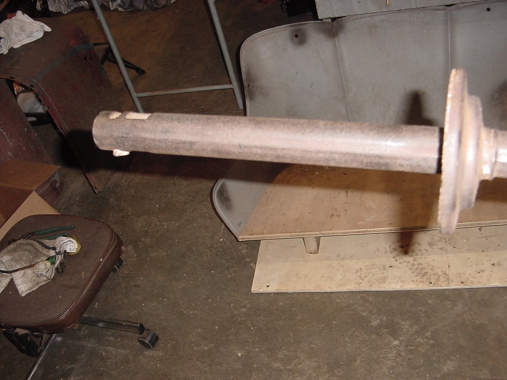

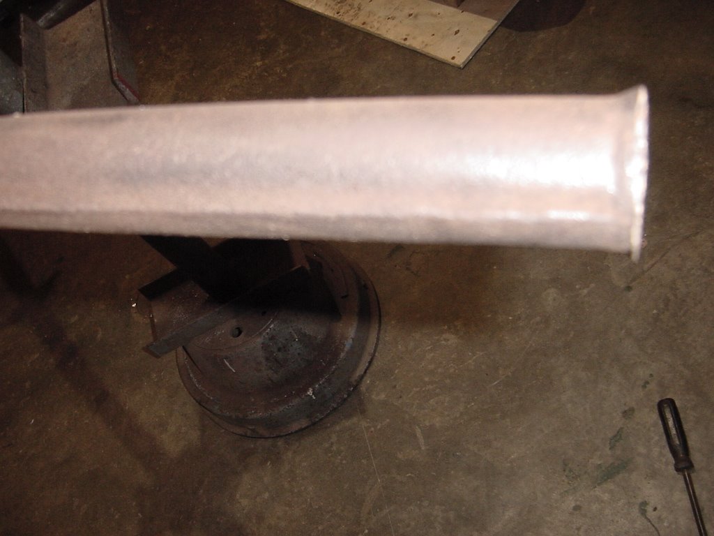

Your exhaust pipe is original later pipe #4037C with the muffler built in the pipe, that front flange holds the 2 additional muffler shells, and then you need to add the end cap, by inserting a long enough bolt thru a metal cross plate which will extend out those two rectangular openings, and attach large cup washer and then a nut. Just like Ford made 'em. The seam is electric weld seam of the rolled tubing, factory Ford T.

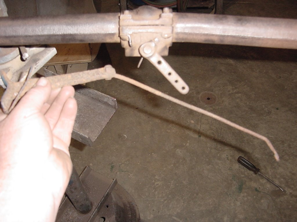

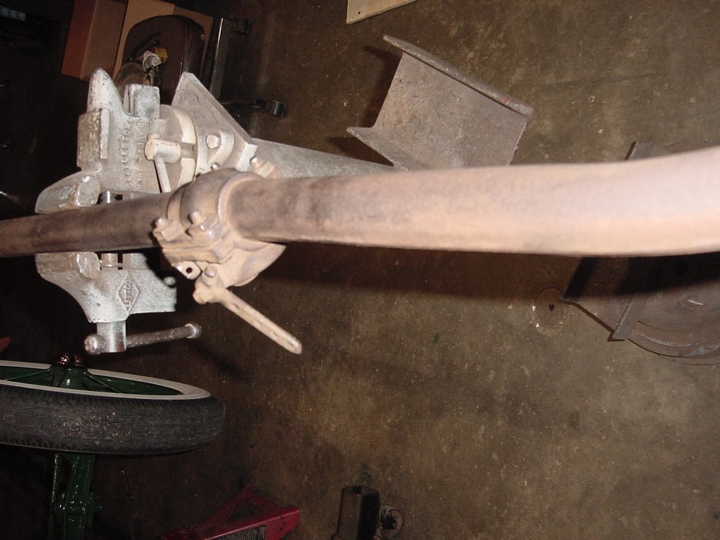

For the cut-out, here is old time method of hook-up.
IMG_5007 - Copy.JPG (122.6 KiB) Viewed 2908 times

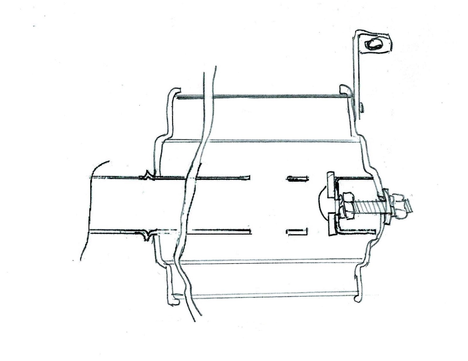

If you can gather an original end cap, then Lang's sells the shells only, #4025S should work, saving you $35 over a new muffler w/shells. Or get the whole thing, 4025B, the shells should be good, you only need the 2 outer, the pipe you have is the inner, just don't get the version with the welded ends.. :(
Making the bolt, finding a washer and nut is easy.
Sketches by David Dewey
