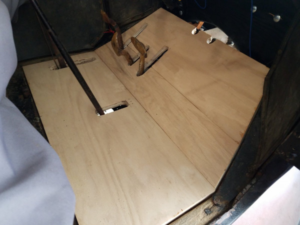

I've rebuilt a floor for Dorothy and would like to find a good sealer from the weather that is also somewhat heat resistant to the exhaust!
Looking to see what you smart folks have had luck with.
Here is a picture almost finished.
Thanks!

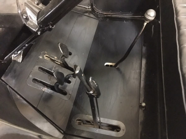

Brian, Looks like you custom made your floorboards, and I notice your pedal openings are non standard. All Ford floor boards had the reverse cut out the same as the other pedal cut outs. Also, the pedals move sideways as they move forward, make sure there is adequate side clearance so the pedals do not bind at full throw. The wood between the pedals is thin and weak, the Ford solution was to add a metal plate that provided some additional strength, they were offset slightly to provide an interlocking function to keep the two floorboards from shifting, and also provided a decorative trim. Shifting and binding floorboards are a safety item, those trim plates are not optional in my opinion.
Regarding a sealer and heat protection, neither is needed, any black paint will do the job.

Brian, I like the grain on your floor. It would be unfortunate to cover it. The original floor was still in my ‘26 coupe, when I bought it in 1970. The only finish it had on it was 44 years worth of dirt. Jim Patrick

Humble, thanks for the input. Pedal openings are not standard. I did have my daughter test the pedals once the boards were installed and I seem to have clearance where I need it. I suppose a quick trip around the block will reveal if any other trimming in necessary. I've seen the kits that reinforce the area between the pedals and think I may fabricate a reinforcement.Humblej wrote: ↑Wed May 06, 2020 7:21 amBrian, Looks like you custom made your floorboards, and I notice your pedal openings are non standard. All Ford floor boards had the reverse cut out the same as the other pedal cut outs. Also, the pedals move sideways as they move forward, make sure there is adequate side clearance so the pedals do not bind at full throw. The wood between the pedals is thin and weak, the Ford solution was to add a metal plate that provided some additional strength, they were offset slightly to provide an interlocking function to keep the two floorboards from shifting, and also provided a decorative trim. Shifting and binding floorboards are a safety item, those trim plates are not optional in my opinion.

Thanks Jim. I like the looks of the natural wood also, but I'm concerned about water penetrating the laminate. This car is driven is all sorts of weather and, especially with an open top, will likely see ALOT of water here in the PNW.jiminbartow wrote: ↑Wed May 06, 2020 10:37 amBrian, I like the grain on your floor. It would be unfortunate to cover it. The original floor was still in my ‘26 coupe, when I bought it in 1970. The only finish it had on it was 44 years worth of dirt. Jim Patrick
