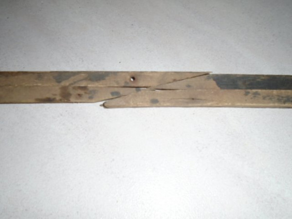

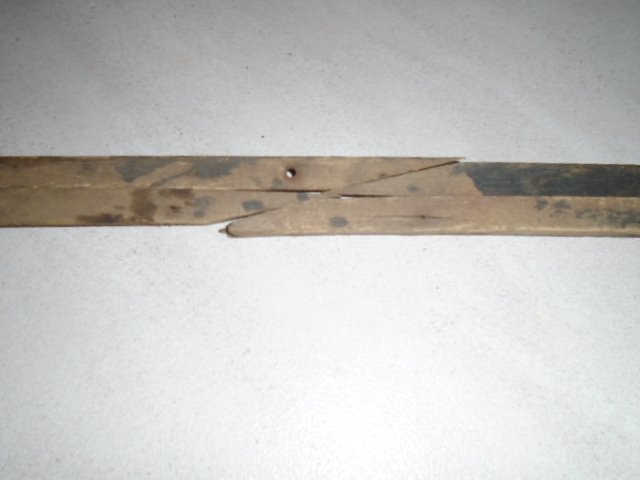

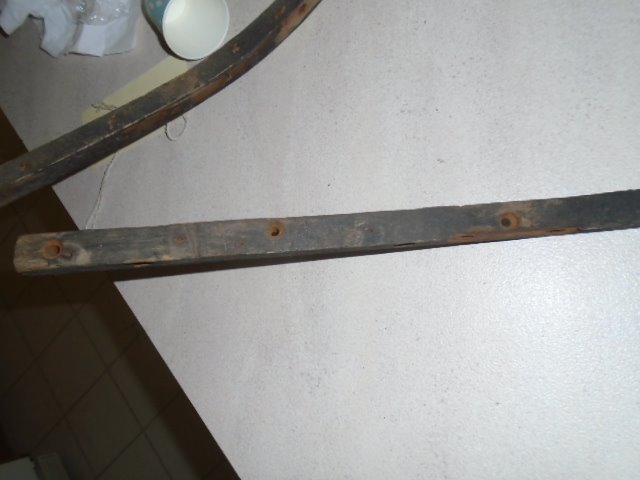

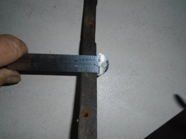

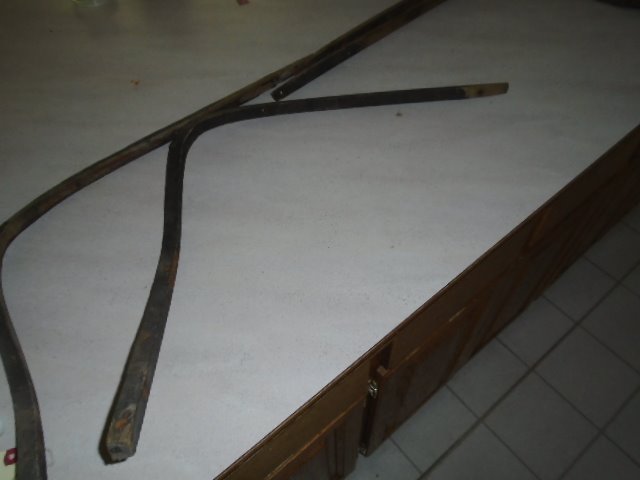

All very, very helpful. A lot to digest. Looking at the profile of the strip on my car, it appears to be square. I don't know if it is original. Does anyone know what the profile of the tack strip is supposed to be on a 1917 Touring? I know some cars have a tack strip with a rounded edge. I did acquire the metal strip that screws to the trim strip and doesn't seem to conform exactly with a square strip.

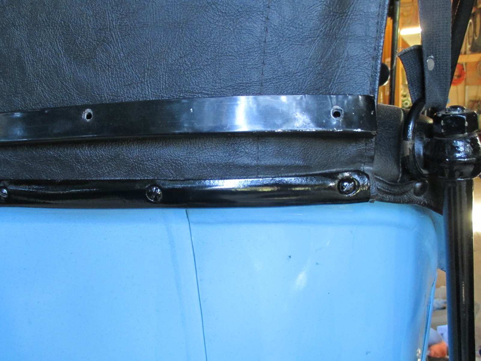

Post by KWTownsend » Sun Apr 26, 2020 11:46 am
Tim,
If I remember correctly, the tack strip is 3/4" square.
I'm glad you have the metal piece for it. The correct term for it is "rear curtain to body retainer." It is often simply called the 'rear curtain trim.'
You are correct the rear curtain trim is more of a C shape than L shape, but that is so there is a little extra room for the top material,
Here is an original which replaced my home-made trim.
here is an discussion about it from a few years ago:
http://www.mtfca.com/discus/messages/41 ... 1403715316
The rear curtain trim is held in place with #8 French head screws (oval) 3/4" long.

My Canadian 1915 tourer had square strips, approx 5/8" square. The body panels had a bead rolled in the top, and plain flat steel about 3/4" above the bead. That flat section was sandwiched between two strips which were bolted together using 3/16" metal threads. When the upholstery was fitted, it was tacked to the vertical face of the outside tack strip, and you could still see the underside. Laminated ply gives great rigidity, never splits, and holds tacks well.

I have 15 rear wood strips and they are made of four unique pieces of 3/4" material, inside, outside left and right. These are salvaged pieces and I plan to design a mold and make myself a set.....

I don't know what's correct for a '17, but my '21 had a steel channel that the tack strip slid into. The tack strip was in 2 pcs., right & left. Each half slid into a channel with s "C" shaped cross section. The open side of the "C" was where the wood was exposed for tacking. There was very little left of the original "C" channel, so I made a replacement using hollow, square tubing. I cut open one side to create the "C". It was a bit heavier gauge than the original channel but added lots of strength to the seat back! You see many seat backs that are badly bowed out due to the lack of this reinforcement. The wood tack strip alone doesn't offer enough support and I'm guessing the poly stuff offers even less.
