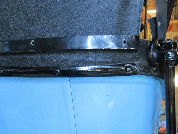

Tim,
If I remember correctly, the tack strip is 3/4" square.
I'm glad you have the metal piece for it. The correct term for it is "rear curtain to body retainer." It is often simply called the 'rear curtain trim.'
You are correct the rear curtain trim is more of a C shape than L shape, but that is so there is a little extra room for the top material,
Here is an original which replaced my home-made trim.
here is an discussion about it from a few years ago:
http://www.mtfca.com/discus/messages/41 ... 1403715316
The rear curtain trim is held in place with #8 French head screws (oval) 3/4" long.
Please let us know which material you end up using.

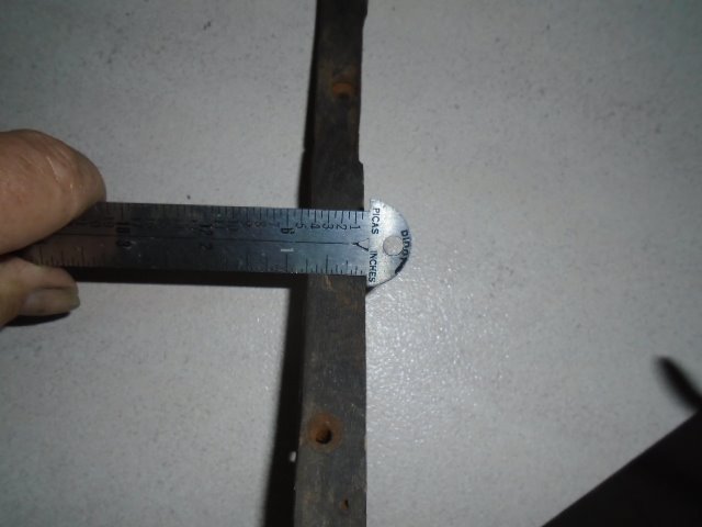

My Canadian 1915 tourer had square strips, approx 5/8" square. The body panels had a bead rolled in the top, and plain flat steel about 3/4" above the bead. That flat section was sandwiched between two strips which were bolted together using 3/16" metal threads. When the upholstery was fitted, it was tacked to the vertical face of the outside tack strip, and you could still see the underside. Laminated ply gives great rigidity, never splits, and holds tacks well.

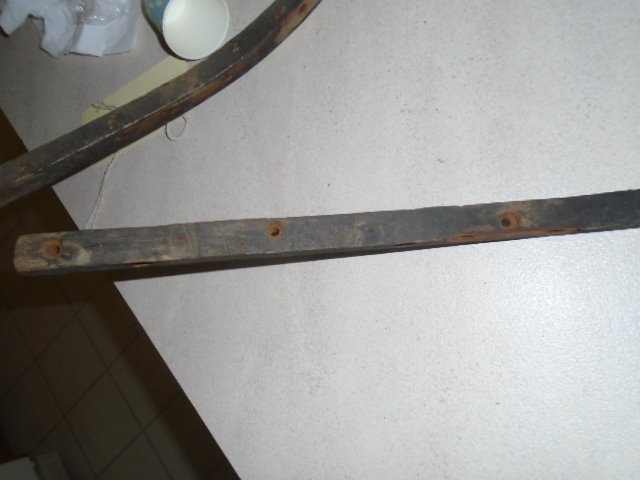

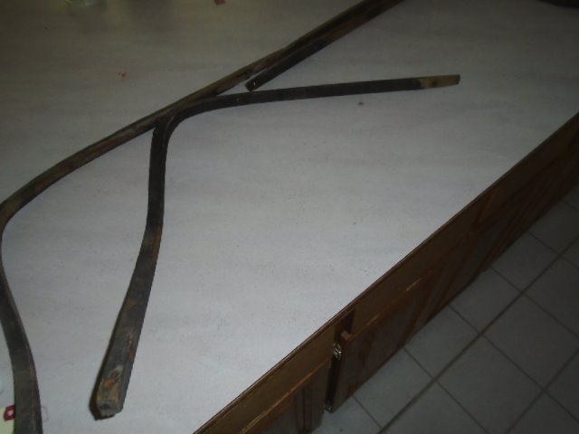

I have 15 rear wood strips and they are made of four unique pieces of 3/4" material, inside, outside left and right. These are salvaged pieces and I plan to design a mold and make myself a set.....
