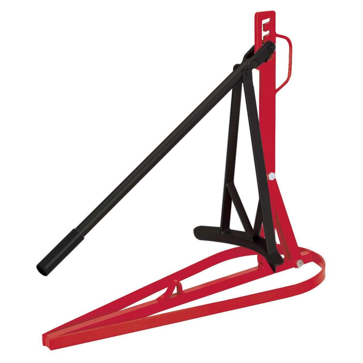

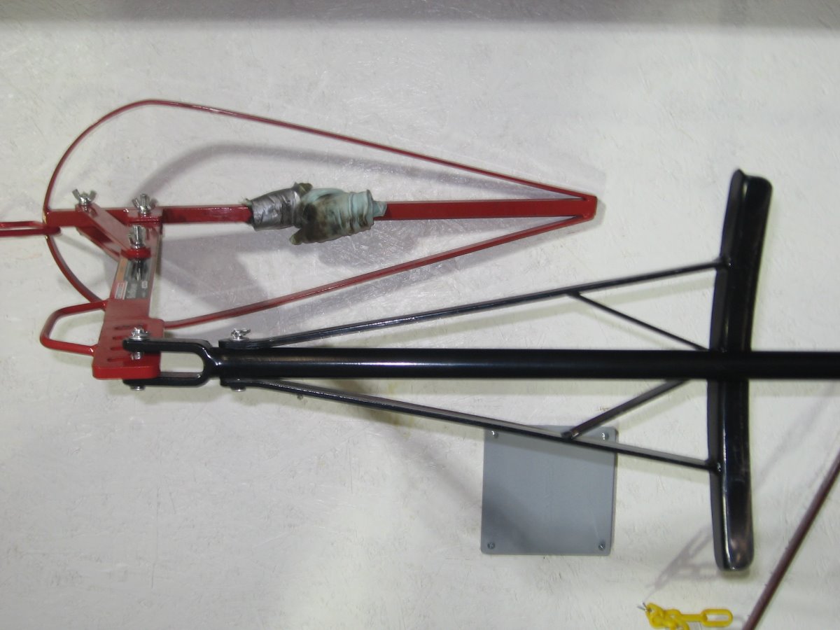

I have purchased and use a Harbor Freight Tire Bead Breaker, Item # 92961 that is $54.99. It works well and hangs on my shop wall when not in use.
Sorry for the rotated image of hanging bead breaker. It is soooo difficult to get it to hand sideways.

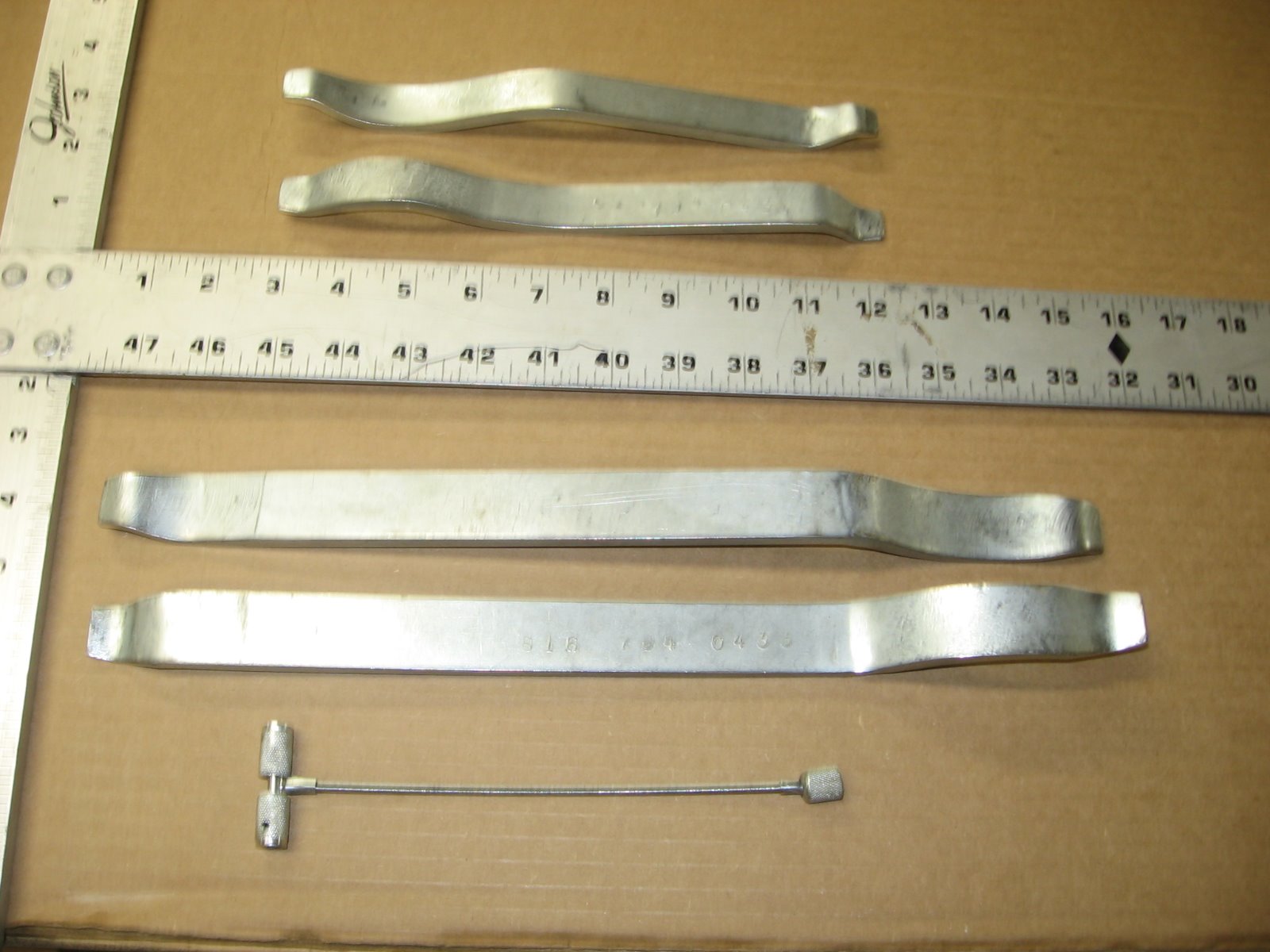

Also there are sets of tire Irons, (short 10" $40.00 and long 16" $50.00), sold by Bud Jonas of Belding, MI 6one6seven94zero433 that are excellent, in my opinion, so you don't ruin a tire in the process of removal or installation. I also recommend the valve stem puller to ease tire installation.

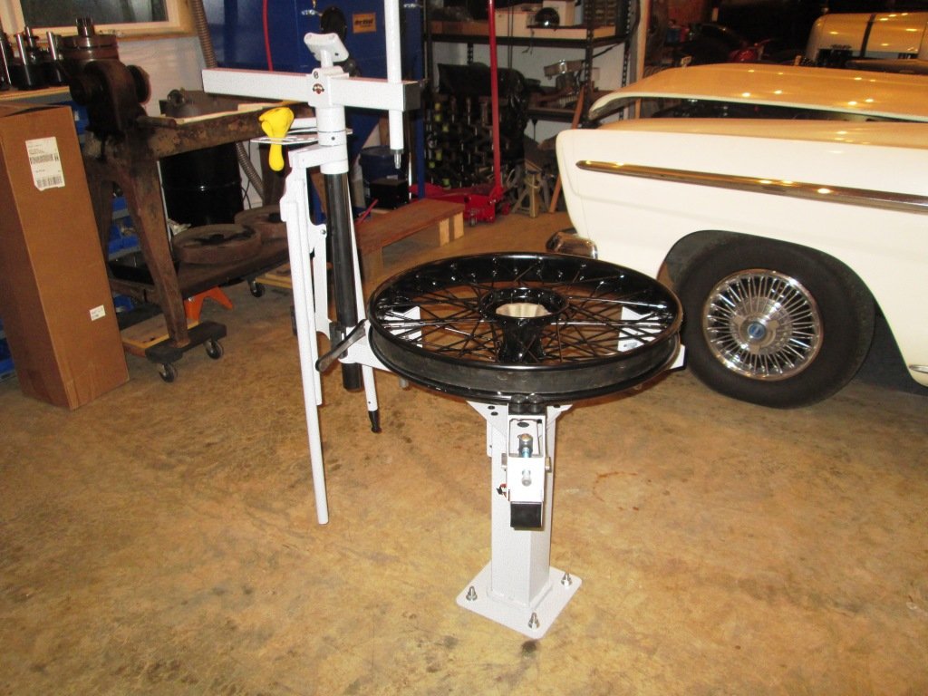

My knees won't take the abuse of the concrete floor anymore so I purchased this trick tire mounting machine & it has a bead breaker attached - even does wire wheels !!!
- Posts: 6819
Re: Breaking bead
Man, Steve, you have ALL the toys!
- Posts: 5602
Re: Breaking bead
Finally figured out to "work smarter - not harder" ! Been getting up & down off the concrete way too long !
- Posts: 5558
- Last Name: Hatch
- Location: Alabama
Re: Breaking bead
What make is that tire mounting machine? Thanks Dan
- Posts: 5602
Re: Breaking bead
"No-Mar" motorcycle machine w/additional attachments.
