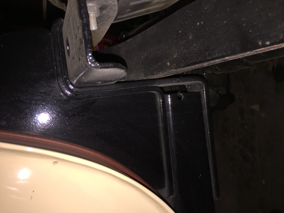

So I am was curious why no one produces rear lowering brackets for a 26-27 T? I've seen the brackets on eBay that Bill sales and they look great but was hoping to find a set for my 26. I understand the rear crossmember is different in the later cars but could a laser cut bracket be made and used for the later crossmember?
If anyone has any information on either the drawings for a bracket (early crossmember bracket will work) and instructions on where to cut the frame that would be very helpful.
Thank you

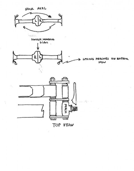

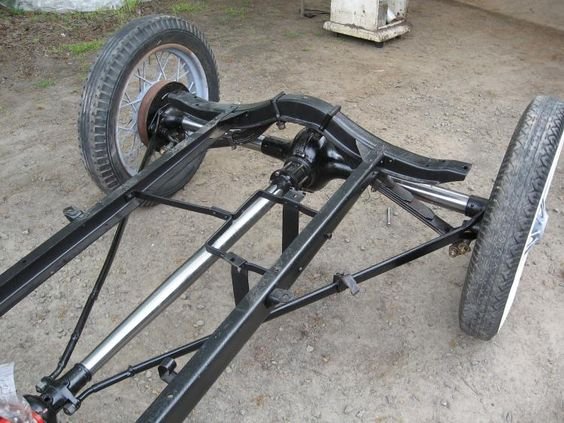

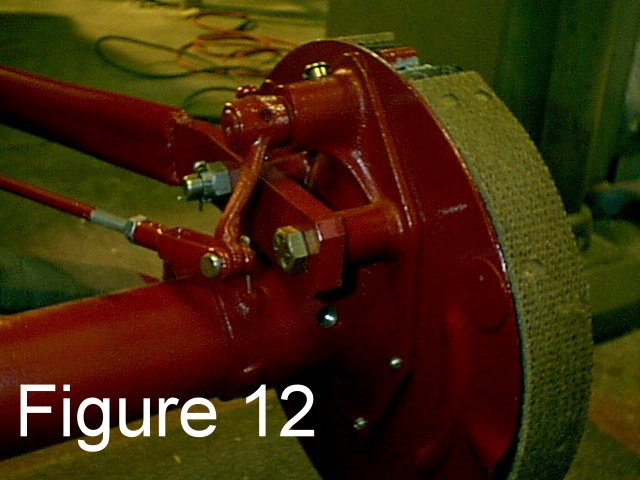

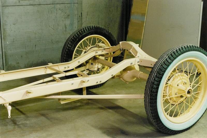

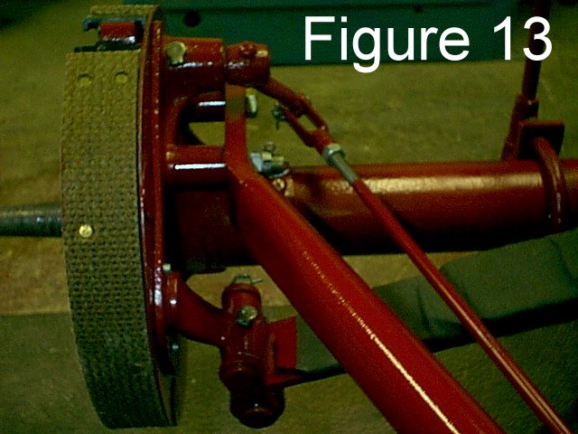

Other methods
Chasis rear.jpg (63.38 KiB) Viewed 6977 times
http://www.mtfca.com/discus/messages/80 ... 1242265839
tdump
Posts: 1430
First Name: Mack
Last Name: Cole
Location: North Carolina
Re: Rear lowering brackets
Post by tdump » Mon May 11, 2020 4:38 pm
Dang,I wish I had known about that method when I was working on the rear axle of my T. During the assembly that woulda been the time to reverse the houseings.

Was hoping to make a set like below but maybe with more drop

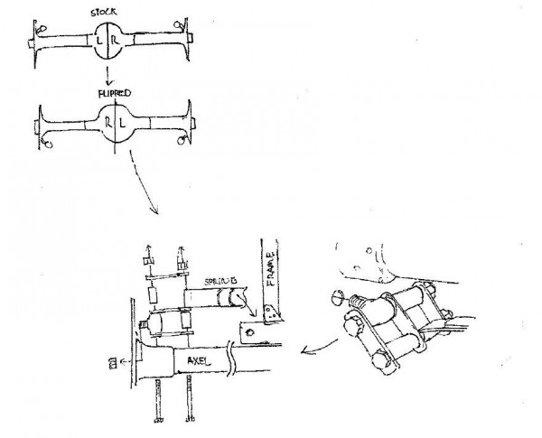

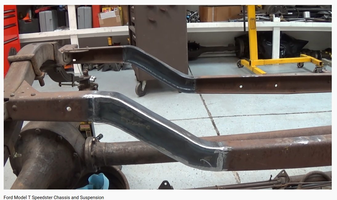

I was told by a speedster guy that the front drop should be slightly lower than the rear. More drop?
Good YOUTUBE Video drop front and back https://www.youtube.com/watch?v=wKtB6mmj6eY

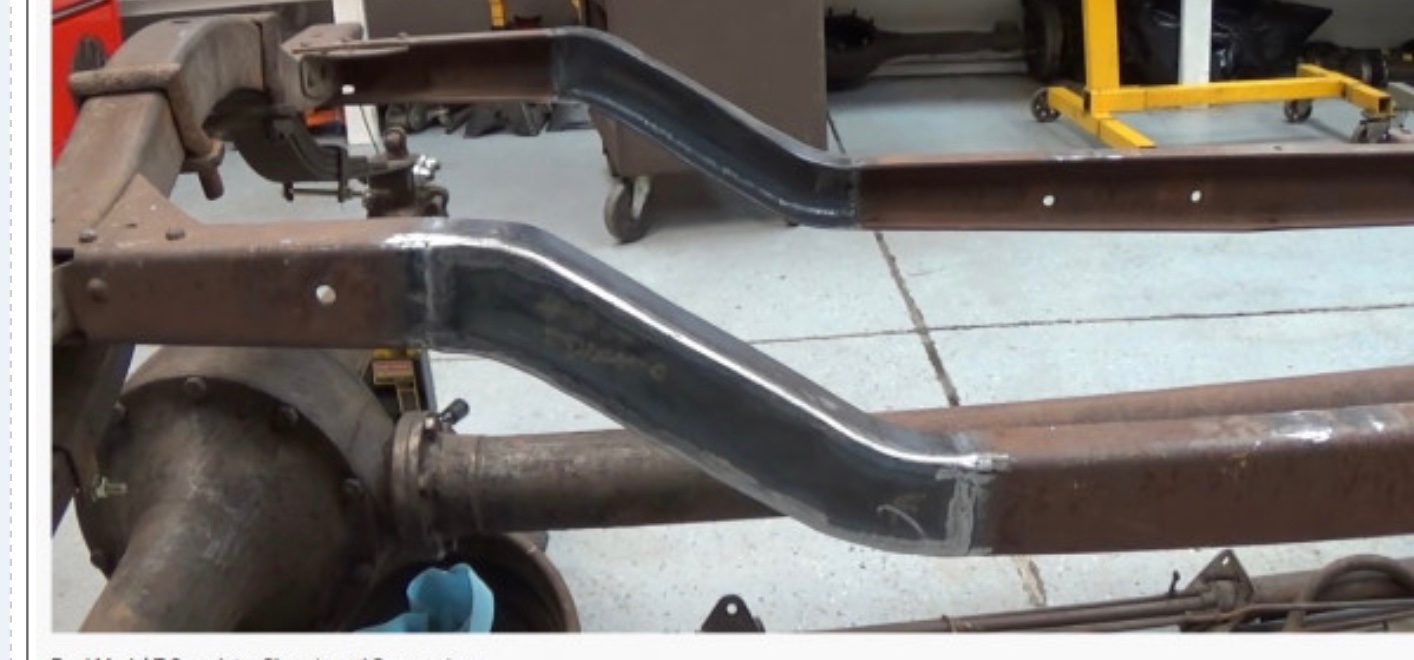

That 3rd pic that Frank just posted is the way I would have done mine had I not been iffy about cutting up a T chassis.The way I did things is reversable at whatever point it may be feaseable

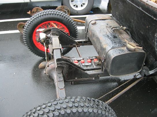

Lots of beat-up frames around that could be used - Z bracket needs frame cut. But is it advisable to weld vanadium steel like that (3 pic)

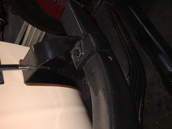

Post by Kevin Pharis » Tue May 12, 2020 12:23 am
The sweeping Z is a nice touch on an exposed frame, but can be in the way if you have to push the seats back to clear long legs. And can also be a bit sketchy if your welding skills are a bit... sketchy😬

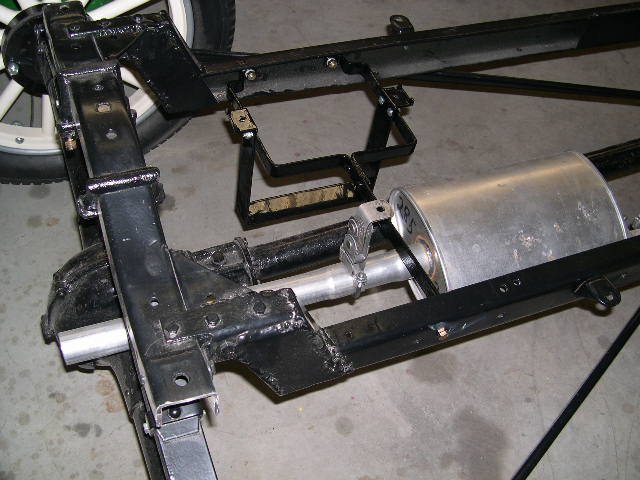

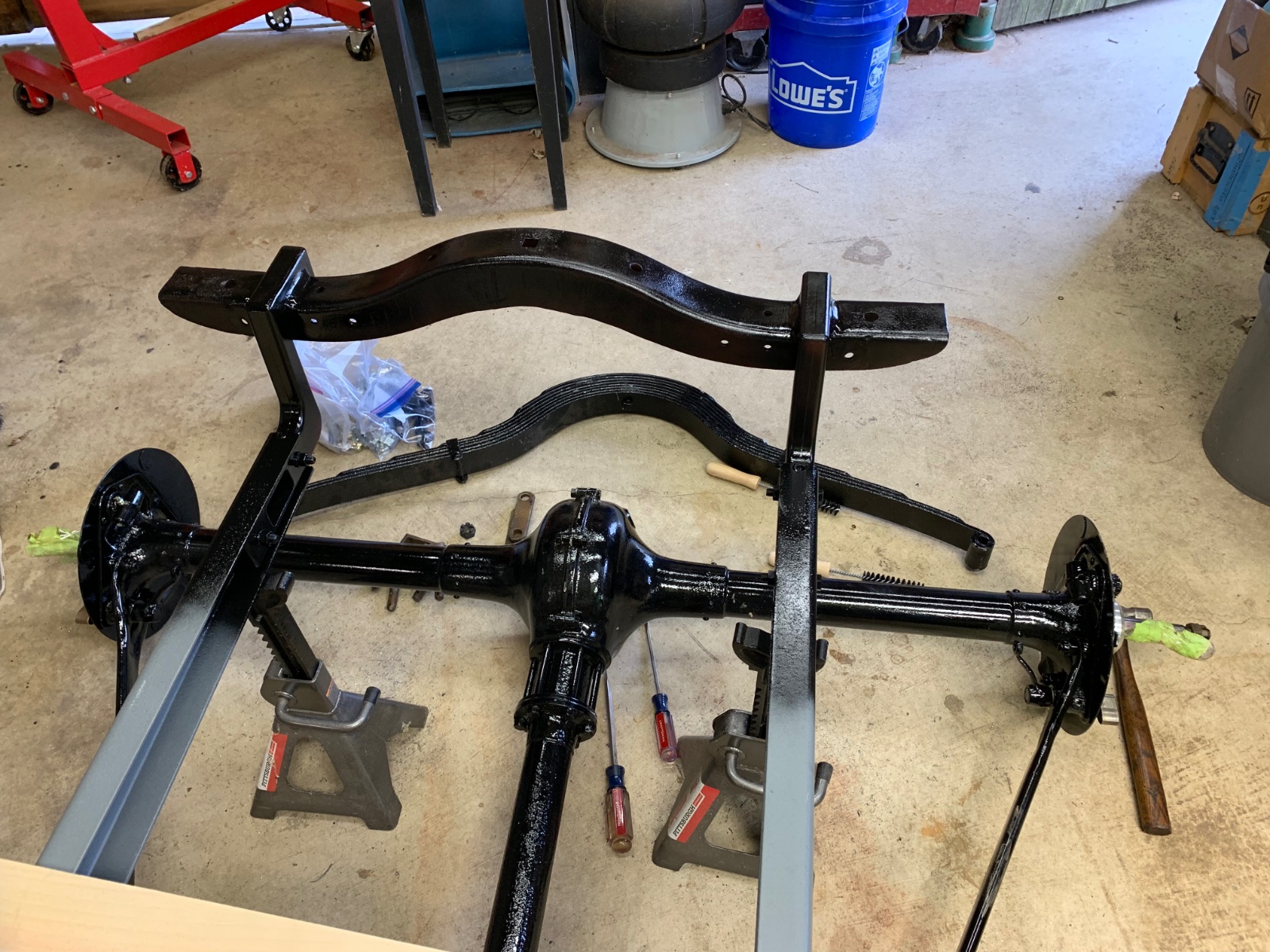

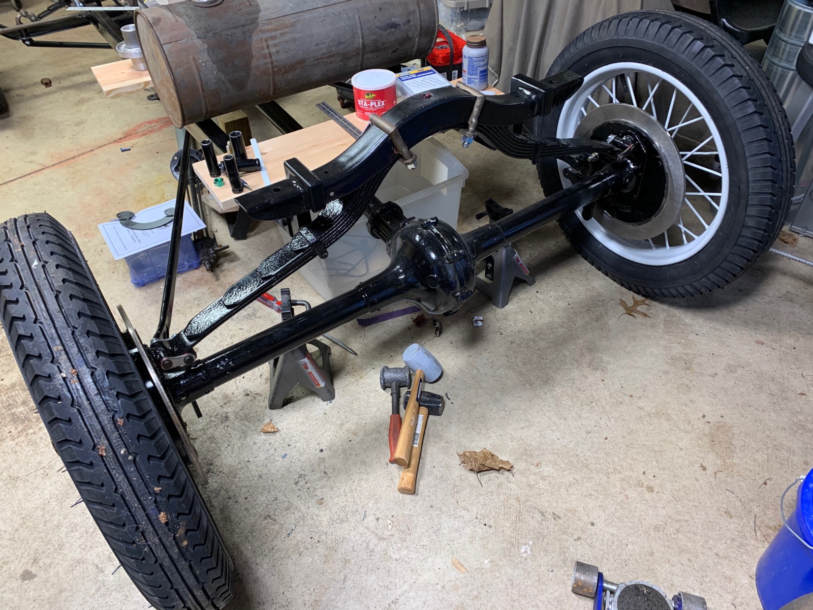

I went with a strap iron lowering brackets as I needed extra vertical clearance for my oval fuel tank. The brackets are bent up from 2 laminated strips of 1/4” thick strap iron that sandwich the top and bottom frame rails. The fuel tank brackets double as reinforcements for the lowering brackets. All bolted together...

Kevin
Interesting setup. Looks great.
Posts: 6592
Post by TRDxB2 » Tue May 12, 2020 11:10 am
Sweeping Z variant
Dropacent
Posts: 3384
Last Name: Morsher
Location: Norwalk Ohio
Post by Dropacent » Tue May 12, 2020 12:52 pm
I don’t think this example is very safe. I’d never let a loved one use it. I think it could be saved with added fishplate inside, outside or both. jMHO

Post by Kevin Pharis » Tue May 12, 2020 7:38 pm
BillyBobsSpeedShop wrote:
Tue May 12, 2020 10:42 am
Kevin
I had to figure something out as I didn’t have any 3/4” plate to torch the brackets out of... ;) :roll:

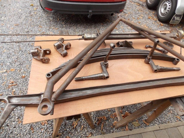

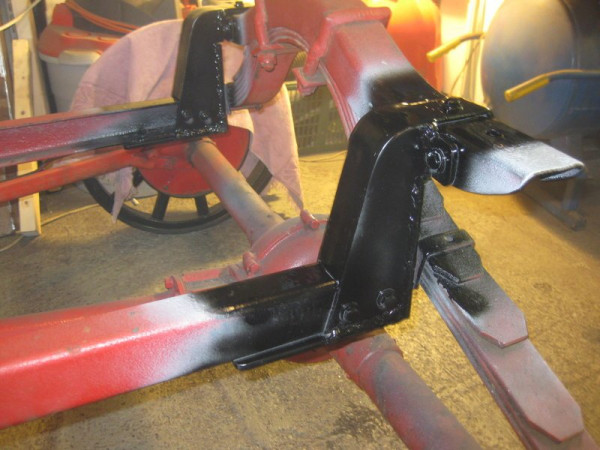

Post by AndreFordT » Wed May 13, 2020 2:33 am

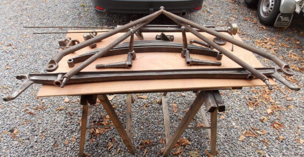

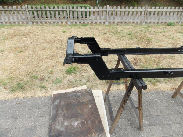

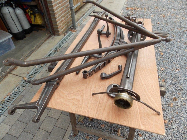

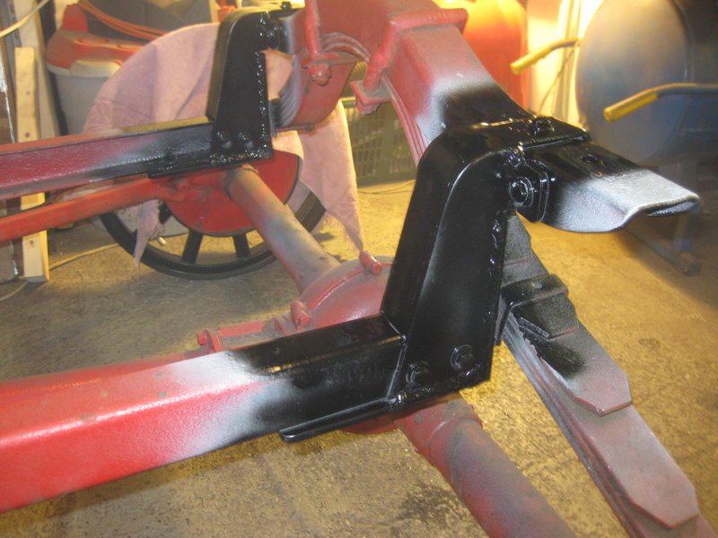

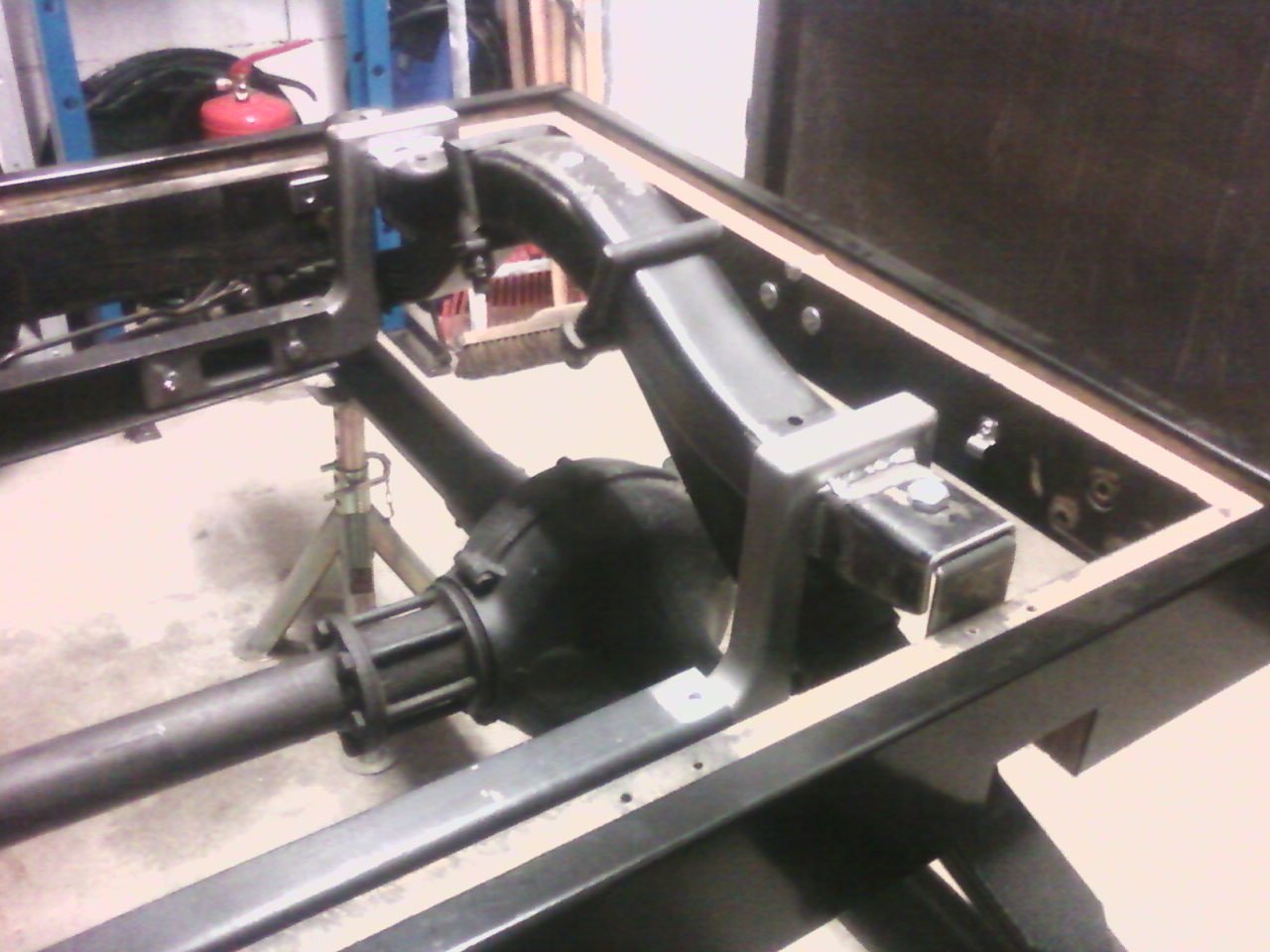

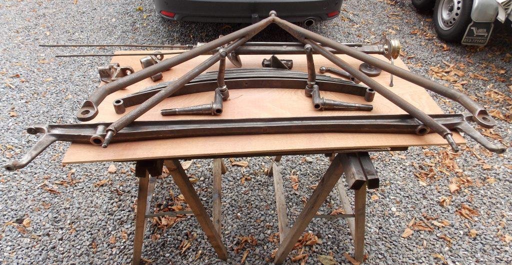

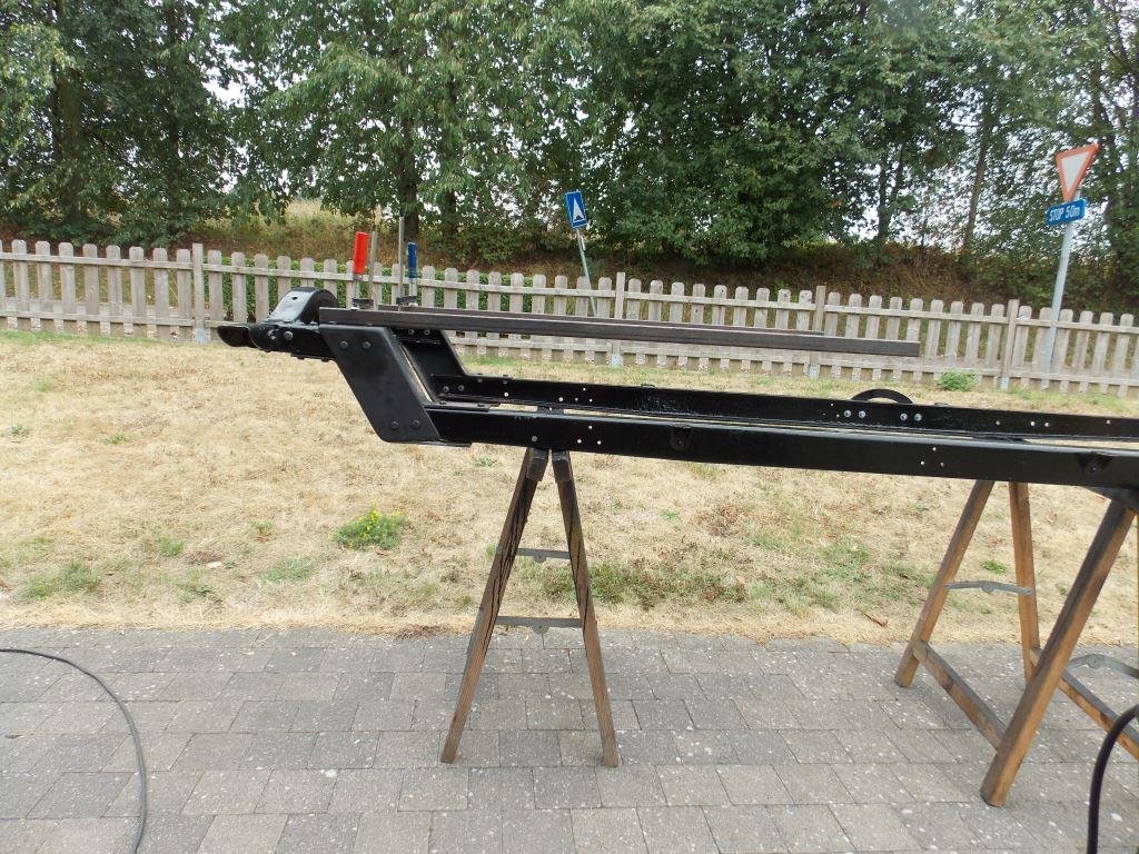

Two year ago I rebuild a 1920 frame from a speedster.
The change was 5" .
The original frame was rusted so far that it needed a replacement.
The rear is done as the old one . For the front I used parts I found 5 or 6 years ago on Ebay.
Good luck
Andre
Belgium
rear part of the frame
Brackets
Brackets
Watch the spindles
Watch the spindles

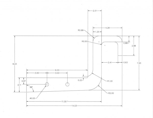

Post by henryford2 » Wed May 13, 2020 11:22 am

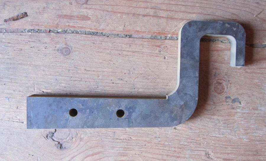

This may help, this is the drawing for the brackets pictured. It's a 5" drop, anymore than that you're skating on thin ice. Enjoy
BillyBobsSpeedShop
Posts: 59
Joined: Fri Jan 18, 2019 11:29 pm
First Name: Bill
Last Name: Webb
* REQUIRED* Type and Year of Model Ts owned: 1926 Roadster, 1927 Roadster
Location: Nc
Post by BillyBobsSpeedShop » Wed May 13, 2020 11:25 am
Thank you perfect!!

Don't EVER box just a portion of a frame rail!!! A lot of people think that is necessary, but while that indeed creates a very strong joint, it also creates a box tube that will not flex while the rest of the frame will. That will cause cracks in the frame at the end of the boxed section in the frame flanges and it will be worse than if it wasn't boxed at all. Welding frames isn't rocket science, as a lot of people think. Most frames aren't much more than mild steel, until you get into semi truck stuff, which are high tensile steel. That isn't a problem either if you use the correct welding rod. Just a SMALL reinforcement on the inside of the joint on the bottom flange or the inside of the rail (so called "fishplate", which shouldn't be any thicker than the frame itself, if that thick) is all that is needed, and that is only if you don't get a 100% weld joint. In the last 40+ years I have seen all kinds of "NECESSARY" reinforced weld joints that either failed or were about to. JMHO Dave

Post by dmdeaton » Thu May 14, 2020 1:34 pm
Hanks brackets
