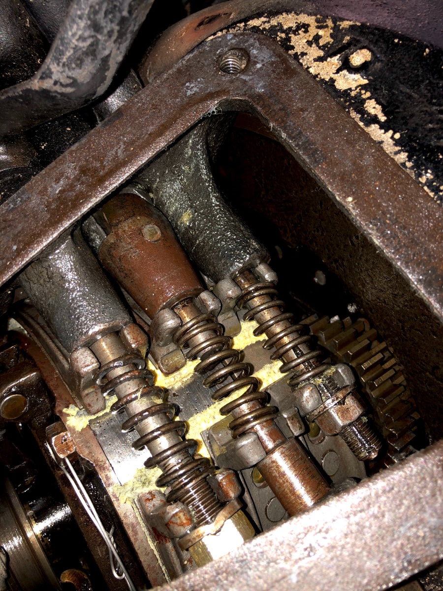

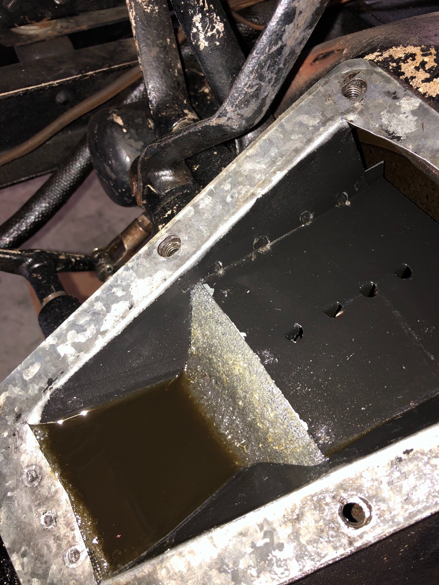

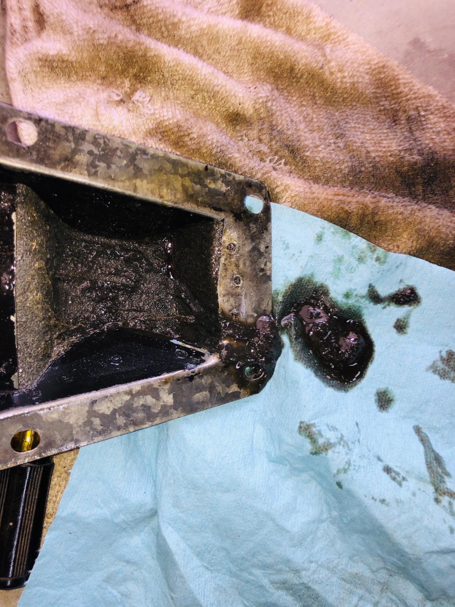

Here is the new to me 1925 Coupe, today I began the process of going over the chassis. Have run it about 3 miles or so.
Anyway, loosening the inspection cover on the hogshead, got a gusher of oil over the ball joint :(
The screen pocket was full to the brim, like a pond!
So, those screens can fill and hold back oil from flowing.
At least the guts of the tranny look nice, good drums, nice triple gears. The trans is very quiet in low and reverse, brake band was way too loose, may have been the culprit of the Kevlar fuzz, or maybe, since the Kevlar looks real nice, could have had Scandi lining prior that shred, don't know the back story on this T.

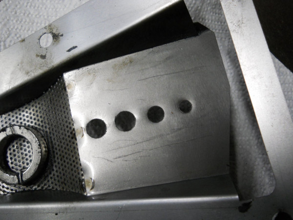

In the video above there is lots of oil flowing over the brake drum. If you watch carefully you will see oil dripping from the spring onto the drum, it just appears that the drum is not getting oil because it is being swept into the band lining but you can see it running out of the lining, and when the drum is stopped, plenty of oilcan be seen flowing over it.
In my experience, the screen assembly restricts oil flow to the drums. I have an old truck with a very tired and worn engine. It's a miracle that it even runs, but run it does, and I have put many, many miles on it. I have no idea how old the cotton bands are. I got a screen at one of our club meeting raffles, so I installed it in the truck. After a couple of tours I needed to adjust the low band. After a couple more tours I had to adjust it again, and then again! Now it was worn out! I relined it with a Scandi lining I had and had the same experience -constantly adjusting after a couple of tours. The Scandi wore out pretty quickly, and I didn't have another piece, so I found an old band with cotton lining and put it in and removed the screen. That band has been in there for several years now with very few adjustments needed.
Drilling the holes out may have fixed my issue, but so did removing the screen. I agree that it does collect a lot of junk, but in my case it was also causing some of that junk by causing premature lining wear.
