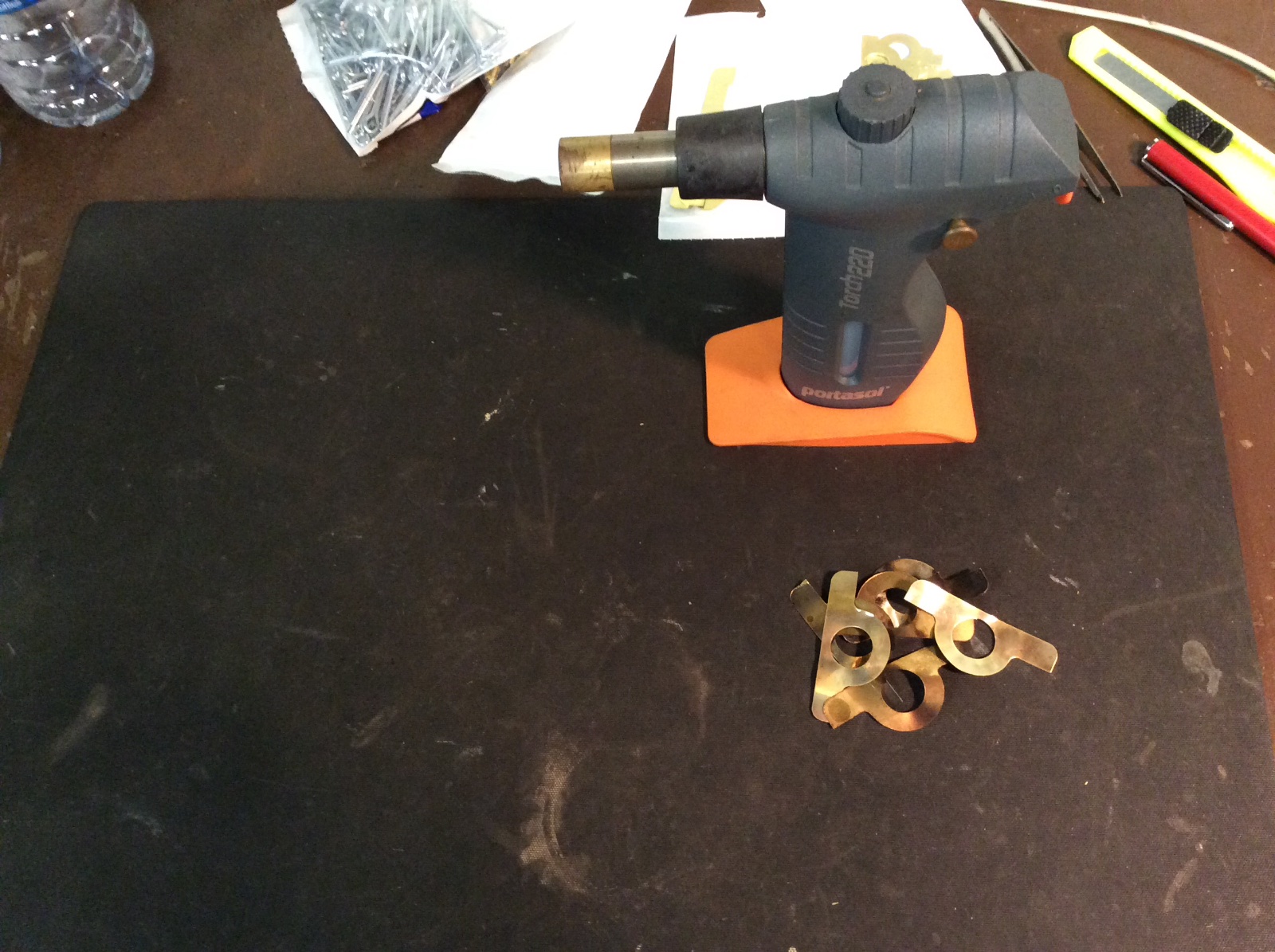

Is there a good way to separate shims ? I alway have difficulty pealing off the thinnest shim. Finger nail,sharp knife?

I've used a small Exacto hobby knife before AND a magnifying visor ! I seem to recall reading something about heating up one end to delaminate the adhesive ?

Heat a corner with a small lighter to soften the adhesive, then us a sharp blade. I use a utility knife because it has a good handle and supports the blade well, but a single edge razor blade or exacto knife work as well.

I do more than heat the corner. I hold a propane torch near the shim stack until the adhesive, (paraffin?), burns away. They all come part nicely then. You obviously don't want to melt them... ;)

A refinement on my suggestion above would be to put a tie wire through the hole and hold the shim over a stove flame, (which in retrospect, is what I actually did).

I don’t want the whole pack to come apart so I hold it with a pliers a ways from one end. Then hit the end with the torch.

I had good luck heating the shims with a micro torch. I held one end and heated just the outer layer all over. The outside layer would curl and loosen. They came off one at a time. The forum helps me once again.

Take your soldering gun, hold it on the pack until the top one slides off. Repeat as needed.
