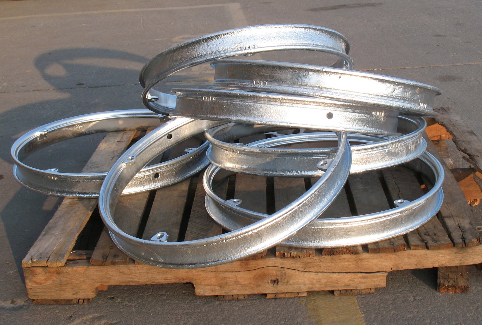

Another choice would be to go original and galvanize them. When I had mine done about seven years ago the minimum charge was about $235, so my seven rims came to about $33 each. Recently a bunch of T guys went together on galvanizing a batch of rims because the more you do the lower the cost per rim. I haven't heard how many they did and how the cost worked out. Maybe Ignacio or one of the other guys will see this and comment.

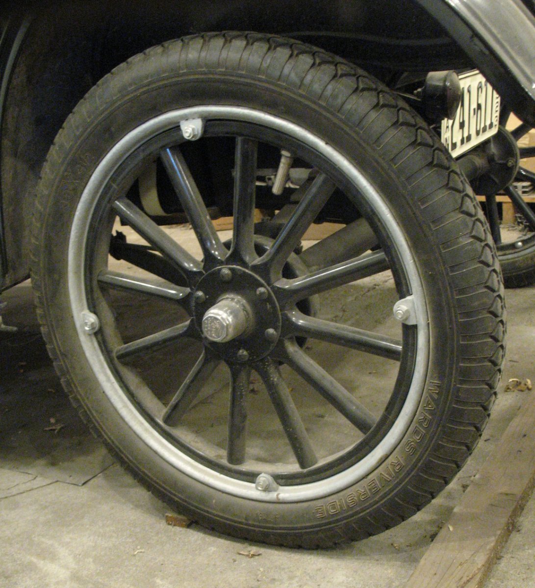

Re: 1921 Coupe Rims
Rich I was kinda thinking along that same line. But then, people use it all the time on lower pressure drop center rims. Galvanize, they have a more bite/texture to hold the tires. I was also thinking about paint, depending on what type, might also have a bit more grabbing power over powder coating. I do mine in cold galvanized spray paint. They end up with a more gray color. The ones I did about 10 years ago, have held up pretty well. Of course if you read the Ford info on wheels, it was suggested to use silver paint to touch up.

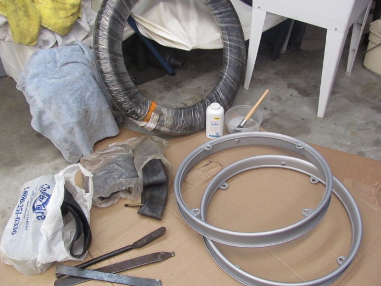

Re: 1921 Coupe Rims
I have used silver paint since 1964. I has held up well and easy to touch up. We had one summer of slipping rims and cut off valves stems. Changing brands and using flaps stopped that although I had not had trouble before that summer. I can't find silver paint I like as well as the old cheap stuff I used to use. Maybe I'm too set in my ways.

Re: 1921 Coupe Rims
Yes, galvanizing loses its new brilliant shine.This is seven years old. Of course, some of the dulling may be from dust.

Re: 1921 Coupe Rims
There is a difference in plating the rims. Steve's are hot dip galvanised. This is the most durable finish, but the rims need careful inspection before use to remove any little tits and burrs. I believe the factory finish was electro plated zinc. This is a smooth finish but it is less durable than galvanising. My plater charges me $7 each if I have 5 or more to be done. 'Silver frost' aluminised paint is the perfect match once they dull off after e few years.

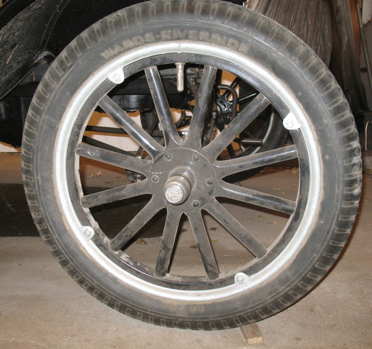

Re: 1921 Coupe Rims
I've clocked several thousand (& then some) on two of my T's with p.c. rims - no problem !
