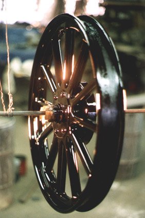

There are many paints out now, doen't know what they use in England. But wanted to comment on Concept. Concept has a blue-based black that really matches the Model T Black. Most blacks are more brown, this one is Blue, I think it's 4100, but I cannot find a can to read the numbers. These wheels are done with concept. It was a cool day when I painted them, so the flow out was incredible. I don't think I could do that now on purpose!
Painted wheel forum.jpg (32.14 KiB) Viewed 4253 times
T'ake care,
David Dewey

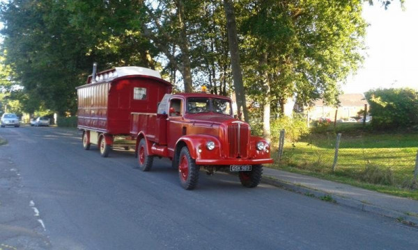

I have just received my paint from Craftmaster in the uk. They list Ford Model T black and the later colours. This is coach paint and can be applied by brush or spray. I have used it in the past. Please see the Morris Commercial and showman's wagon which were brush painted 10 years ago and still look good.
