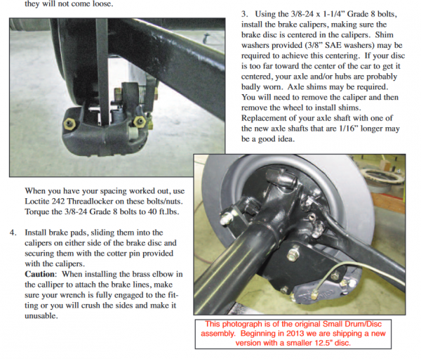

i believe i did something wrong . claipers are tight around disk and won't come loose.
I’m assuming you bled the brakes, and now the brakes are locked up? If so, check that your master cylinder is releasing completely. If your push rod is too long the piston can’t retract to expose the compensation port, which allows the hydraulic circuit pressure to equalize and so release the pistons
Or... if your kit is old enough and wasn’t stored properly, the pistons could be sticking in the calipers. There is a great deal of hydraulic force available to apply the pistons... yet only the elasticity of an o ring to pull it back. A small amount of corrosion in the caliper bores could easily go unnoticed and cause much heartburn

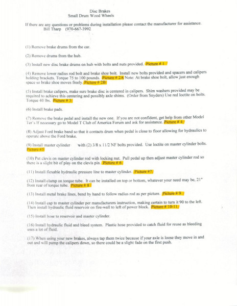

I bought and install a small drum disk brake kit built by Bill Tharp. I have the original documentation that Bill Tharp sent me. The disc kit was a mod of WILWOOD Disc Brakes. If you need information on the hydraulic disc piston contact a TEC at WILWOOD Disc Brake. I contact them when I need a little more support. Bill was a nice man and was also very helpful. I have additional information plus pictures on how to install the kit and it might be helpful.
Art Taylor (sportbingo)

As it seems to be installed there have been some post with suggestions of why it might be locking up, as were some suggested in the link I posted.
Did you try cracking the valves on the cylinders to release the pressure?
Did you bench bleed the master cylinder before installing it? Top of page 7 small drum wood wheels.

The Colorado Mountain Disc Brake instructions and photos for small drum for wood spoke wheels (20 pages) are in the mail to you. Best of luck.
