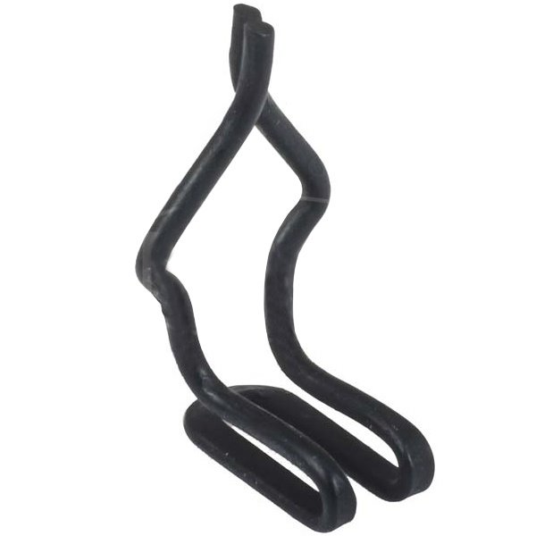

The clips I use are spring clips that slip into a 1/4" or so hole in the cardboard backing of the door panel. The head of the clip is low profile and with the door padding you can not tell its there. The clip can be installed or removed from the cardboard without having to pull back the upholstery material, and the spring snaps into the hole in the body or door where the original metal socket went. The clip can be added to the door panel at any time so it can be off to sew, glue, or package to ship and then installed at a later time. Spring clip allows the door panel to be installed or removed easily, multiple times. I will try to attach a picture from a vendors catalog.

Humble those can work they are used on my model a
