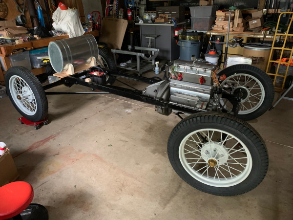

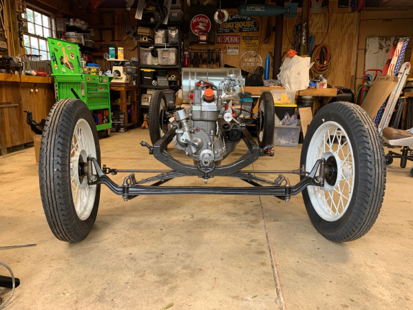

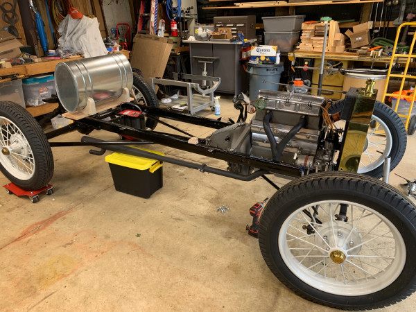

My cheap old speedster project so far. Someone in Tennessee has been prodding me with a long stick and giving me these goofy ideas.

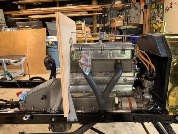

Topic author - Posts: 732
- First Name: Danny
- Last Name: Deaton
Re: Speedster project
New header and megaphone pipe

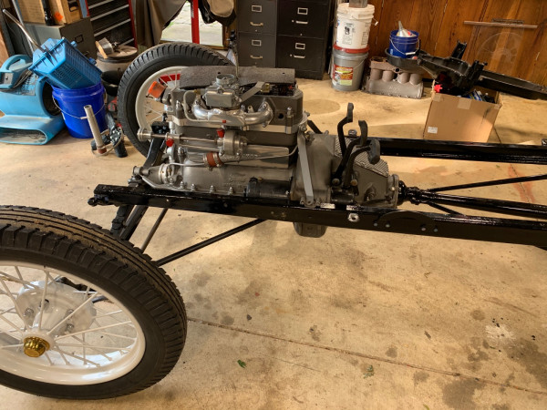

- Posts: 4082
I like the 26/27 style motor braces going up to the cylinder head riser plate. Are the steel rods, running under the pan arms, a repair or a reinforcement?
- Posts: 5474
- First Name: Henry
- Last Name: Lee
Shane the paint is from Snyder’s cast iron, good stuff!
Jerry those are 3/8” steel rods I form in the pressed relieves for support, works excellent!
Hank
Hank
I like the additional reinforcement in that beautiful power plant as Jerry V. has pointed out. Your engine is a real "study" in additional reinforcements obviously needed, due to the added power, and I had a thought about a possible addition that might make sense:
As we know, "Henry Ford" even recognized the fact the entire engine/transmission/hogshead assembly, bolted to a common stamped metal one-piece pan, needed additional "stiffening" and as such, one of his additions to the "new improved" '26-'27 Model T was to bolt the top of the hogshead to the back of the engine block, so as to make the entire engine/transmission/hogshead assembly more ridged. My thought was that your engine (lacking the factory feature of bolting top of hogshead to engine block) a pair of strap iron braces could be fabricated to mount between the front (or top corner bolts) of the hogshead inspection access cover and the two bolts (or studs) on the back of your cylinder head riser plate. This would not be quite as ridged as the factory method of solidly bolting the top of the hogshead to the back of the engine block, but probably would go a long way toward stiffening up the whole engine/transmission assembly, which I would think would be even more important with this more powerful engine than the stock 20-hp engine. Again, just a thought,....harold
- Posts: 5474
- First Name: Henry
- Last Name: Lee
Harold this one as with other performance models I did also has heavy oil pan to hogs head/engine supports on the underside!
Thanks,
Hank
Thanks,
Hank
- Posts: 407
- First Name: Harold
- Last Name: Schwendeman
- Location: Seattle
Aaah,....so the crankcase is probably a casting instead of the factory stamping, right? Obviously, I didn't consider that!
- Posts: 5370
Nice start. But I am not sure about using the aluminum adapter plate to bolt the supports to.
- Posts: 5474
- First Name: Henry
- Last Name: Lee
Mark,
Adapter plates from 6061 structural alloys are very strong, especial when used with studs and not bolts.
Hank
Hank
- Posts: 5370
Hank I was hoping you would chime in, thanks for that information. Something for me to think about when I put the Chevrolet head back on.
- Posts: 5474
- First Name: Henry
- Last Name: Lee
Mark also using strap steel will allow more expanding and contracting while keeping the axis in plane. the studs are 7/16" with 9/16' holes.
Hope this Helps,
Hank
Hope this Helps,
Hank
- Posts: 5370
Thank you, yes.

Starting to mock up some sort of firewall
