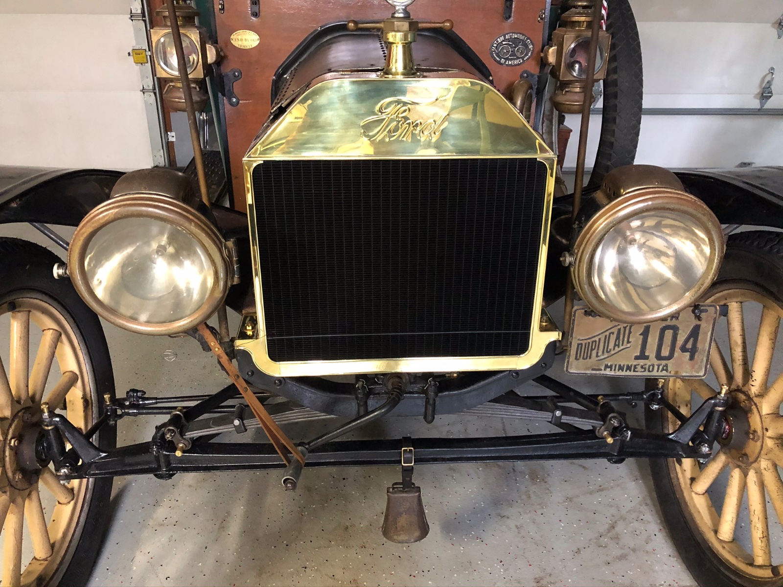

I’m with Steve J on this.....Rustoleum satin black with a brush is easy to use, durable and touch up blends in nicely.

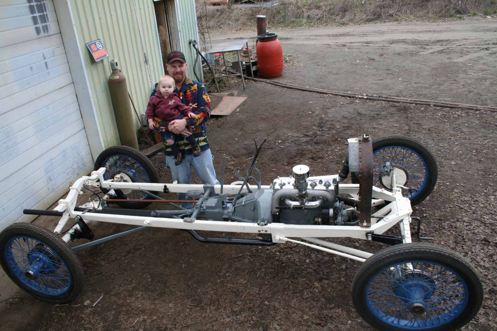

Okay, so many choices in black. So I am wanting to do a Speedster in white. What about that?
Topic author - Posts: 1219
- First Name: Adrian
- Last Name: Whiteman
Re: Chassis Paint Recommendation Request
Well, it just so happens POR15 is now available in a range of colours - including white.
One thing that 'hesitated' me with light colour is keeping the T lubed. That means oil will seep out and cover that nice white chassis and axle....
If you are a 'dab hand' with a rag on a regular basis it may well not worry you
