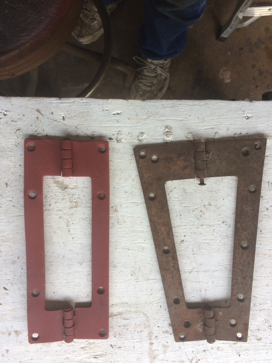

A friend of mine needs to replace a 24 roadster door hinge rib or pillar. I have Mel Miller’s wood blueprints for a 14-21 roadster. What, if anything, is common or appropriate for his roadster and my wood plans ? I know the hinge is different. Thanks all !!

No, John prior to the ‘24 Model year the open car hinges appeared-when opened- as a triangle with a flat top. But thanks for the input. I’ll post a picture.

The early to body style 1923 is the one on the right (upside down) . The 24-25 is represented by the pic on the left .

If that’s the case, where do all these rectangular (red oxide primer in my pic above) fit in ? The New and Improved open car hinges are totally different. Other than me; who else has seen an unmolested ‘24 touring or roadster with a hinge as I stated above ? That rectangular hinge isn’t a 1 Year only design.

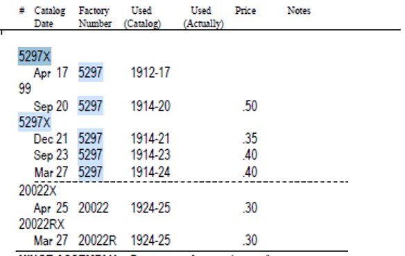

Note the price list of parts was mentioned above but it does not always answer the question in a nice clean manner. For Mark -- from Bruce's Encyclopedia he has:
And from that -- I don't have time to figure out why they list the same door hinge for 1912-1917 in the 1917 price list of parts. Perhaps Bruce made a type-o? Or perhaps they used the same factory number for the part and figured the owner would list the year of the car and they could then supply the correct hinge?
But the Sep 1920 price list of parts has factory number 5297 fitting 1914-1920.
The Dec 1921 price list of parts has it fitting 1914-1921 (again if they were using "model year it could have said 1922 -- but that is a different question)
The Sep 1923 price list of parts has it fitting 1914-1923.
The Mar 1927 price list of parts has it fitting 1914-1924 [NOT 1925]
Note in the Apr 1925 price list of parts a NEW FACTORY number 20022 in used and is listed as fitting 1924-1925.
The Mar 1927 price list of parts has that same Factory number 20022R (R for replacement) and still listed 1924-1925.
Note the MTFCI (International) Judging Guidelines 7th Edition list the equal length door hinges for the 1925 and not the 1924 year cars.
I suspect that in Aug 1925 there were some cars produced with the older style hinge and some produced with the newer style hinge. And the ones with the older style would be looked at as 1924 models and the ones with the later style hinge would be considered 1925 models using that judging guideline.
I do not know how long that overlap lasted.
Not requested -- but some advice offered for free and maybe not worth that much. If your friend is restoring the car for Stynoski competition, and it is an early 1924 car (i.e. before Aug 1924 etc. I would recommend the 1914-1924 style hinges unless he has documentation supporting the equal length hinges that early. Note there may be a Factory Drawing for Factory Number 20022 at the Benson Ford Archives. If so, it may have the original date the part was drawn up. And normally the parts are NOT produced before the Factory Drawing is made telling the folks the dimensions etc. of how to make the part.
If they are working towards a good driving T -- either hinge will work with car and door.

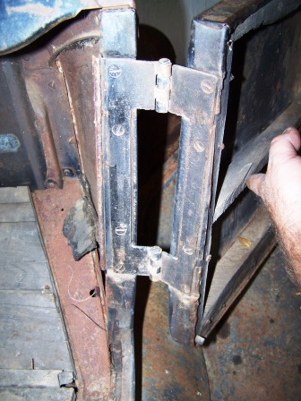

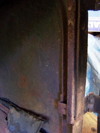

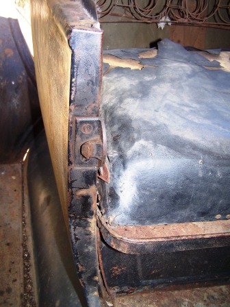

I don't know if you have a '24 or a '25 YEAR MODEL car, but here is what the hinge and pillar look like on a 1925 year model runabout. Note that although the door is still wood-framed, as is the latching pillar, the hinge pillar is all metal.
Note that the '25 YEAR MODEL door latch pillar part has only two screws holding it in place.

Many thanks Hap - and you too David. As usual, I learn many tidbits of useful information from your research and diligence at correctitude (new word). So. The rectangular appearing hinge IS a 1 Year part,huh? And I didn’t know ol’ Henry didn’t like to use ‘Model years’ in discussion. I’ve been in that ‘model year’ habit for years. So much so that I just spent 2 days tearing down a 1919 engine for rebuild as a spare for my ‘19 center door only to realize the casting date is
11 7 19. That’s a ‘20 MODEL YEAR so I won’t use it. Thanks again to all !!
