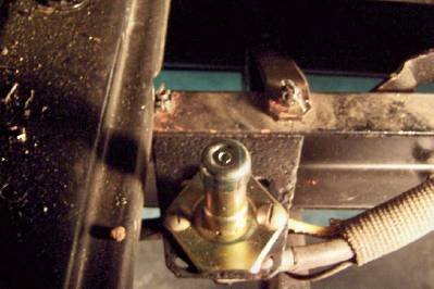

Post by TRDxB2 » Sat May 16, 2020 2:03 pm

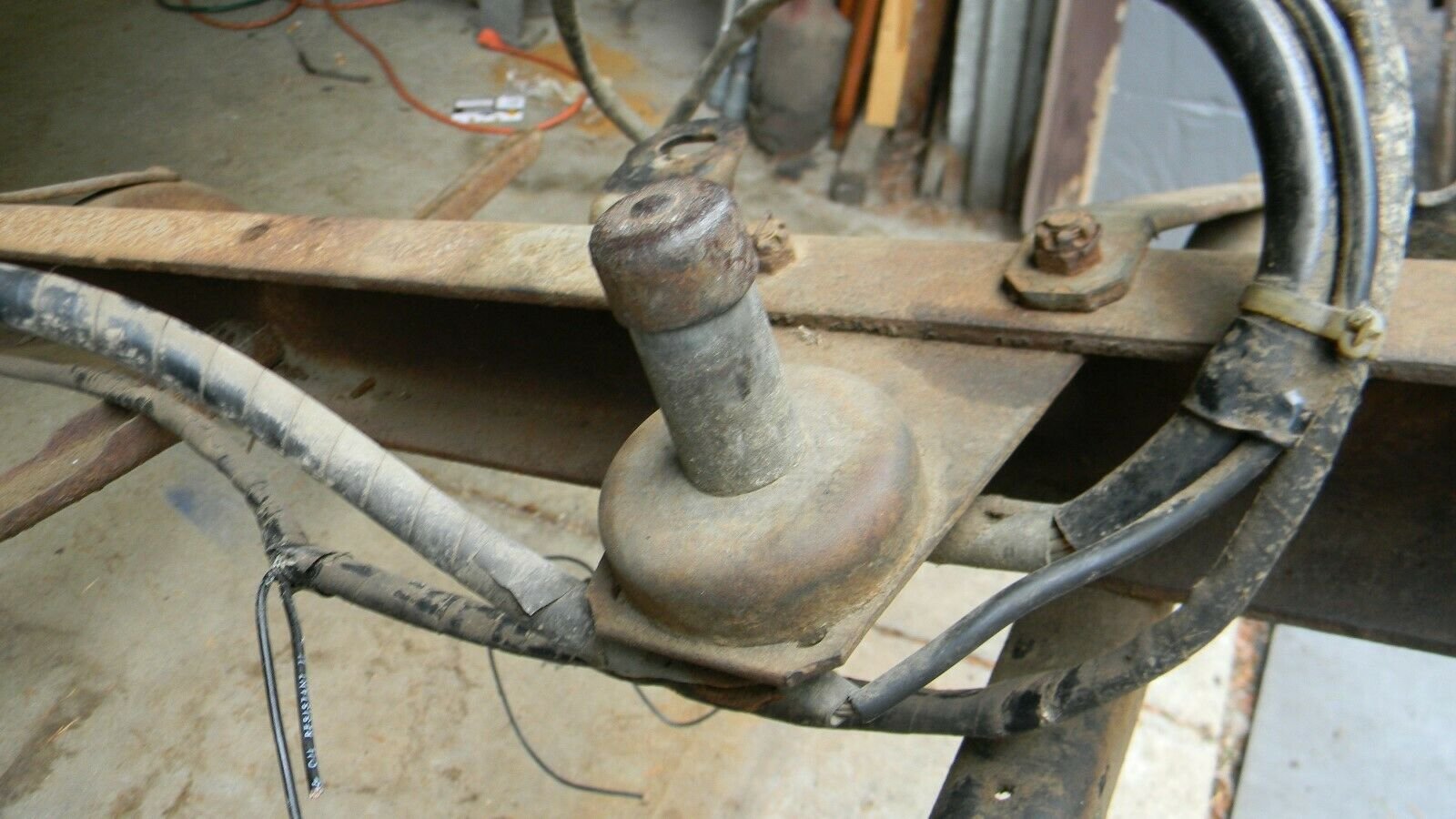

Post by Scott_Conger » Sat May 16, 2020 2:21 pm
Ben
I was going to measure one but not sure when I'd get back from barn.
this might be good enough for you:
