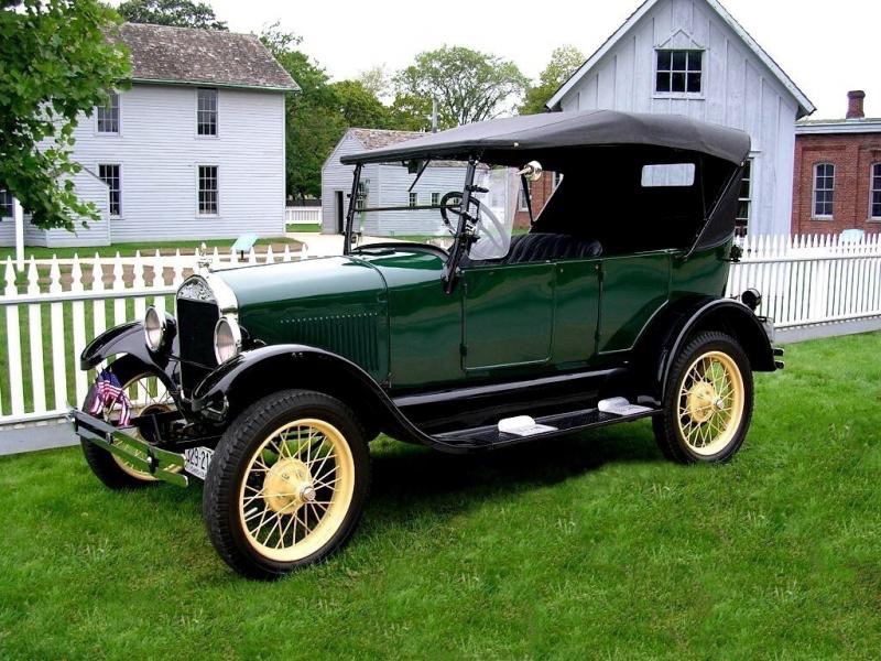

The 15 millionth car on display at Greenfield Village has the extended fan hub as referenced in an article some to be ago in the magazines. I also had an up close look at the car with a representative from the museum a year ago. They don’t know anything much about the car, so I’m asking you.
My question is actually two questions.
1. Is that the original radiator? If so, why on such a late car did it have the late 26 experimental 3 row radiator and extended fan hub.
2. If it’s not the original (I doubt it has been replaced) what should be on it? I know they were using flat and round tube in 27 from what I’ve read. I know with all things in production there is never and exact date of a changeover.
My car (being Re-restored right now) is a late 27. It is 15,000,524, so it should be consistent with that car. Engine and chassis match. It had the longer fan hub when I got it but it had cooling problems so I put a new flat tube and short fan hub. But, if this was actually correct, was Ford using both types of radiators in 27? My car is a touring just like the 15 millionth. Perhaps one on lighter cars and a different one on heavier cars?
What should be on my car. I’m building this car to be correct and not to drive much. I just want it correct in all aspects as far as the way it was built.It’s just fun to make it correct. I have another T to drive. This one is my pet project.
Any help would be appreciated!

I remember looking the car over very carefully many years ago when it was on display still. Probably 20-25 years ago now. My thoughts at the time was the car was really NOT one to refer to for correctness. Because of so long ago, I don’t think it’s worth trying to remember anything in particular. I had a very original late 27 roadster at the time.

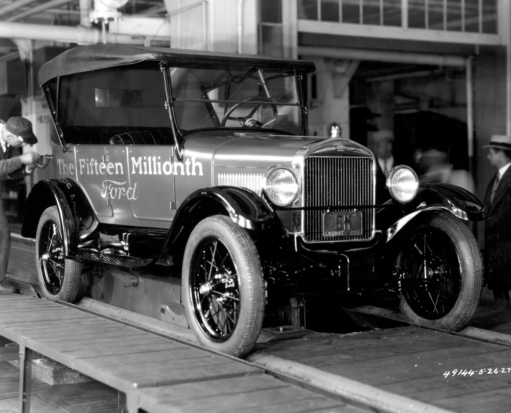

My '27, serial number 14,832,783 had a round-tube radiator. It now has a flat-tube radiator that actually cools it well. It is also nearly the twin of the 15,000,000th T.

The close-ups of the 15th millionth show round tube radiator.

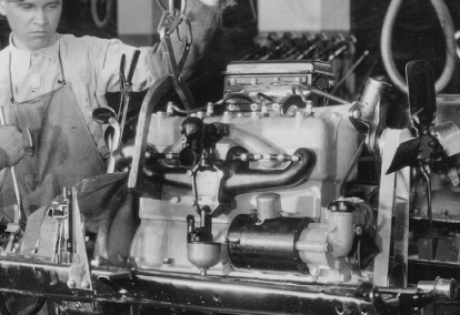

And this close-up of the 15th millionth chassis going down the line, clearly shows the longer fan hub, so that confirms the T got the thin radiator. Must have been ok to do, as that T did long distance from Dearborn to out west and back, visiting dealers and making crowds form, all paying their respects to the end of the T dynasty. :(
15th mil engine close .jpg (54.14 KiB) Viewed 6753 times

On the engine photo, what an I looking at ? what looks like a flat piece of steel running from the back of the fan hub bolt down to or behind the oil cap.

The timer wiring
