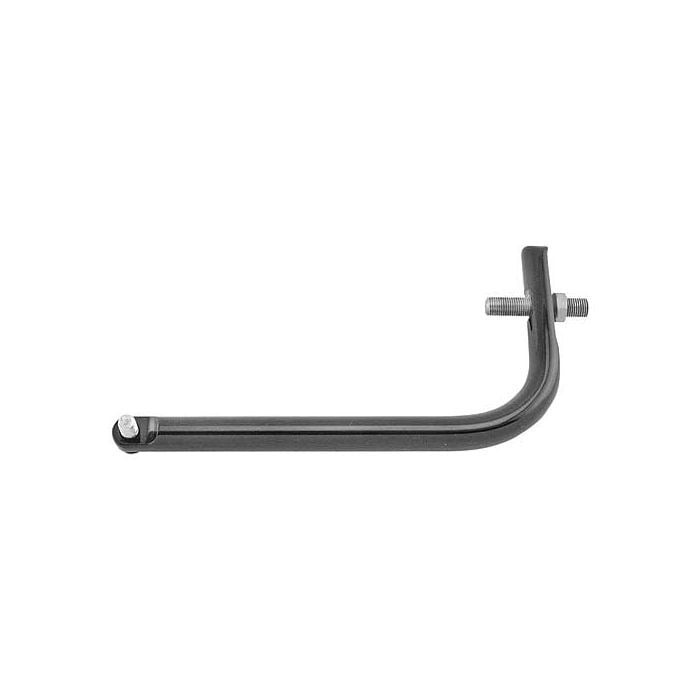

Would anyone have the installation instructions for side view mirror sold by our vendors with a solid 8-in mounting bar and a 5-in round mirror. There was advertised a download for instructions but the vendors having problems. Spoke to vendors office but have not received any information or download. Not sure if mirror bracket for 26-27 open car gets installed on upper or lower windshield studs.

Haven't used that type, but appears the new longer wingnut stud replaces the factory stud inside the cone of the windshield frames.
IMO, at the upper frame wing nut, the arm would be rather close to the top front bow. Seems mid way a the lower frame would be ok, but its your choice, the higher spot may be better. Just sit in the T and hold it in either position to see what the view is behind you.

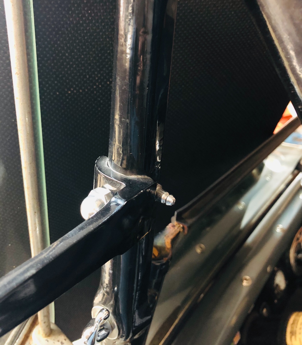

The lower location works for me on the '27, but this is Antique Motor Sports's mirror, however it is installed with a drilled hole in the stanchion, so I used the lower position near the curtain Lift- the- Dot stud. That put the mirror head at my easy eye level.
Cut off part of the hex-head on a bolt to sit deep in the channel, that's covered with the weather strip in the channel. Capped the bolt with a stainless dome nut. I like this type mount, even if a hole is made, as the arm is always fixed securely to the stanchion, minimum wiggle.

To those who have purchased this side view mirror assembly... Have you had problems with the included threaded windshield attachment not fitting through the hole that's in the side view mirror bracket?
