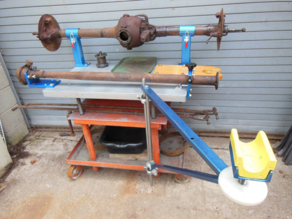

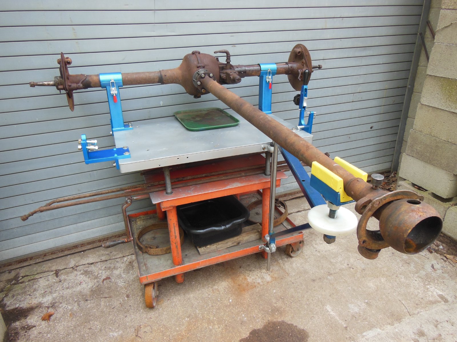

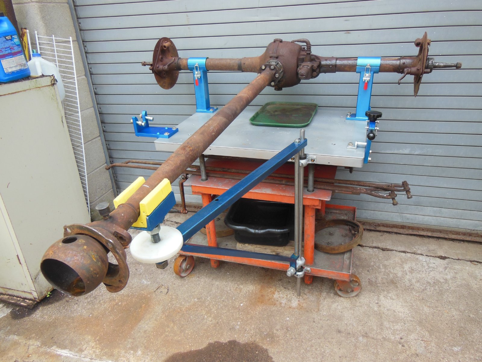

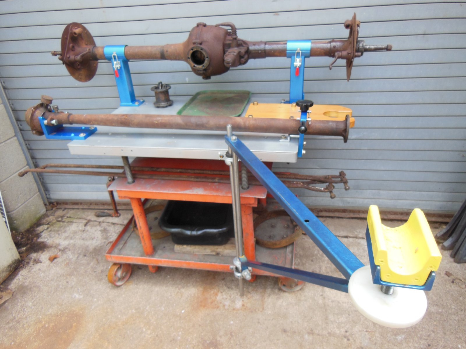

As I get older I need to make It easier to work on Model T axles. I have used the orange cart for many projects over the last 50+ years. The blue parts are newly made to hold Model T rear axles.

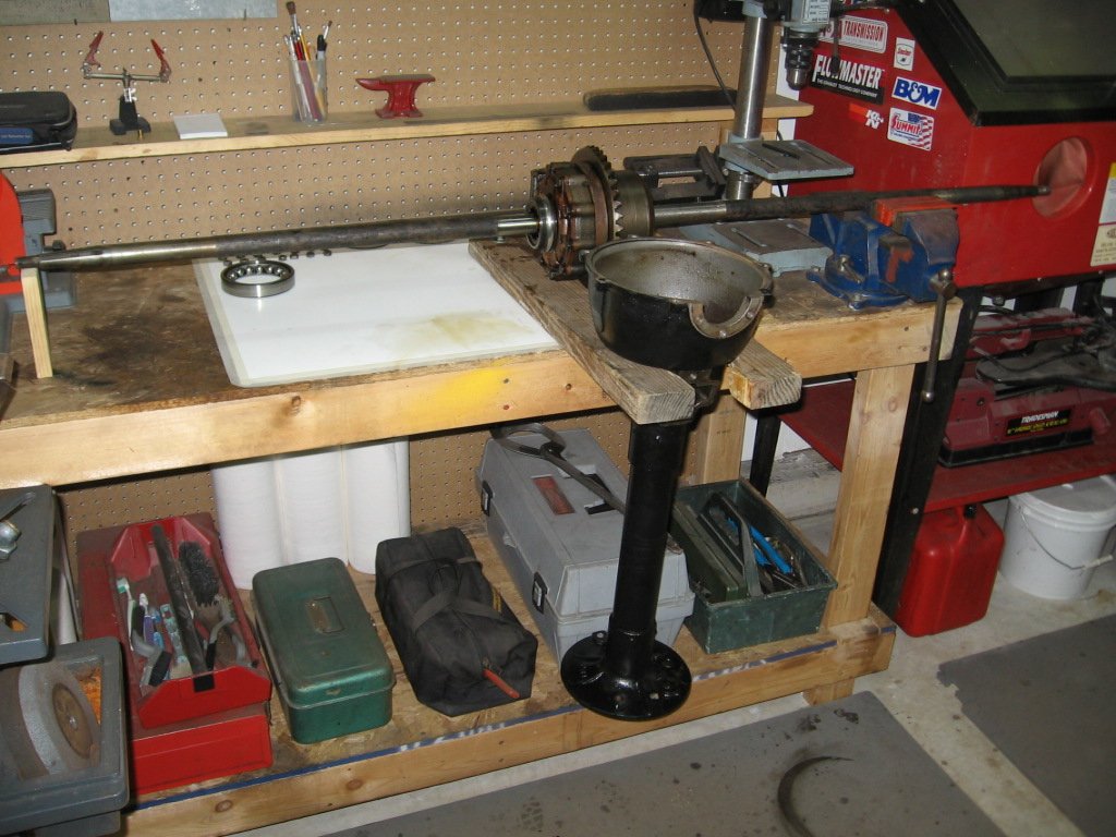

Great setup! Sure beats the trash can that I used to support my driveshaft housing. I did cut a hole in a 2x10 and bolted it to my workbench to support the axle housing. :)

Will you be able to install the radius rods with the driveshaft already bolted to the housing?
Posts: 5600
Re: I need to make It easier to work on Model T axles
Post by RajoRacer » Wed May 20, 2020 8:00 pm
Small drum - Yes - large drum - No.

Mark, I took the drive shaft tube and radios rods off as usual but re installed the tube to show that the swinging arm works for both horizontal and In the vertical position.
Thank you for all the kind words. I made It to save whats left of my knees and back.
If anyone would like to make there own setup I can supply any or all the blue parts.
