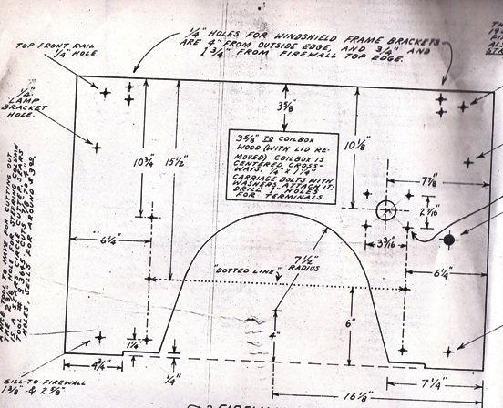

Here is some information I found. Someone can weigh in on the diagram for the 1913 differences compared to a 1909-10 relative to the steering column holes

Re: 1909 firewall drawing
Very little related to this 1913 dash drawing is accurate for 1909. Most notable discrepancies are the steering hole location, steering mounting holes, and body to frame brackets.

Thank you for the great drawing. All I need is the measurements from the top of the firewall to the center of the steering column hole similar to the way it's shown on the 1913 drawing. If someone with an original 09 firewall could give me that, I will be good to go. What I have as a pattern seems to be a repo and the steering column location doesn't seem correct. I just wanted to double check before I started cutting the mahogany plywood. That stuff is expensive!

Thank you so much for the information John,
that's just what I needed. My pattern has the cutout hole for the column at 11 1/2" from the bottom so it is 9/16" to low. Now I can proceed with the project. And thank you for the file to fit info, I was planning on drilling it on my Bridgeport with an angled setup.. I only wish now I could find mahogany plywood with a thicker veneer!
Have a great day! Mike

That drawing above is not accurate at all for a 1913. Pay no attention to it!
