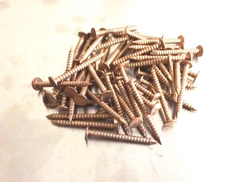

When I restored our 1924 Fordor thirty years ago I had the same dilemma. I removed all of the old nails and used bronze monel nails. I countersunk the nails so there was supplicant depth to allow me to fill the alunimum cover strips with alunimum " DEVCON " filler. The fix has lasted all these years and not one has popped.
Best regards, John Page Australia.
